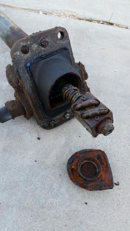

Mostly my fault I guess, only had the tractor less than 3 years and the oil ran out of the steering box, then it got water in it, the water froze and blew out the bottom of the steering box.
So check your steering box oil, if it won't hold oil pump it full of grease. If your tractor is out side invent something to keep water from running down the steering wheel shaft.
Luckily when it failed the only damage was limited only to the steering gear box and to my wallet.
Suddenly losing steering on your tractor is a good way to get a flipped over tractor.
Pics to follow shortly.

Dang thats crazy, for my l175 when I fill that side bolt it always goes down when filled with oil.... so then grease is the way to go instead? Or should I look into tearing it open instead?

Grease might be the way to go. Those seals dont appear to be replaceable.
I'm going to fill my new steering box with 85-140 gear oil until it leaks out.
Also make sure the oil isn't running out the bell housing. If it does you have a crack and will need a new steering box, they're only $300 to $400.
