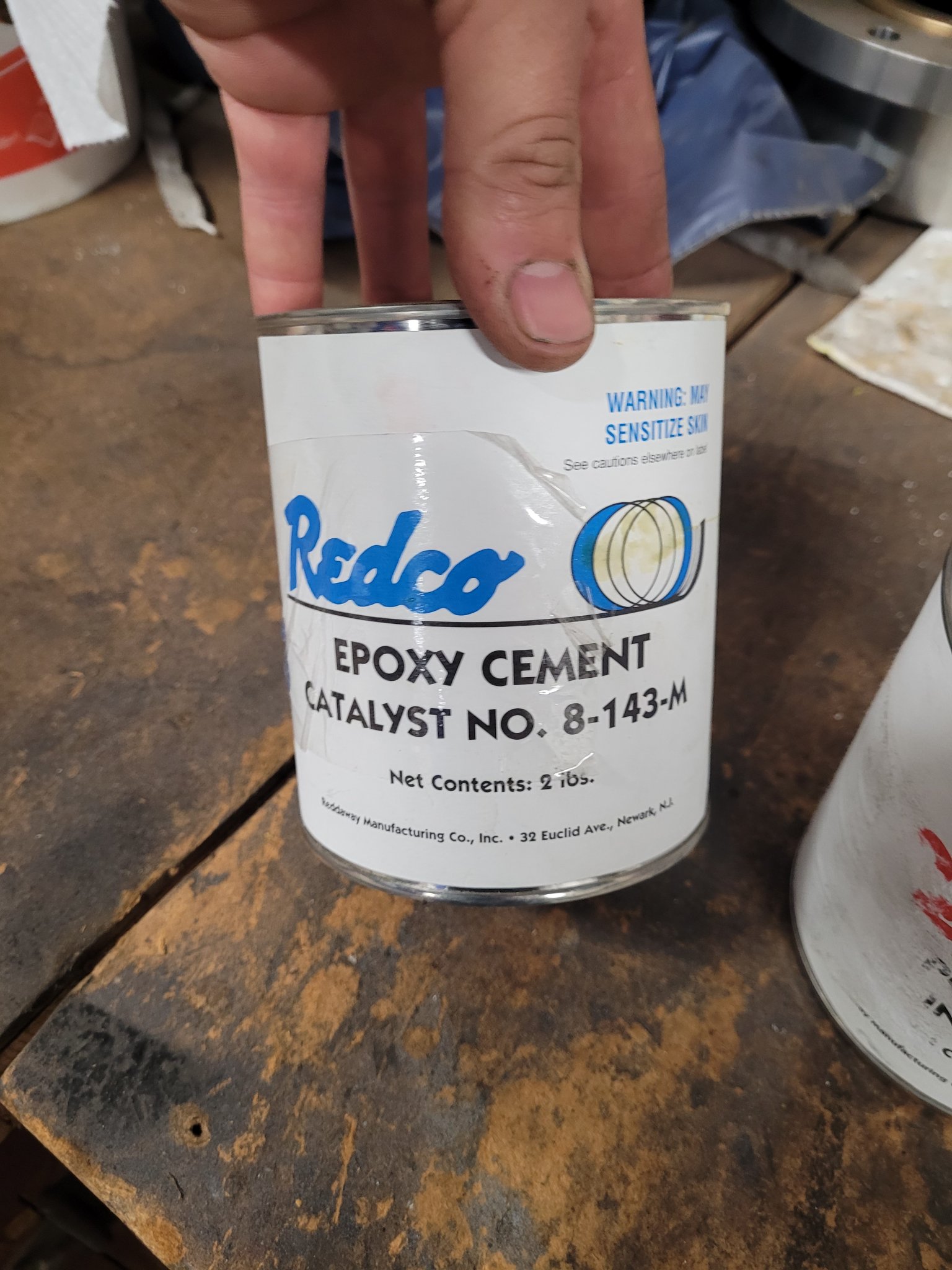

Good afternoon, I got to speak with Tom today and snapped pics of the epoxy he used. I don't have much to add to what I said before save for the press. He said it needs uniform pressure applied to it to help with the bonding process, he said the press was just the easiest thing we have here to use. He runs 100psi on the Guage of a 12 ton press, it's spread out over roughly 26". He said the prep work and cleanliness is the most important part, he didn't have a comment on how he thought it would work for drum brakes, but did impart the sentiment that these brakes stop a lot of weight moving pretty quickly in a short distance every 5 minutes or so. Here's the pictures of the epoxy.
