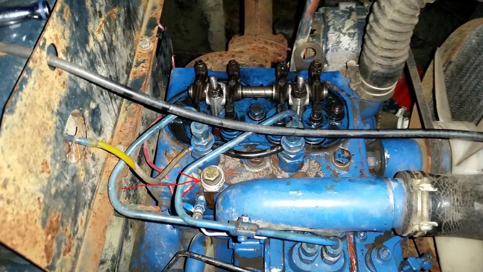

I recently purchased an L1501DT that would not crank. It has low compression. I'm thinking its a blown head gasket. There's oil in the radiator and a head bolt has been replaced that is not the right size. My question is when I pull the head is there a way to check the rings without pulling the pistons. It was supposedly rebuilt in 2010 and only ran about 10 hrs since.

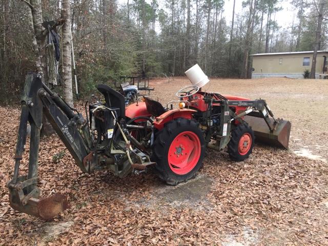

Thanks for the help guys. I just realized this must be an L1801dt. I have another tractor. It's an L1500 and I was comparing motors. The new one has Z851 stamped on the injector pump. I'm I asuuming correctly? Also, how much different are the Z750 and Z851 motors as I've already ordered a head gasket for the Z750 that I thought it had.

i think that it is ok, clean everything and change the head gasket, if you have a machine shop near you you can sent the head for a surface clean, it will mill some mmm.

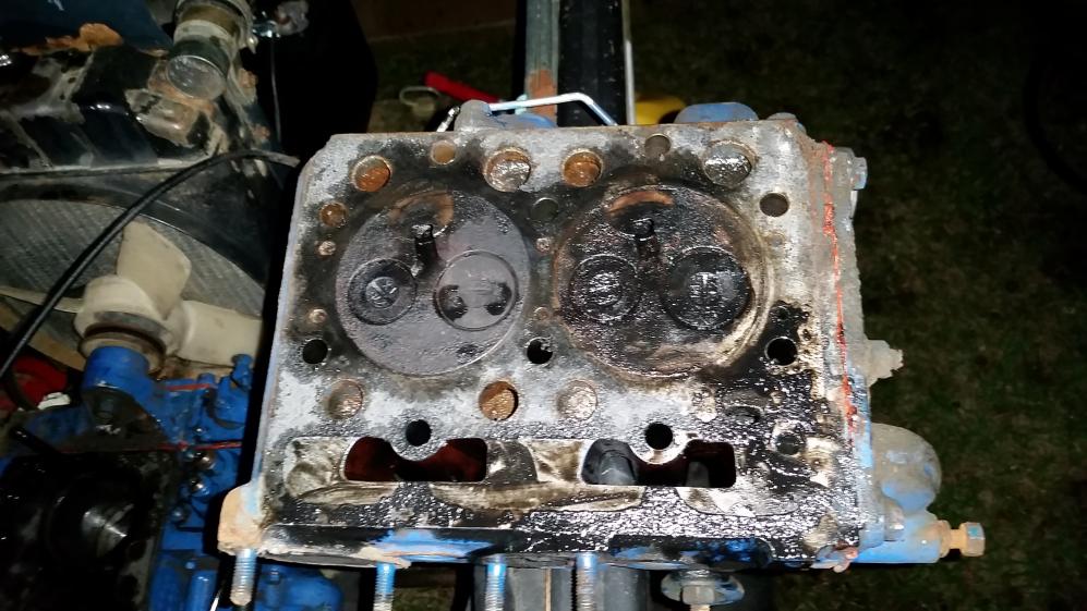

I had a chance to take the head off last night. Is it normal for a diesel to have this much carbon build up?
Depends on how many hours are on it, and how it was used in its past life. Generally dirty engines like that come from short periods of running, not getting it up to operating temperature, or stopping it with the decomp knob...:D
