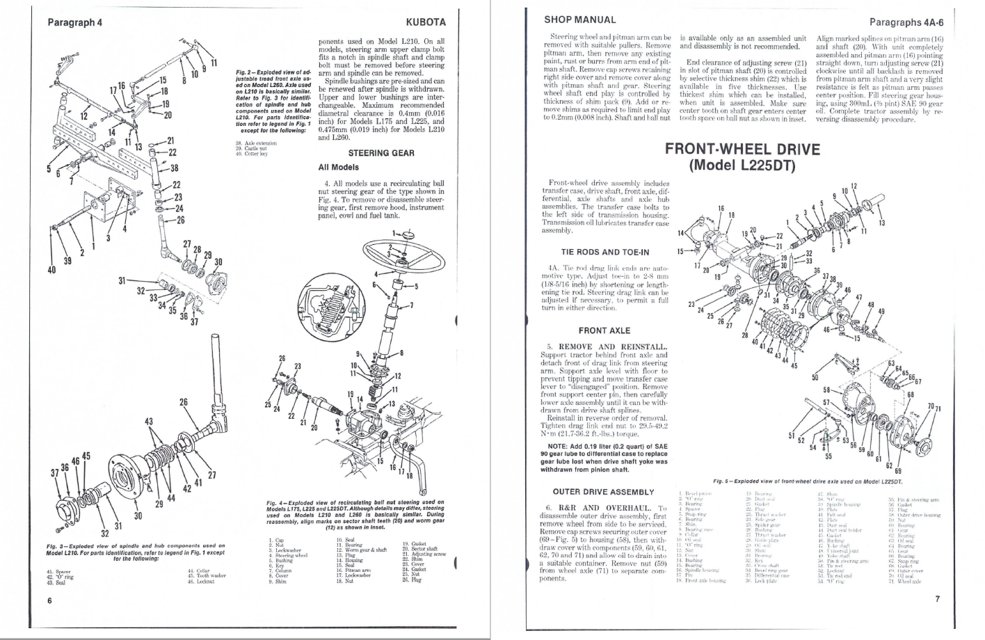

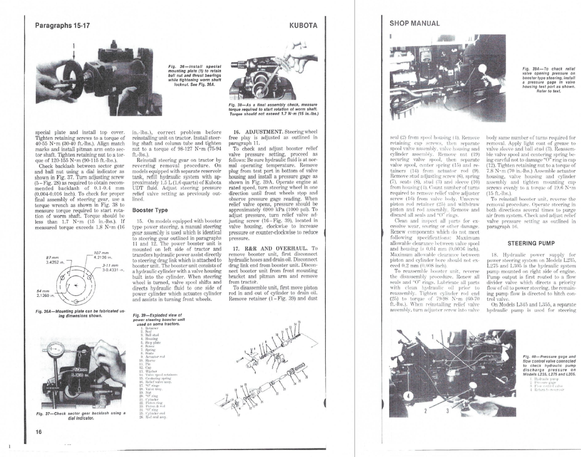

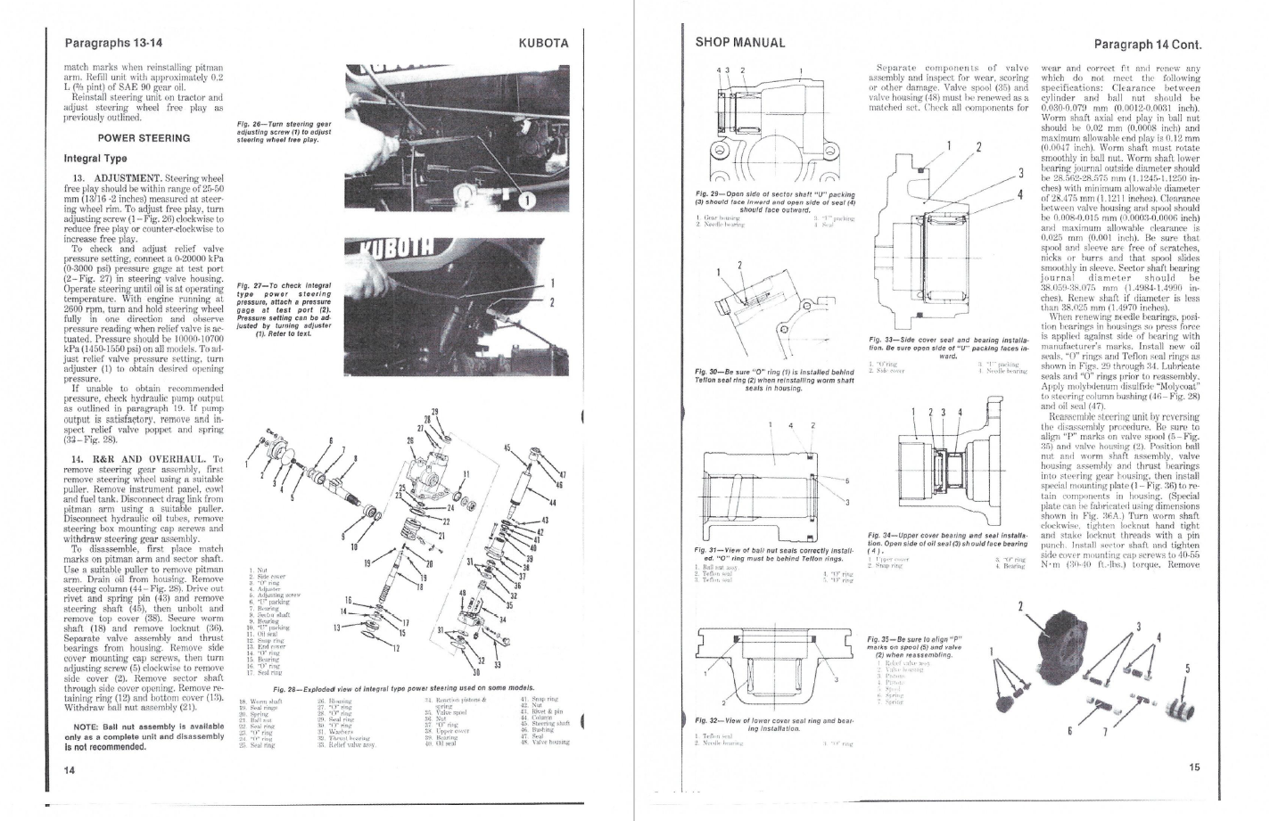

billrigsby Well-known member Equipment L1500DT Too many implements, or is there such a thing? Mar 17, 2015 1,050 247 63 Florissant CO USA 8213' www.facebook.com Jun 16, 2021 #2 Been a LONG time, but is not the top just a bushing? Maybe some of this will help....
