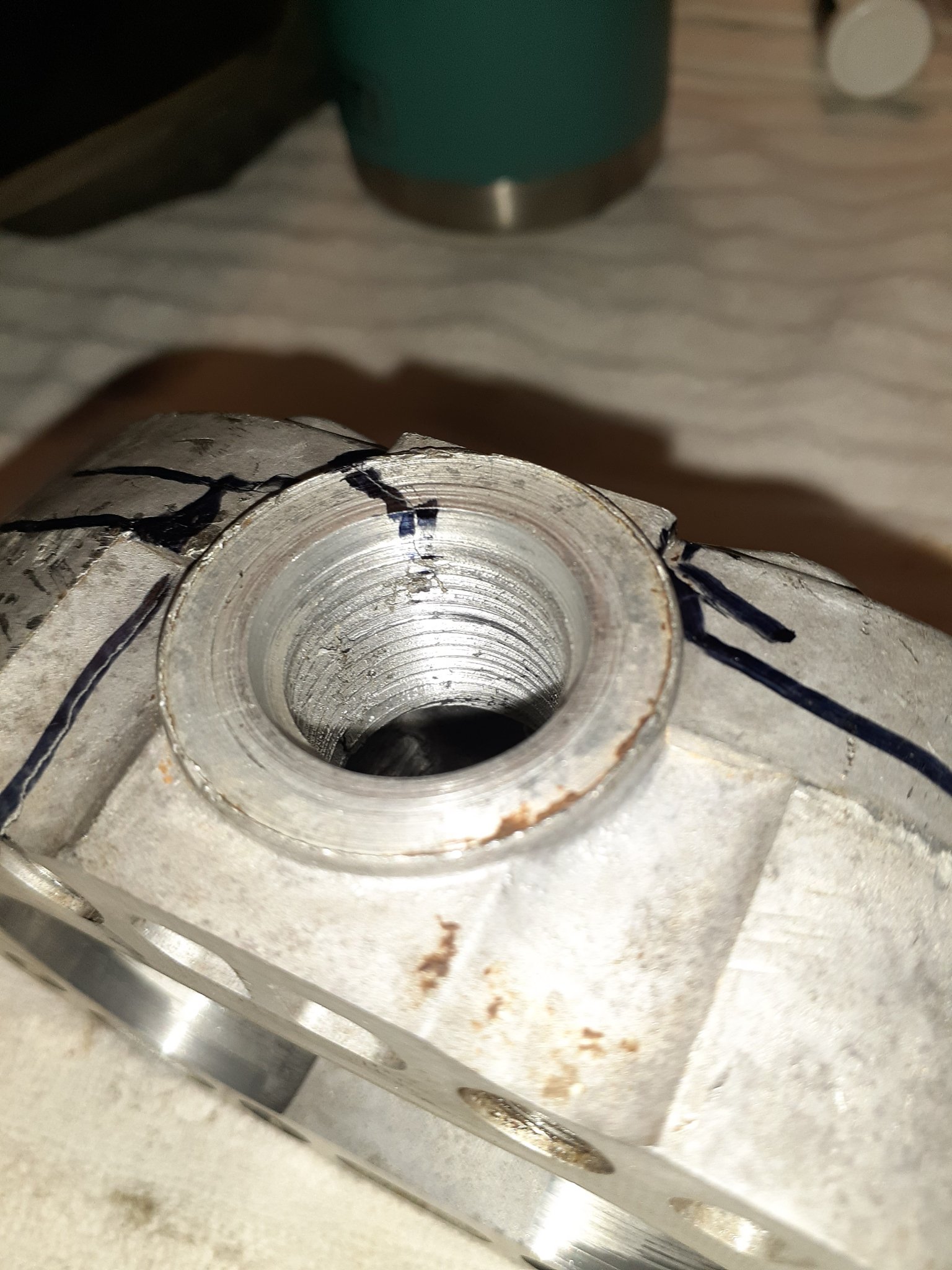

Hi Guys,
It seems like I fix one thing and something else goes out, after getting the clips in the transmission on and grinding the dog ears off the gears as needed, getting a new front tire, changing all the fluids and filters and putting a new bottom in the bucket, I put the old girl to work, when a hose on the front end loader blew out, after changing the two hoses on that cylinder another one went out, course they are all 43 years old so I replaced all the hoses to be safe.
Now the hydraulic pump case has developed a crack in it, not sure if it's just metal fatigue or I did it when tightening up on a fitting as it's where the hose connects that goes back to the controls. It's not a big wide crack but it's long, inside and outside as well. I'll include pictures as I got it off the tractor and took it apart after a good clean up, I hi-lighted the cracks with a black marker so they showed up better.
Take a look at the pictures and your thoughts on if it could be welded up or not, the crack on the inside bother me the most as the gears that spin around on the inside are tight against the sides of the case and it would be hard to grind the welds there for a good fit. I thought if it was clamped in a vise to close the crack up then welded on the outside maybe it would hold. The crack also goes into to where the fitting screws on as well.
I been looking on line for a replacement pump but not sure if they will work or not. This is a Webster pump and I figure it's not made now, plus the ones I seen on line are similar but have different connections as my fittings screwed directly into the pump and the new ones bolt to it.
Then there is the shaft that connects to the motor that turns the pump, still trying to get the set screws to come loose as they are not wanting to turn at all, any ideas as to what I can soak them in to loosen them up or how to get them out, I appreciate advice on that as well.
Guys, any advice is greatly appreciated on my part since I know some of you might have run into these problems before, right now I'm dead in the water.
Does any one know or have any specs on this pump, like gallons per minute it pumps?
Thanks

The only fix on that pump is replacement. Trying to weld across the threads then retapping would be a nightmare.
Thanks Workerbee, I sort of figured that also plus it would be almost impossible to grind the inside welds where the gears go too. I was hoping someone had a fix I hadn't thought about, anyway I have ordered a new pump from Northern Tool which is suppose to be here in a day or two, hopefully. I appreciate you taking the time to answer my post, thank you.

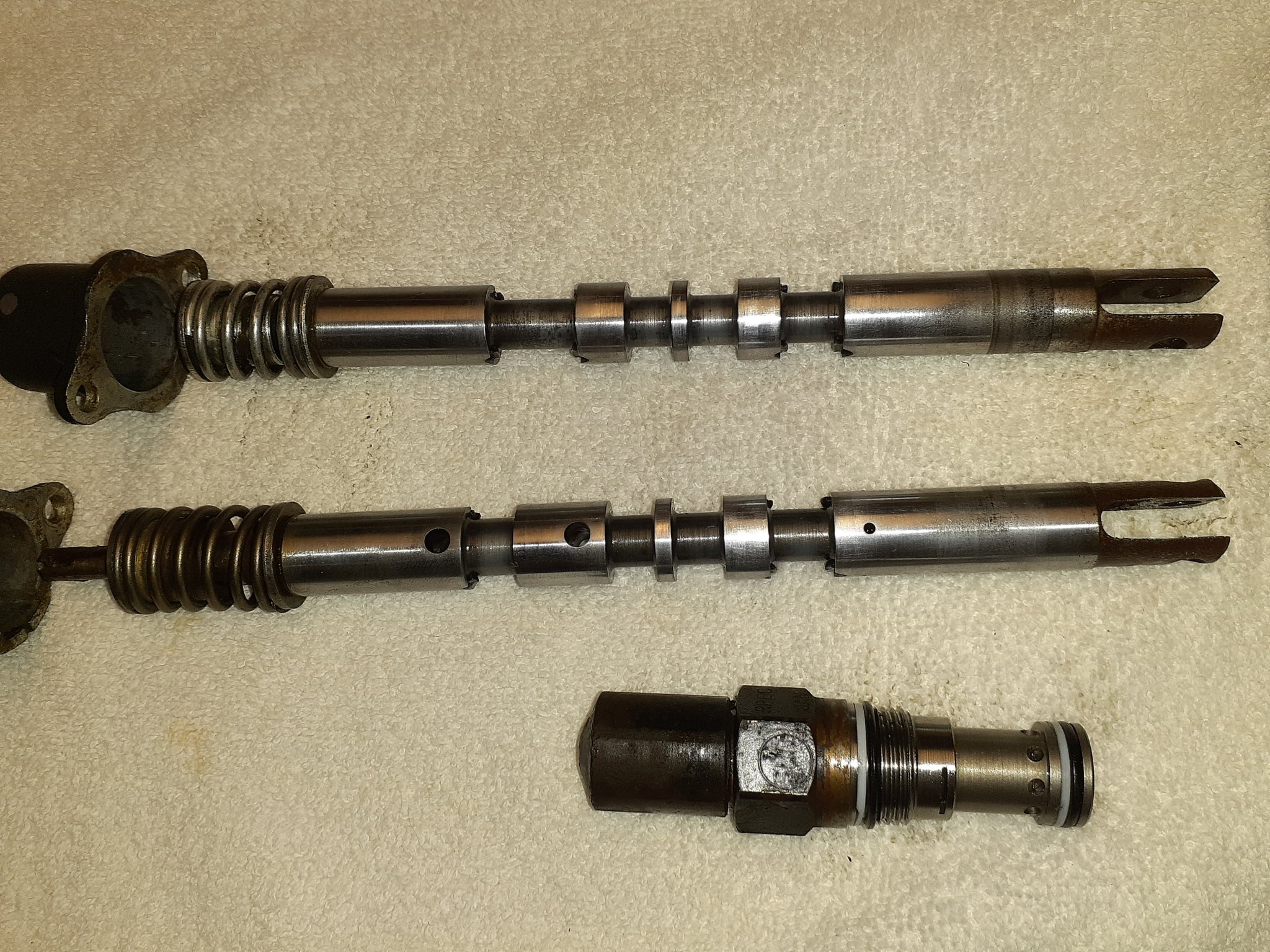

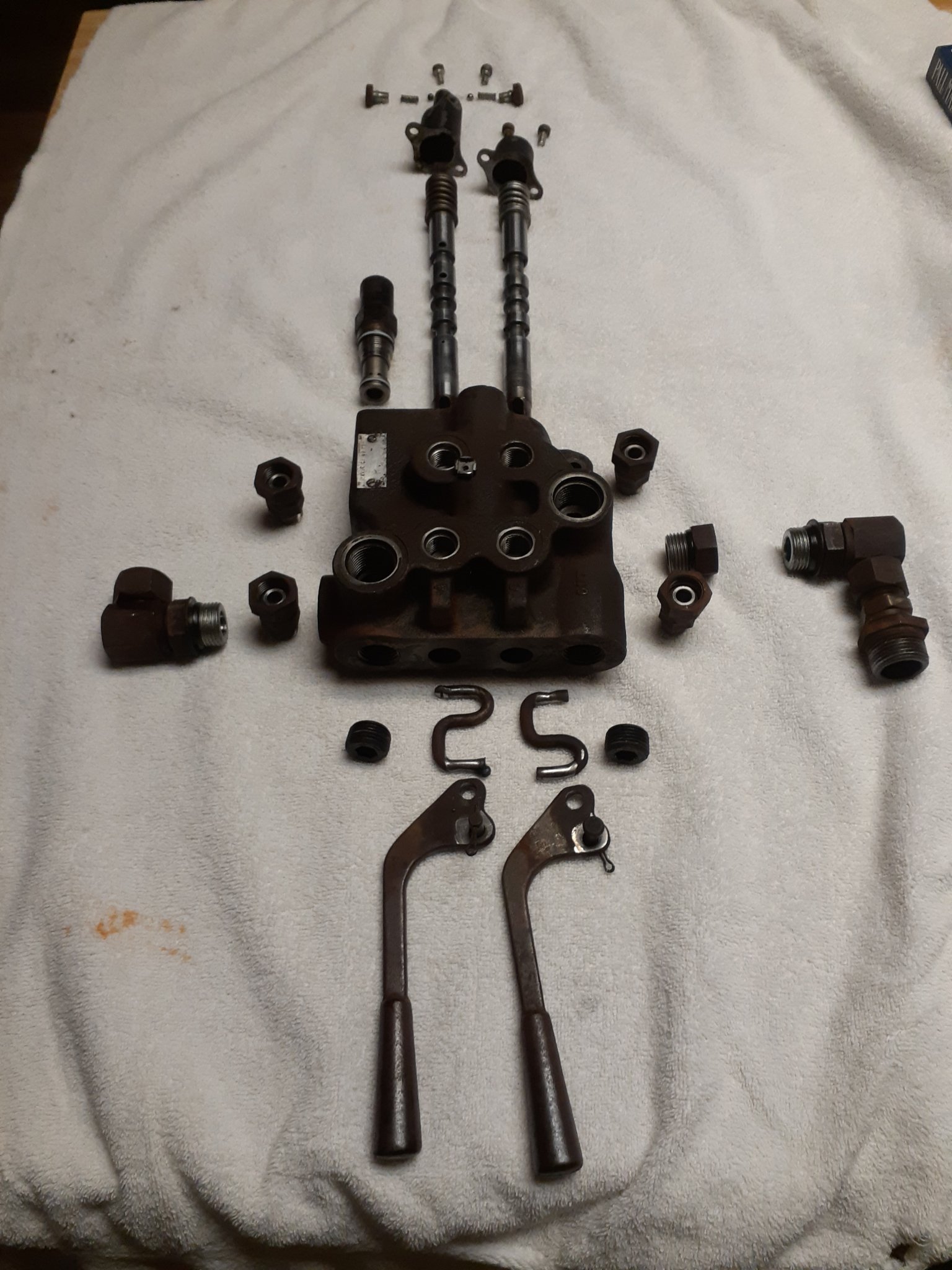

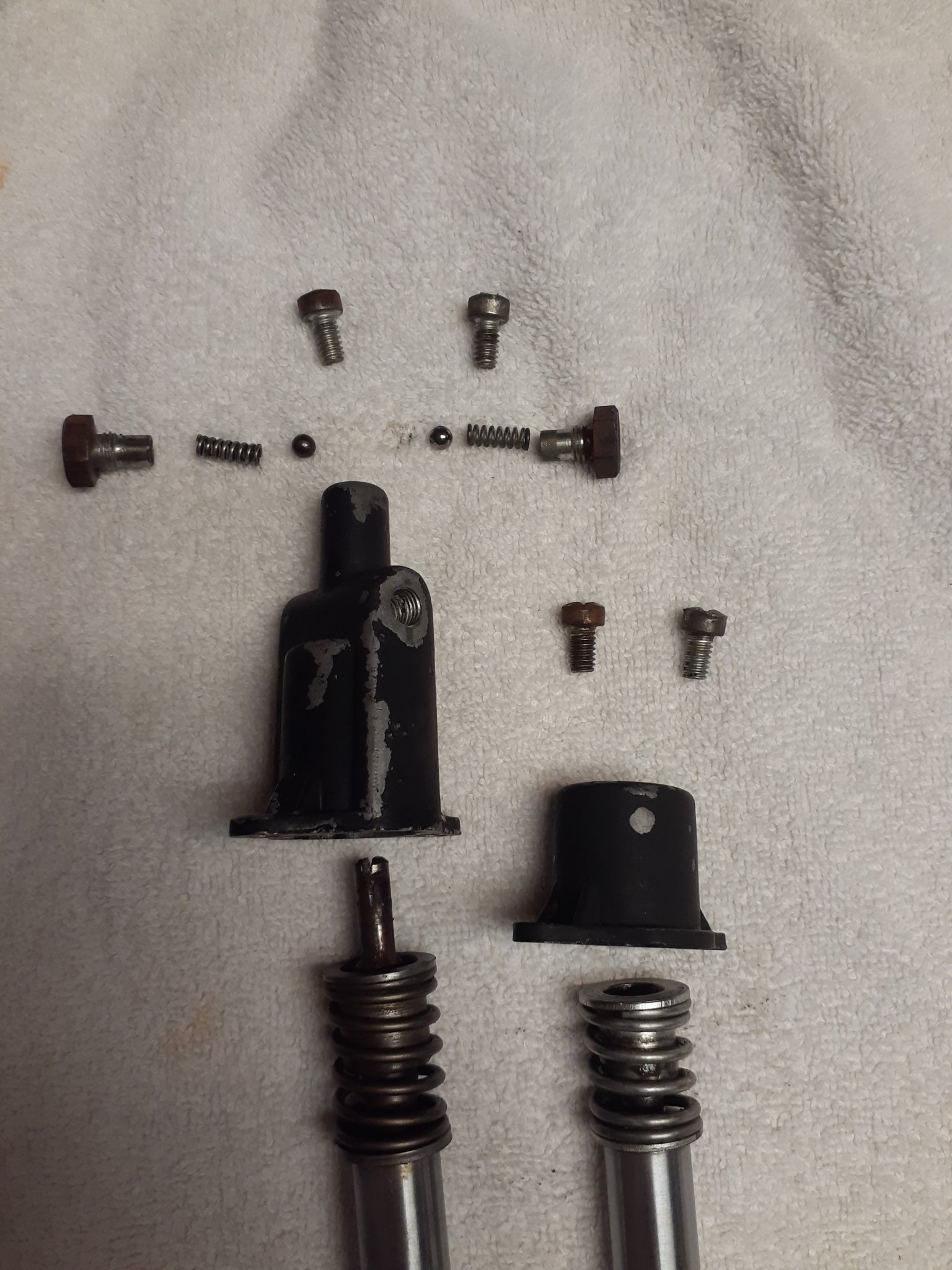

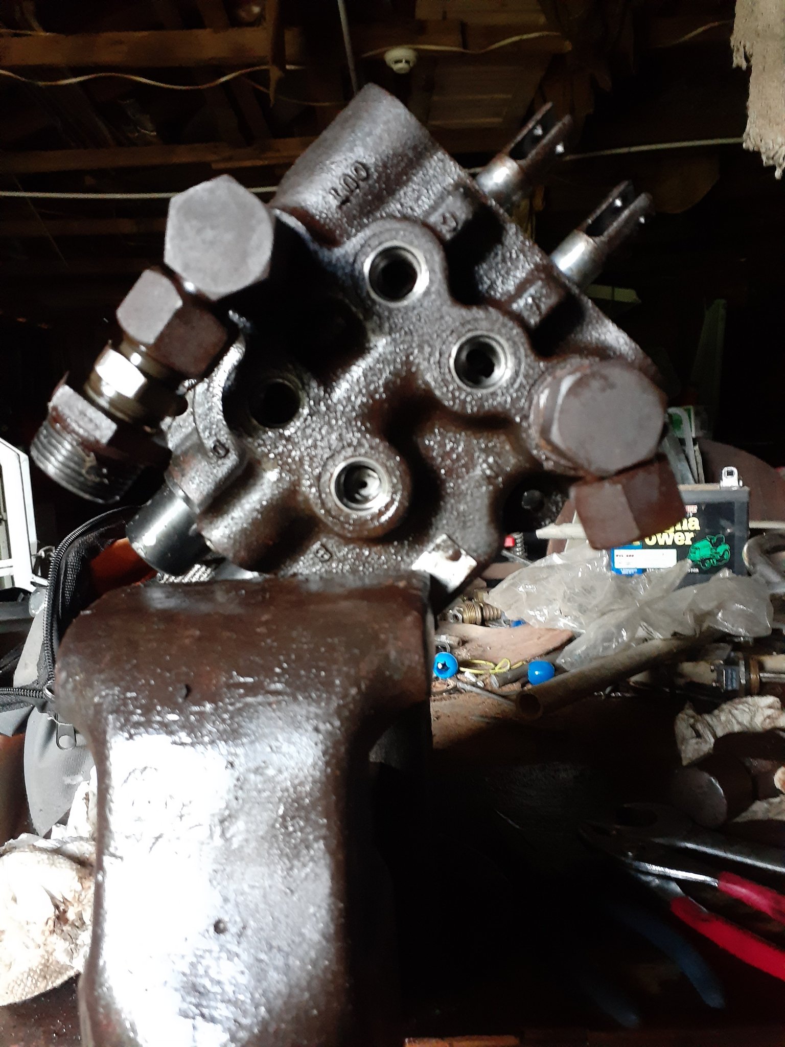

Dave_eng,
I cleaned out the reservoir today, nothing but fluid in it and tested the hose coming off the filter, flowed great, no blockage there. I also removed the loader controls, took it apart and cleaned it up in my parts washer. I took pictures of everything laid out in order, I'll try to explain them.
1. this is everything laid out.
2. This is one of the rods and what I think is the relief valve on the left.
3. This is he top of the control rods, notice the little balls and springs.
4. This is looking down the holes where the hoses to the cylinders attach. On the far left at the bottom there is a square piece it came out of the on the bottom left going to a cylinder. It shows it in the picture beside it before being removed.
5. Here are some pictures looking down the holes from the front and back of the controls.
20200817_200736.jpg 20200817_200748.jpg 20200817_200832.jpg 20200817_200837.jpg
6. This is a close up of the rods and the Relief Valve, I can push in the end of the relief valve using the cap or a pin pretty easy, it's not stuck open or shut.
Will have to send the other in another post as 10 is the limit.

The Relief Valve looked pretty good, wasn't stuck, moved in and out with a little force using the cap off a pin to push it in and it comes back out when released.
Look over the pictures and see if you see anything that could be causing the problem.

I put the controls back together this morning, removed all the hydraulic lines even the metal ones and blew them out, put them back on after installing the controls and put the reservoir back on, replumbed it to the filter, run the filler and pressure line to the front where the pump will go, reinstalled the quick couplings for the 3 point hitch and mounted the pump to the bracket that bolts to the frame. It has to be bolted on the bracket before mounting it to the frame since there is no way to tighten the bolts to the pump with out putting it on the bracket first.
I pulled the tractor in my shop as they calling for rain for the next 3 days, had to drag the bucket inside with it down, but it not a problem as I got a 2' x 2' steel ramp in the center for riding my motorcycle on to the concrete floor and the bucket road up on it.
Tomorrow I'll reinstall the pump, then test the filler and pressure line in a bucket of fluid to be sure it pumping, if so then connect them to the controls, refill the reservoir and see how it goes.
Anyone got any last minute suggestions? Hope it works this time.
