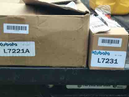

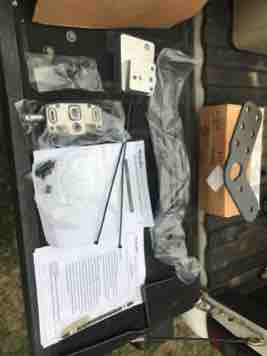

I have a complete set-up to put on a rear remote on my L4600 that didn’t have any remotes when I bought it a few years ago. I have since sold the tractor and replaced it with another. The parts are still in the box, not sure what other models it will fit. I paid $900 from the local kubota dealer and will take $750 obo. I will get pictures tomorrow when I get home from the fire station.
Willing to trade for some implements!! Let me know what you have.
Thanks
Josh

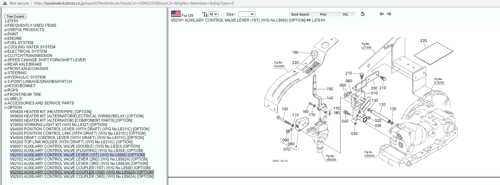

I'm having the same problem, trying to get a part number for the assy cover plate for the L4701 to install rear remotes.
716
284
T
The old kits described here have been superceded. Go to Kubota parts online and look up the l4701. The new kits and components can be found under the Options tab.

Finally ran down the part number for the adaptor plate for rear remotes. This number fits the l4701 Kubota
Part number: 77700-05645

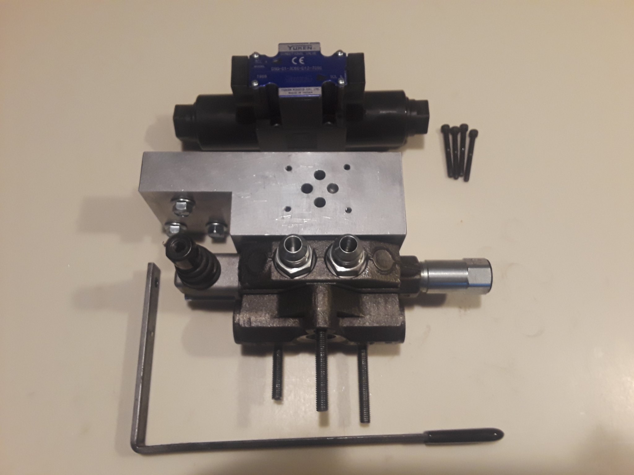

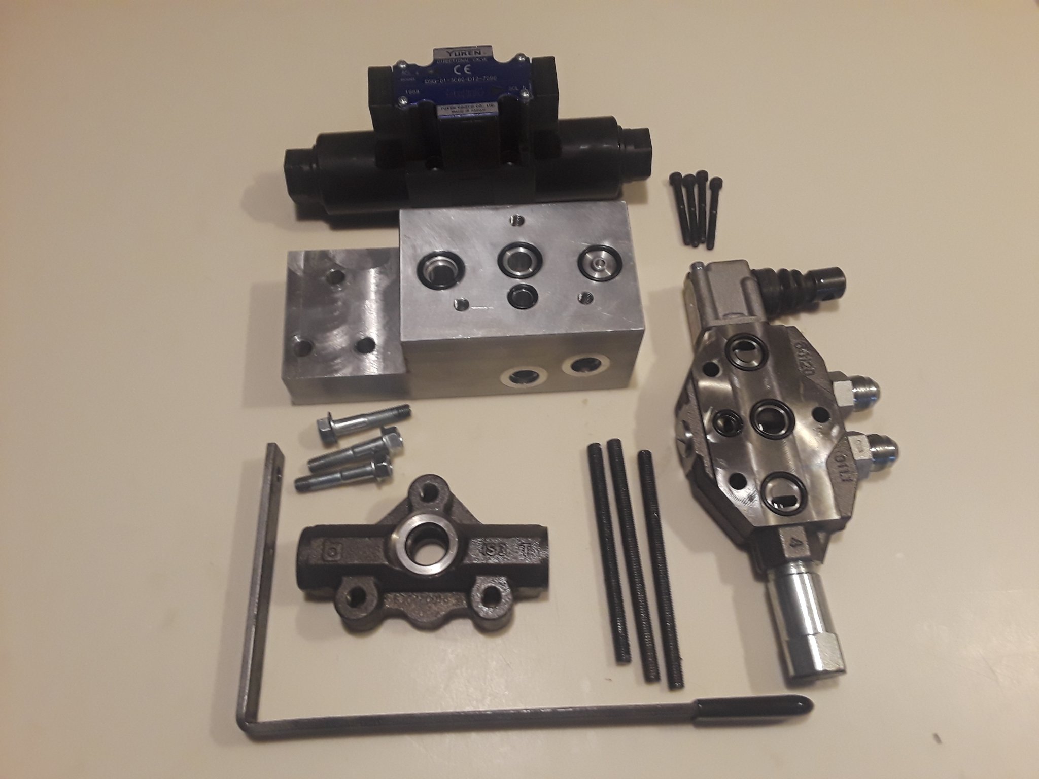

I found one and is on the way now. I have two valves one for the top link and the other for the side link. I made the end plate and the levers. I have two cylinders that I will modify for the top link and side link. If you need the company name I bought from let me know and I will post it.
716
284
OK - now I got it. You already had the OEM valves and need the adapter to hang them..
I am doing something similar for the L2501/L3301/L3901 except I am using aftermarket valves and making a custom manifold to adapt them to the transmission. I would love to do the same for the L4701 but without hands on access to a machine getting the fit right would be next to impossible. One of those L4701 blocks would make a nice starting point for getting measurements but the price is a little too high to experiment with given the work that would have to follow. Messick's lists it at $231.
