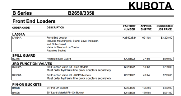

I'm trying to do archeology. I can see a whole goods list from 2014 here. It lists a B1658 pin on quick coupler. That was on a LA504 loader, and fit a B3200. That same loader took a B1625 pin-on bucket, and that same bucket B1625 bucket fits a B2650. Therefore I believe a B1658 would fit either a B3200 or a B2650.
I see a whole goods list from 2019 here. It lists the B1625 bucket, and says it fits both the B2601 and the B2650.
So my take is that the B1658 will fit the B3200, the B2650, the B2601. I think that's what people have said before - all three tractors have the same pin spacing and the same loader arm spacing. Can anyone see a flaw in that logic?
