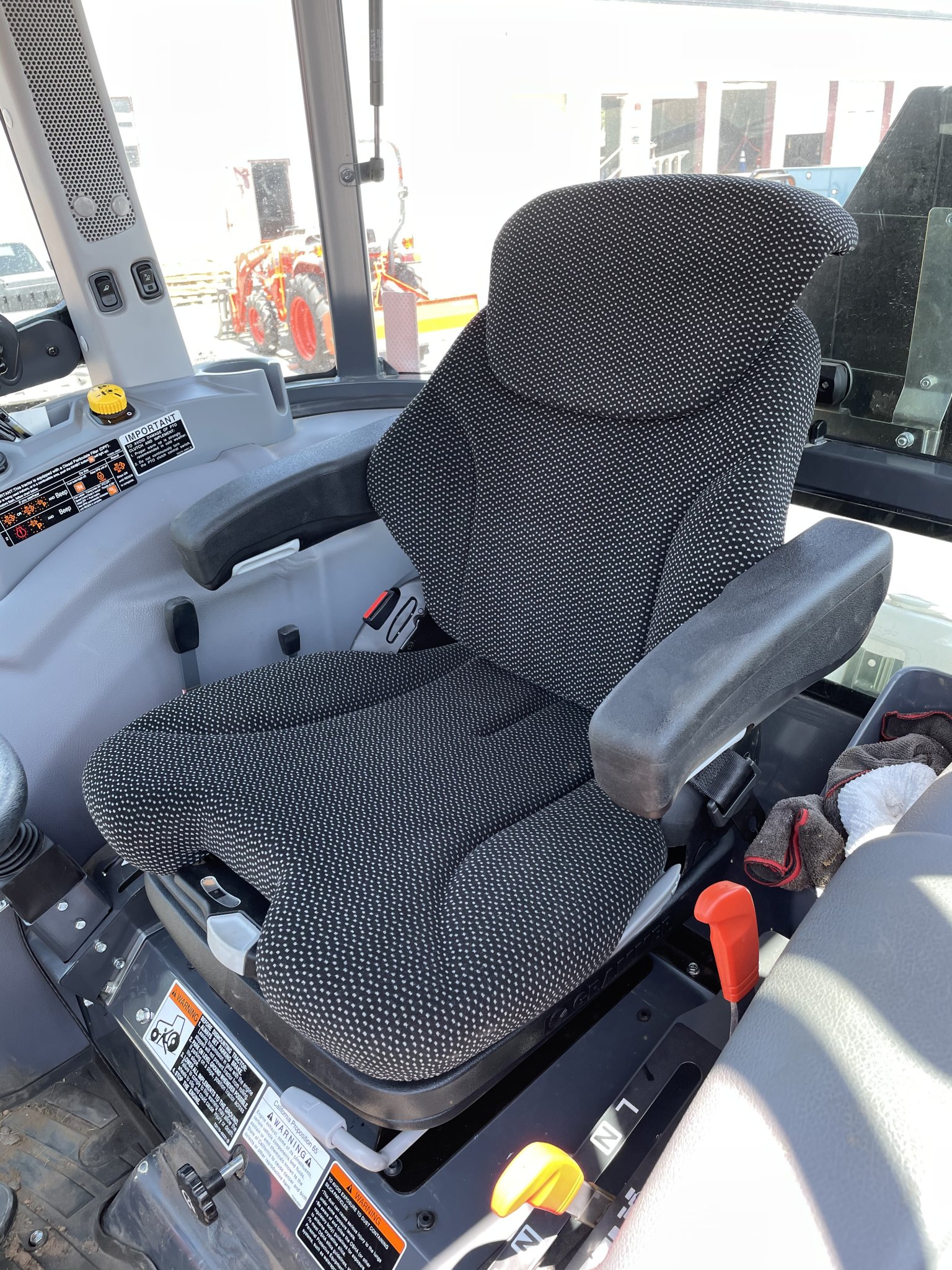

Cloth (l6026) I just got one. Ill take some pictures of the seat when I get home. It does not swivel or have stationary pto unless you get harness l2609. Has adj armrests, and seat back riser. It is the same as the grammar/km136 black matrix cloth. It does have special risers for the seat base.
l6023 is the same seat in vinyl.

In what tractor is the seat in the picture is it your l6060 am looking to get one for my l4060 same cab i think
Correct l6060,
Same seat kit same exact cab minus the rear mount bracket…
