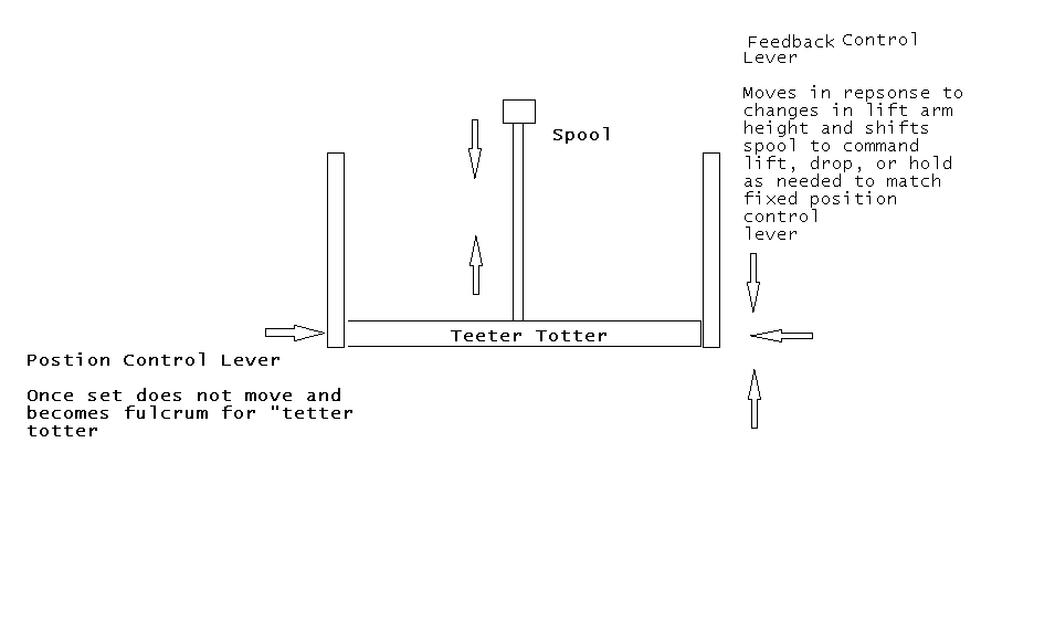

Dont you just love the English language and the ease of constructing ambiguous references? Up until now no one said the position control lever moves.
The position control lever sets the desired lift arm heght and does not move once set by the operator. Once that is set the feedback lever does move in response to changes in lift arm height and is what bumps (shifts) the control valve (spool) into and out of neutral so as to maintain that set height.
One picture might be worth a thousand ambiguous descriptions.
