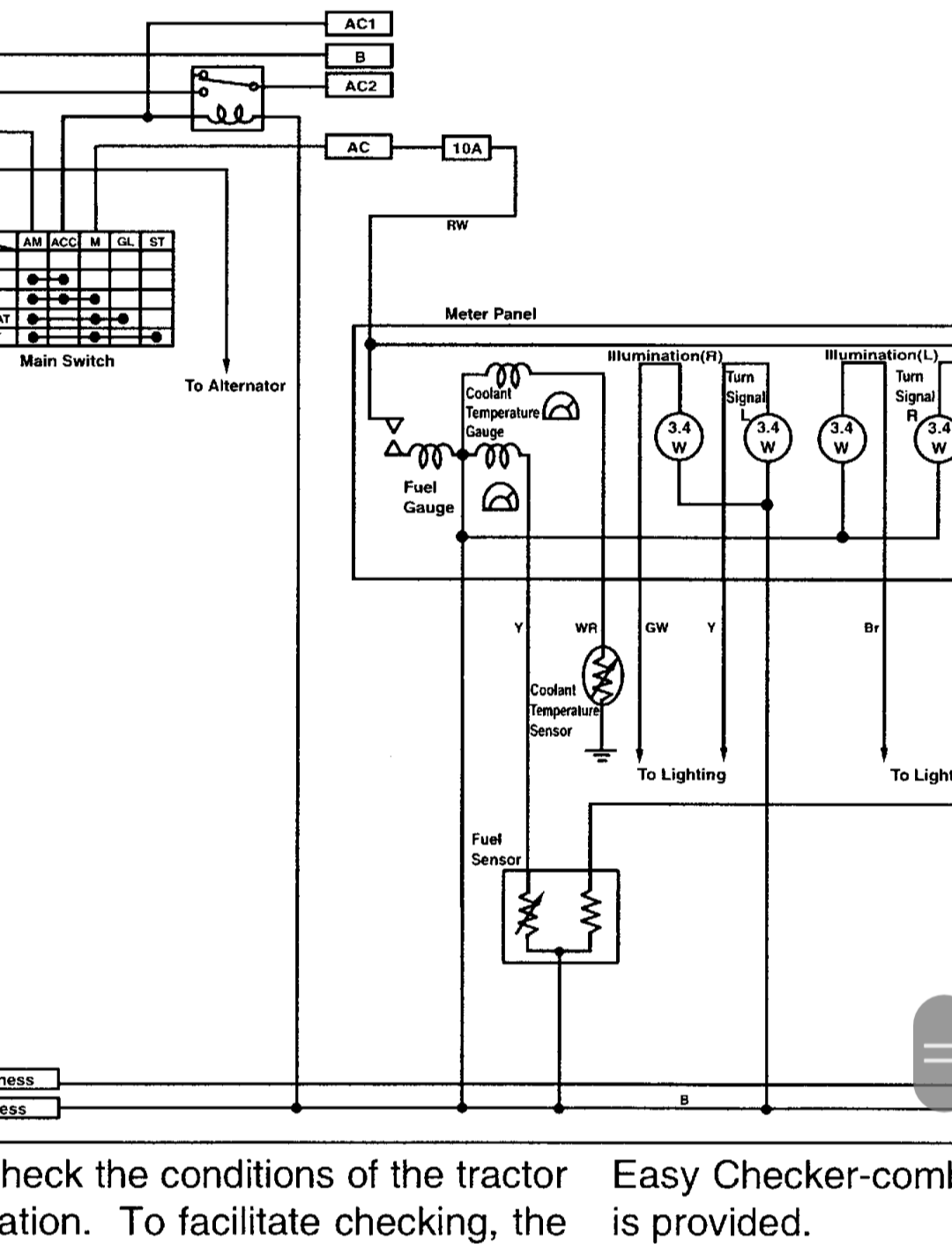

You didn't say what the issue is. Your tractor has a typical gauge and a low level alarm. I think it turns on the charge light when the fuel level is low. Below is the schematic. You can see there is the typical variable resistor and what appears to be a fixed resistor, but is really a thermistor.
* When you remove the connector and turn the key on, the fuel gage should show empty.
* When you ground the yellow wire at the connector and turn on the key, the fuel gauge should show full.
* The fuel and temperature gauges share a voltage regulator - is the temperature gauge working correctly?

re: When I short the two prongs on the cable at the sending unit, the gauge goes to full.
According to the wiring diagram in the WSM..
That isn't the proper procedure . One of those prongs is the fuel sensor, the other is the 'out of fuel' sensor.
To bypass the sensor, you connect the Yellow wire in the harness to ground. This should make fuel gauge go to 'over full'.
To test the 'out of fuel' circuit, you connect the Yellow/green wire to ground. This should turn on a light, 'low fuel/charge'.

I'm talking about the fuel gauge, not the temperature gauge. The temperature gauge works fine. I posted that when you short the two wires at the connector, the fuel gauge goes to full (it does not respond otherwise). And now I know that is not the way to test it. I'm guessing the only reason the gauge went to full is that is saw ground through the low fuel light circuit. I know now to test the fuel gauge side of that connector to ground. I'm sorry I confused everyone here. I'll get to that later this week.
