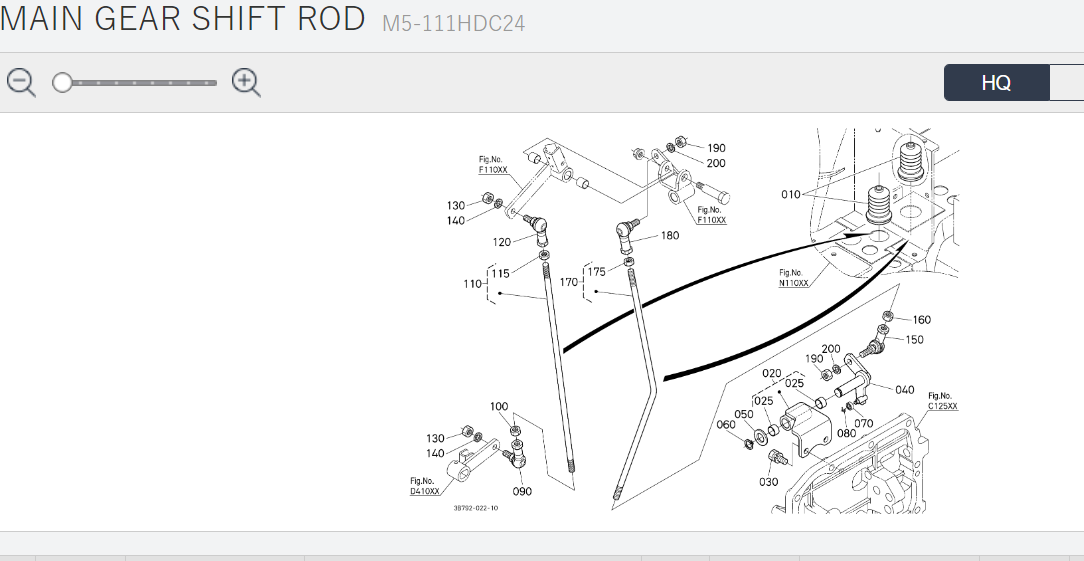

Removing the boot on the shifter will let you see the top, but the rest will be tucked under it.

Thank you. But I was referring to is there a panel on the top of the transmission which unbolts? It FWM is not super clear on it. Similar to the shift tower on a regular tranny.
Look on the RH side of the transmission case.
