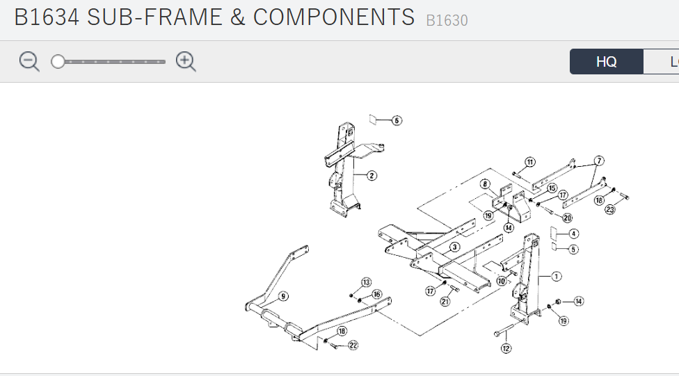

North Idaho Wolfman Moderator Staff member Lifetime Member Equipment L3450DT-GST, Woods FEL, B7100 HSD, FEL, 60" SB, 743 Bobcat with V2203, and more Jun 9, 2013 33,391 8,704 113 Sandpoint, ID May 31, 2025 #2 You would need to make a complete to the rear axle subframe for it. Older models will break in the middle if you don't do that. Here is the subframe Reactions: 1 user
