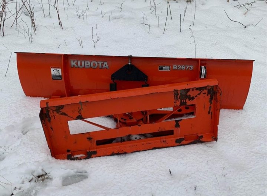

I have a b2620 and plan on putting a quick attach on the loader.
Was wondering if the Kubota B2673 plow 72 in quick attach (pictured)would be OK to mount on the LA364 loader on a B2620 tractor??

I don't see why not.
It's a little wide for a B, but when you angle it you loose width.
Worst case hack the sides off of it. 🥴

Your should be fine. I use a 80” old Fisher snow plow that I adapted to fit the quick hitch on my B2920 with LA364 loader.
