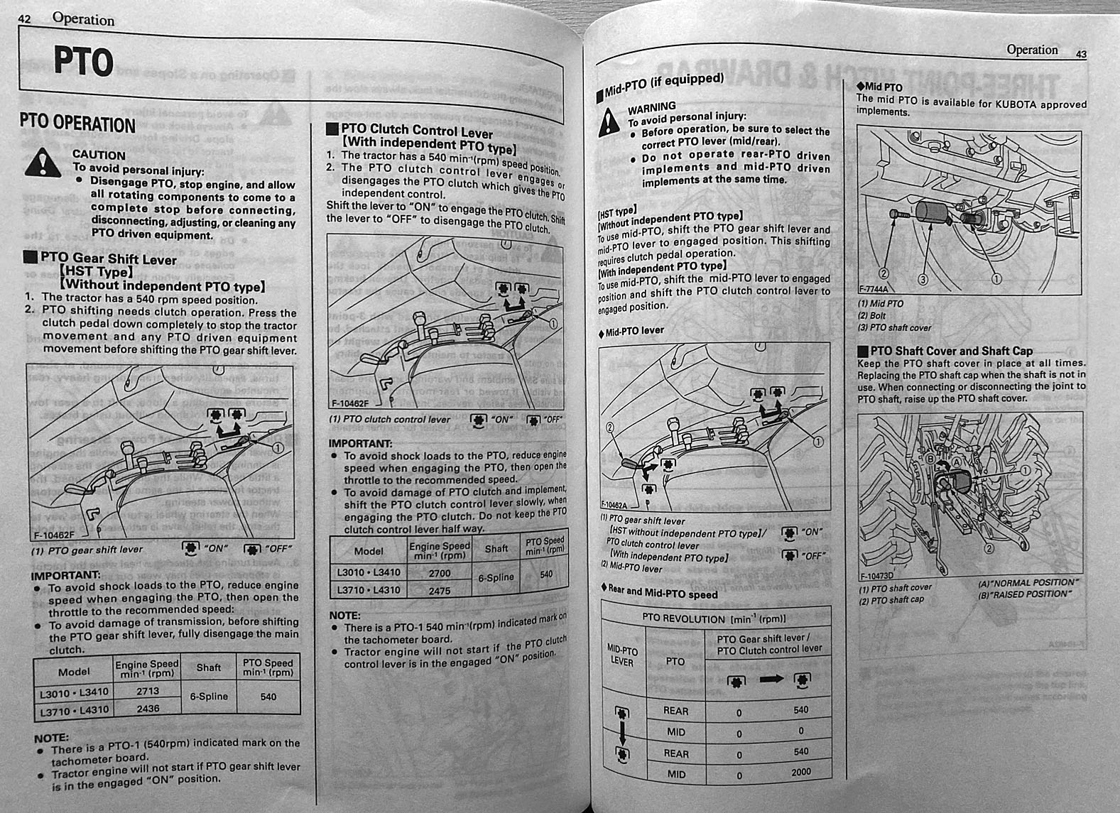

U unioncreek Member Equipment Kubota L3710 GST Nov 1, 2023 55 6 8 WA Nov 6, 2023 #1 I just bought a used L3710 GST. Don’t have a owner manual and can’t find one. Can someone tell me how to operate the PTO. I’ve mostly dealt with John Deere tractors. Bob

N3BP Active member Equipment B7200DT, B7200HST-D, L2900GST, L3010 HST TLB Sep 20, 2016 510 239 43 Lebanon, PA Nov 6, 2023 #3 See attached from the owners manual. Since you have a GST, you want the section that says "without independent pto" Attachments IMG_1222.JPG 464.9 KB Views: 166
U unioncreek Member Equipment Kubota L3710 GST Nov 1, 2023 55 6 8 WA Nov 6, 2023 #4 Thanks for the info. Just brought the tractor home today.
