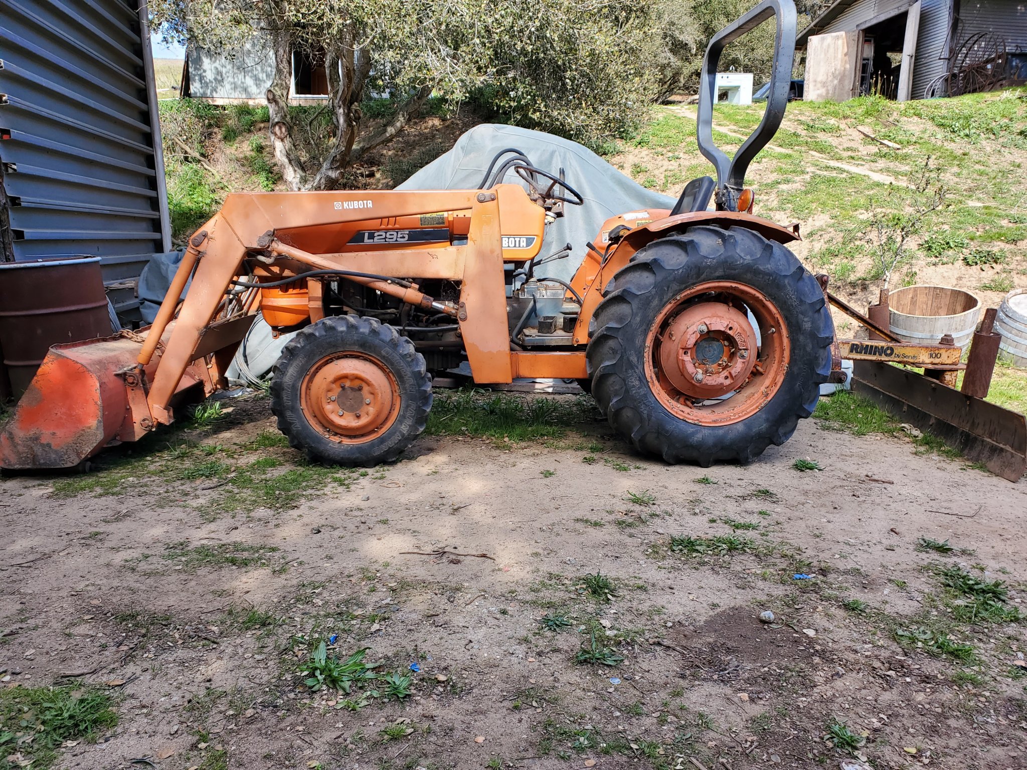

First off thanks for letting me join.
Joined because I need help with my l295dt kubota
I worked on classic cars but never on tractors, tractor thing is all new to me
So the problems I'm having is the front loader and 3 point are very slow to lift and operate. was working fine a few days ago.
What would be the first thing to look at. I have a service manual but info is not the best kinda confusing specially if not familiar with the components of the hydraulic system or what they do.
Thanks

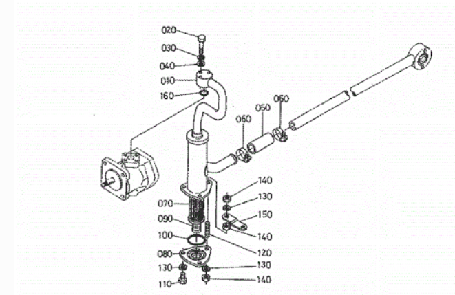

I would first check oil level and condition then check and clean the filter item 070 below. You will undoubtedly have to drain the oil when removing the filter. That or be able to dram a vacuum on the trans sump while you are removing the filter.
View attachment 56116 View attachment 56116
So just let the oil drain into a pan from the filter ? or drain from a different location like a drain plug on transmission or ?

Ruger1980 posted a parts illustration for the main pump. If the rubber hose #50 and two associated hose clamps #60 are allowing the pump to suck air, performance will degrade significantly. An air suction leak can happen without any visible external oil leak.
