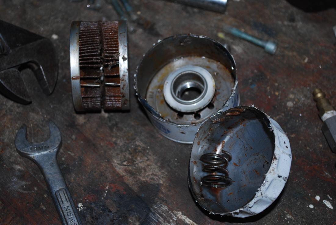

I appreciate the response so far. I did try flushing it again from the tank, through the new fuel filter removing the hose just before the injection pump and everything is clear with no restrictions. I pulled the injection pump and everything looks good as far as I could tell. The rack control arm moves freely and you can feel the springs are operational on the rollers on the bottom. One thing I did notice that I thought was odd is that I blew some air through the injection pump inlet and the only port that air would exit was the 3rd port which is the one that no fuel comes out of. Is there a seal inside the plunger of that port that could have failed? I reinstalled the injection pump and lines and again tried cranking while bleeding air at the injectors. I did get fuel at the first two (although it seemed minimal to me) but none at the third line. I cut open the old fuel filter and it did have some rust internally as well as being dirty. I am thinking it is the pump but still having a hard time believing a 99 model with 600 hours has a bad injection pump. I will check Monday for price of new/rebuilt pump but I know its a costly item as well so I want to be sure. Does this seem like the right approach or am I missing something?
