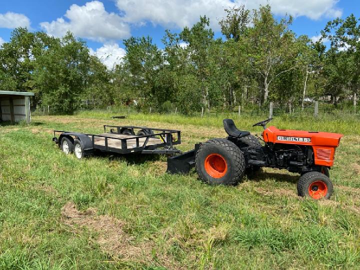

Just recently purchased an older kubota L185 2 cylinder diesel. Old owner said it ran fine a few months ago but has been having some issues recently. Got it for 500$ so not terribly mad about it and not afraid to put a little money in it to get it running good Anyways I have bled injectors,bypassed tank an used a bottle to supply fuel directly to injection pump. I'm thinking the injection pump may be failing or already bad, it will spit small wisps of fuel when injectors lines are cracked but this may be normal im just used to big fuel flow on cummins an cat's,. I bled lines with full throttle and decompression lever engaged. Will run for a few seconds then die out. Got it to idle for about 5 min or so,but throttle it up an it Will rev up an then die.
