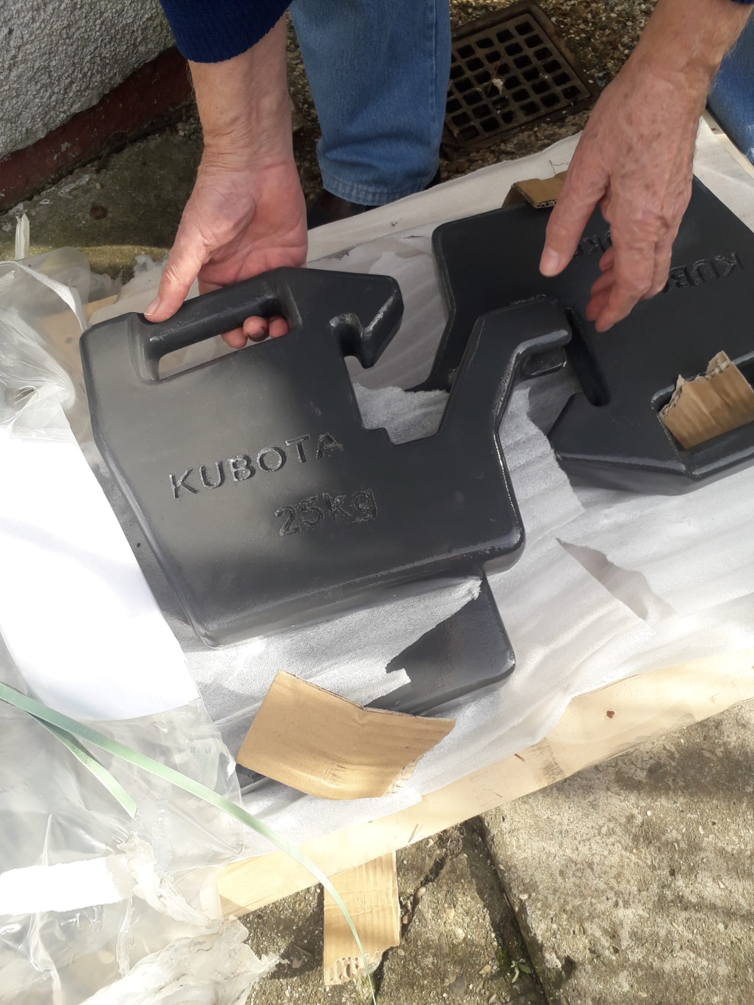

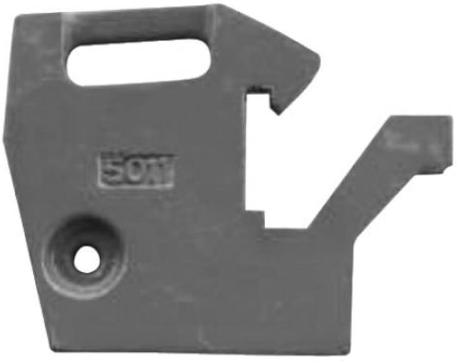

Hi, I just bought front weights for my tractor. See them attached. I think I have read someplace in the manual that they should be taken off the tractor when not being used. It is kinda tedious to keep taking them off and putting back on. Is there some particular reason why that should be done?
One thing I can think of is camber - maybe keeping the weights on all the time messes up the positive camber? Are the weights heavy on front joints?

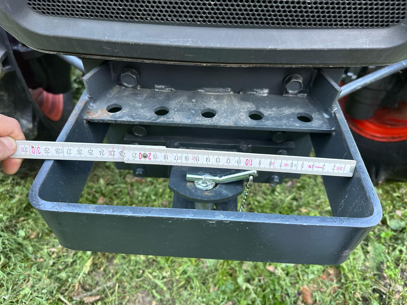

I don`t have FEL, however I do have front end trailer bar - so curious if it will interfere with weights. I am going to tractor on Saturday so will try the weights out.

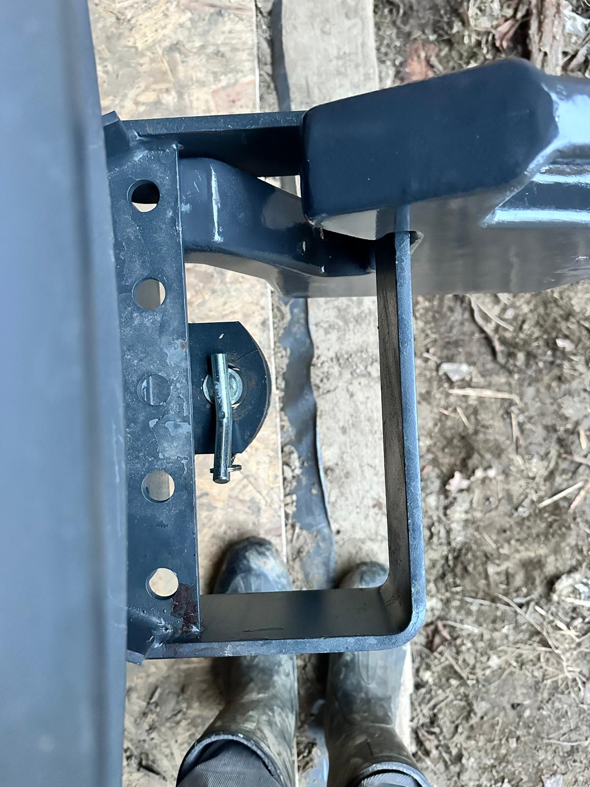

Based on your photos of the weights and the photo of the bracket, that trailer bar will absolutely interfere with the weights.

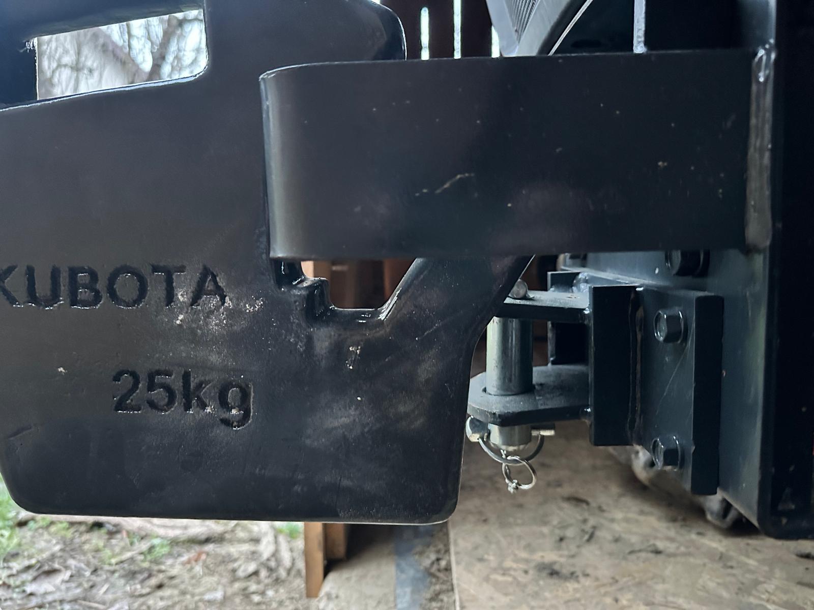

The weights are slated, so I think there might be a slim chance it will work out without removing the trailer bar. I hope engineers at Kubota thought of that :)

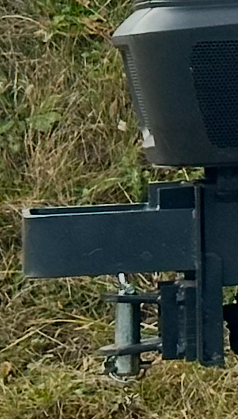

That's a useful photo .... hmmm .... maybe it will work. 😂 Is the trailer bar a Kubota accessory or aftermarket? The previous photo gave the appearance that the trailer bar is mounted higher up relative to the bracket. You'll know soon enough.
It is original Kubota accessory. Will post the result.

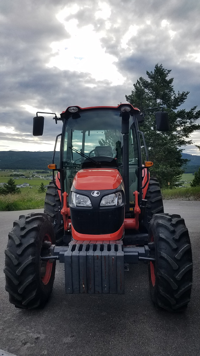

Looking forward to hearing how it goes. In the meantime, here are the 8 of 10 weights that I bought sitting on the Kubota. Total weight including the bracket is around 875lb.

Unfortunately no luck. They don`t fit together with front trailer bar. Kinda frustrating. Its ALMOST a fit. Cca half of an inch interference.

It's a lot less than the weight of the loader and it's what Kubota recommends. The bracket only holds 8 weights but I have two more that could go on if I modified the bracket a bit, but then I'd be exceeding the weight listed in the owner's manual.

That's what I thought based on your previous photos. Can you modify something to make it work?
I was thinking of cutting the notches in the weights.
