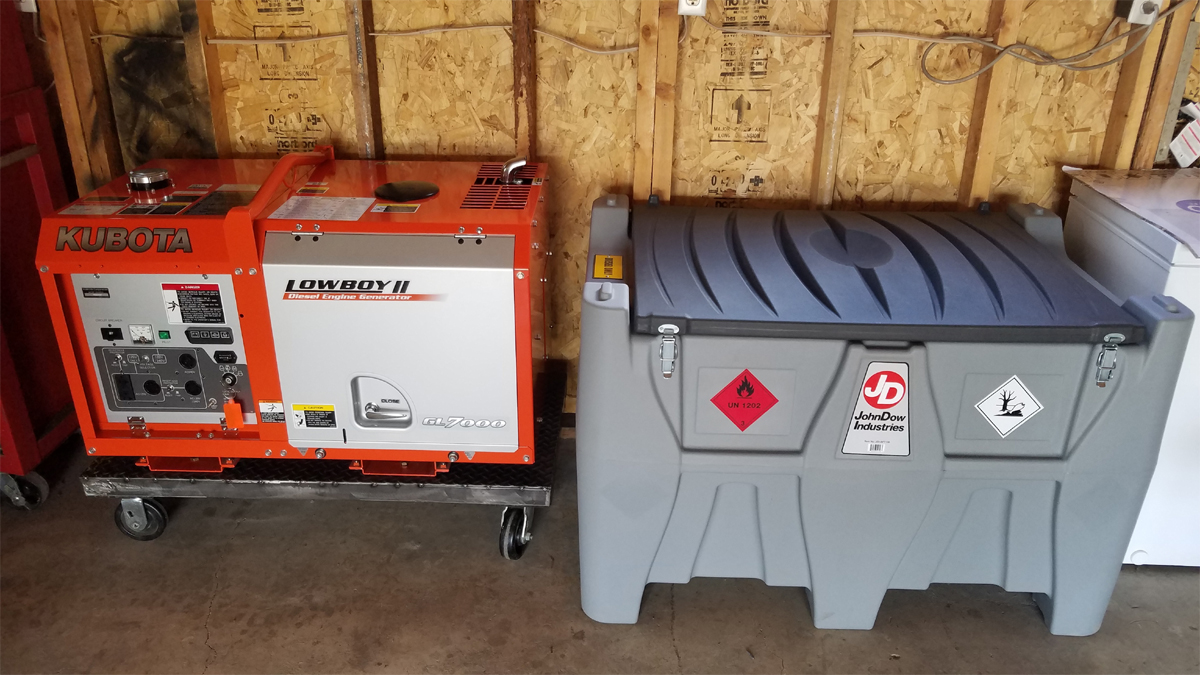

I bought a GL7000 for home backup about 18 months ago since I'd wanted one for years. Not specifically a Kubota, but a good quality diesel generator. I didn't want anything that was permanently wired into the house so that I'd have the option to use it around the property if needed or load it up in the truck and use it elsewhere. I bought a nice switching unit to connect it to the electrical panel in the house but have yet to hook it up. I made a heavy duty cart for it to move it around the garage, or from the garage to the house.
It provides around 20 hours of run time at 50% load, and around 10 hours of runtime at 100% load. It's not excessively noisy, it's smooth running and is certainly a very well made, quality generator.
Is it good value for money? I don't know. Are there much better options? I don't know.
I made a short video when I first bought it to show the noise and vibration that can be expected. It doesn't have a governor so runs at constant rpm.

My only reservation would be the run time without an external tank. Looks to be about 10 hours on the internal, depending on load. As much as I love diesel power, the cost per kw is high. Granted, it's a liquid cooled diesel. It just seems pricy for a temporary standby. Looks more suited for the belly of a motorhome or a yacht.
I have yet to use the GL7000 during a power outage, mostly because they tend to be very short up here. However, in the event of an extended power outage I'm fairly sure that I'd be able to make it 24 hours on one tank of fuel in the middle of winter. I heat the house with a wood burning stove, and wouldn't run high amp appliances like the hot tub, A/C, oven, dryer etc., during an outage.
I have a 106 gallon Jon Dow fuel tank, and the LMTV that'll be here in a couple of weeks has close to a 60 gallon fuel tank so I'll have lots of diesel on hand if needed. One of the appealing aspects for me re the GL7000 is that it's a diesel unit since I have a common fuel requirement for two tractors and two trucks which means more fuel available for the generator.

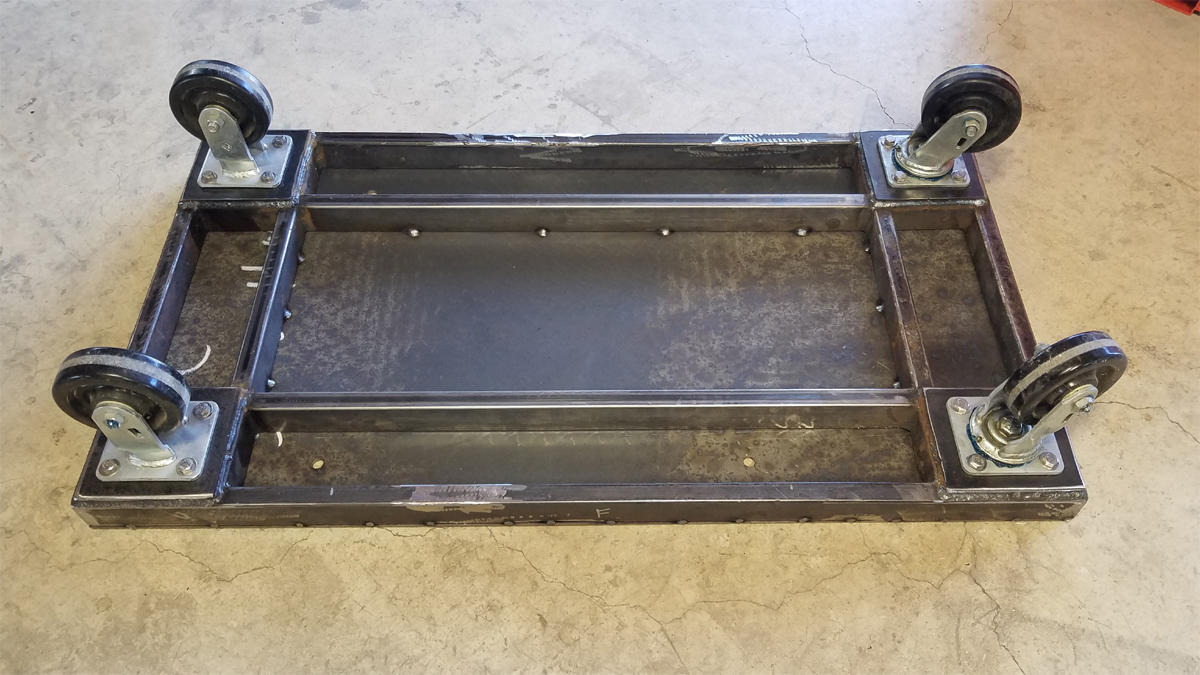

That’s a peach…are the feet meant to be able to slip forks in to pick up and move? Can’t really tell by the picture.
Yes. There are "skids" under the generator for pallet forks. I have it bolted to the cart and would pick up the whole thing if I needed to load it into a trailer. It's a heavy unit at a little over 500lb.
I think that cart was a wise idea. I cant imagine trying to thread the needle on a MX and poor visibility(at least mine has poor visibility to forks)…imagine doing that in a storm rain out dark after working over a glass of thinkin juice….I bet that would be more fun to watch than townies at the public boat ramp. Good call on the cart. That’s a nice set up for sure.

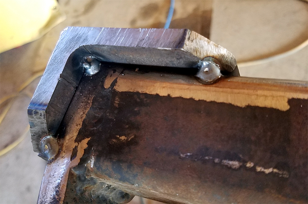

I'm in the middle of modifying an old tow bar so that I can pull the Jeep behind the LMTV next week. I've been running the Hypertherm Powermax 380 plasma, Lincoln Square Wave TIG 200 and Millermatic 185 off the GL7000. I'm adding some sections of 3/8" thick angle to the part of the tow bar that interfaces with the Jeep in addition to some other plates and such, and tacked them in place with MIG, then ran a 7018 pass with the Lincoln. I'm really pleased with the GL7000 and can see why they're a popular job site generator. Both welders and the plasma run on 220V.
I'm still getting a bit of smoke (blow by) at startup but the exhaust cleans up in a minute or two. I'm thinking that the low hours maybe partly to blame. First oil change is at 50 hours so I've a ways to go yet.

MCMXI, that new rod you have looks like it does a fine job! ;);)
Oops, corrected! :ROFLMAO: I really enjoy working with steel and of course welding. I used to be an excellent welder in a previous life but would need more than a few hours of practice to pass all of the welding certifications I once passed with ease. I have a 5G pipe welding certification (fixed pipe, 1/8" root gap, no backer plate) but there's no way I'd pass that test today.
