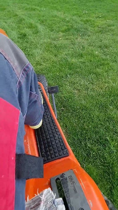

Kubota G1900-s
Mar 15, 2024
Poland
What NIW said and how long has it been doing that. Hade my both 4200 and 5200 HSTs would click like that all the time being pushed when not running. Just not that loud.
Did you tow it recently too fast?
I didn't tow it
daredevil1166
Mar 10, 2024
10
Oregon
This is normal.
The G series has orifices that bypass fluid allowing some movement without the tow valve.
I don't know for sure but I believe the noise is gear chatter as the HST bypasses because they have a somewhat unique gear case between the engine and HST.
