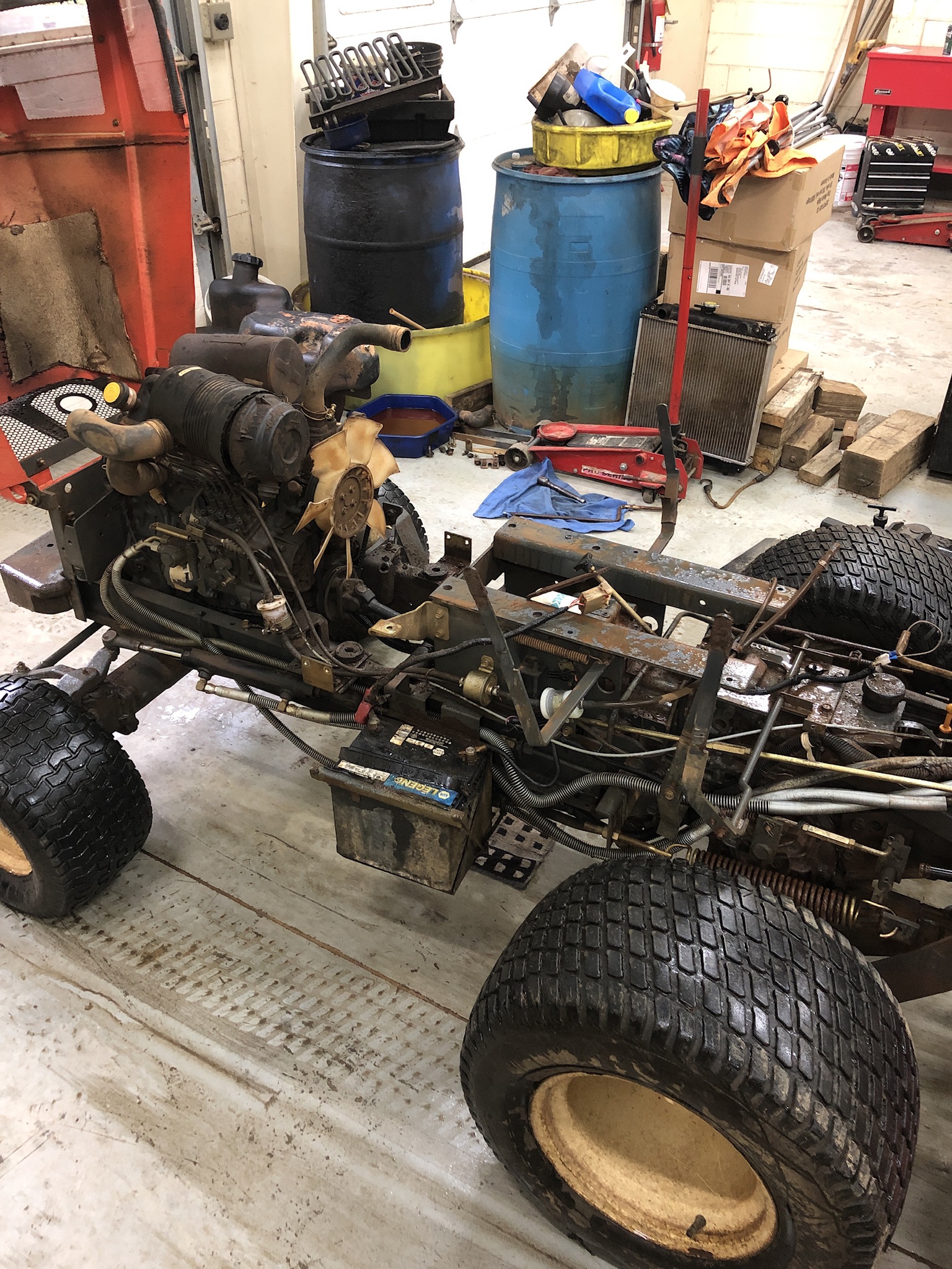

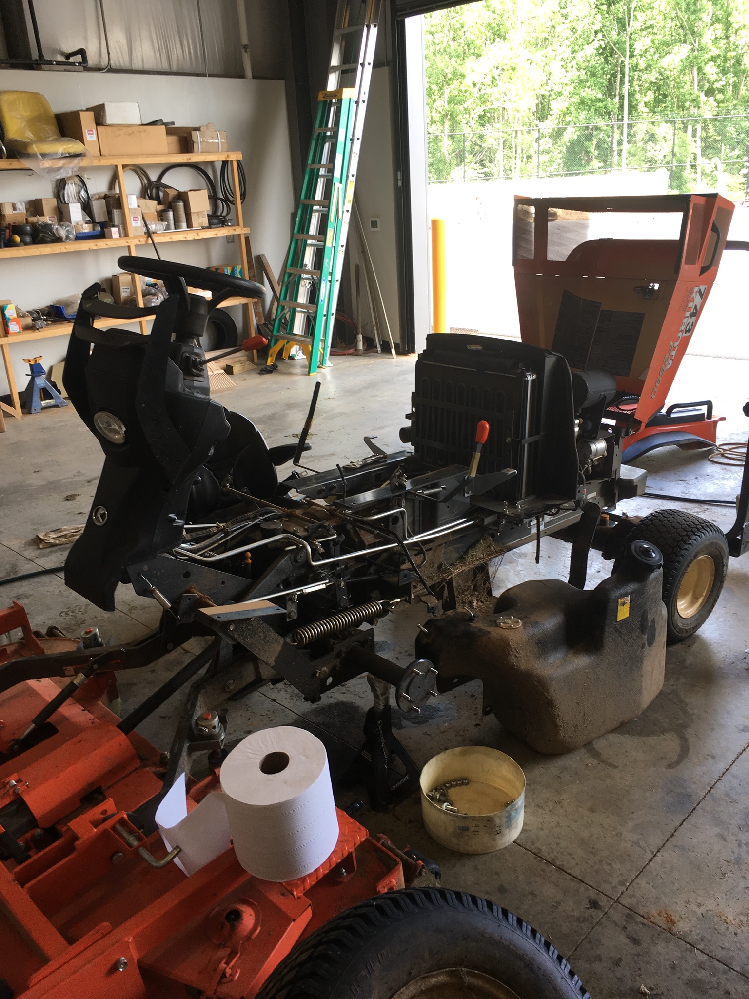

The pictures make it look like a lot of work to get floor pan off. It’s not bad, 4 bolts for seat, 4 for rops and two under the feet pads. Pan shimmys up and off. Can get to everything after it is off.
