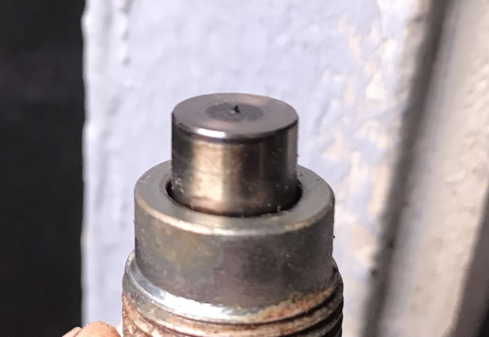

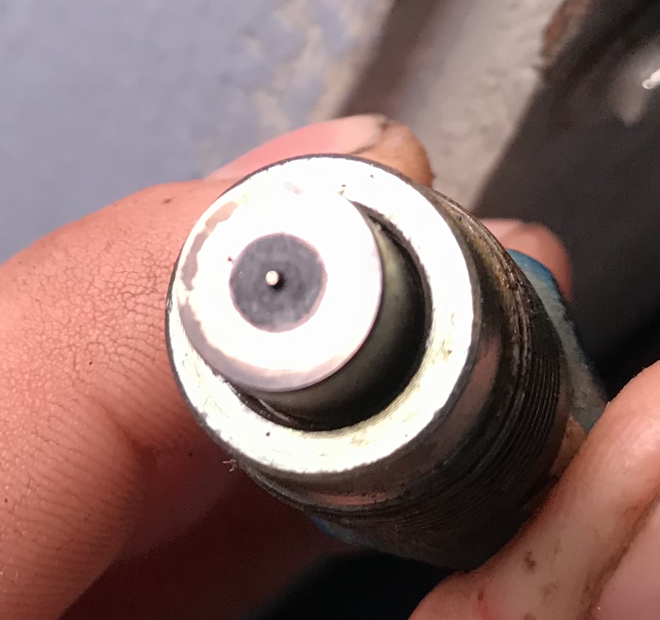

I first thought it was a fuel knock so I already put a brand new fuel injector on the 5th cylinder and the noise still there.
The noise appears quiet low-pitched and doesn’t sound like a metal to metal sound.

I install a brand new OEM injector and I also changed the heat seal and the ring injector gasket…
I can still try another cylinder but I am pretty sure fuel injection is fine. I don’t think my inline injection pump can suffer a one line break down. And the engine doesn’t smoke at all without or with load.

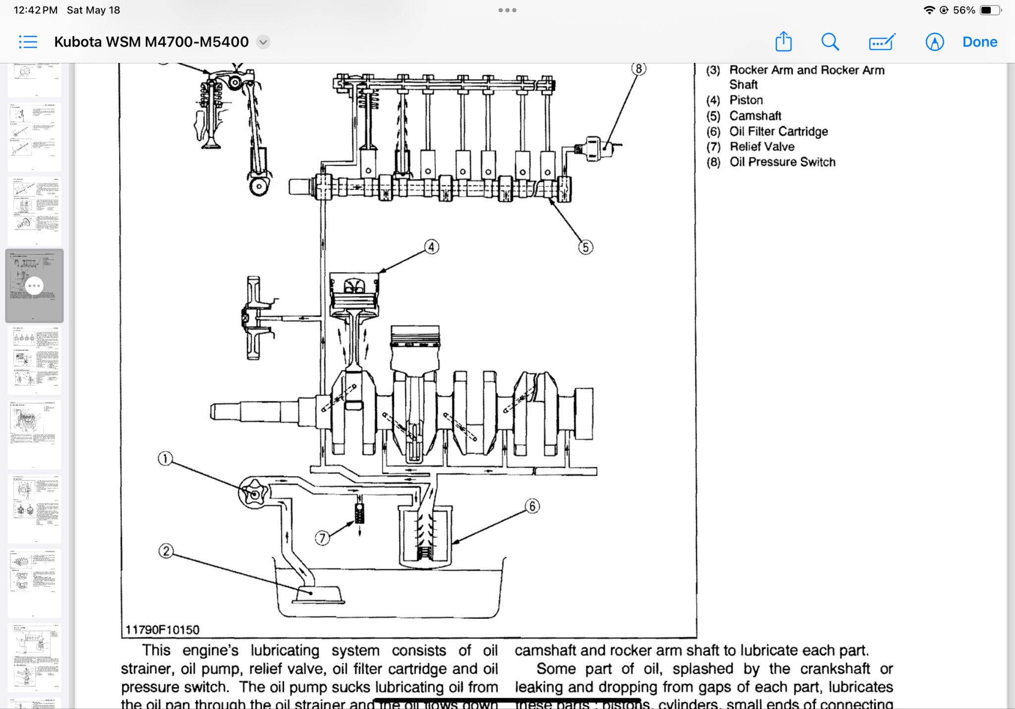

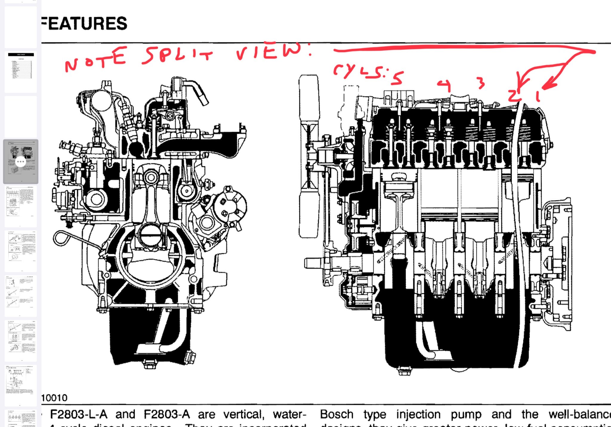

(deleted previous comment… due to my confusion as to cylinder numbering system.)
I was previously under the belief that No 5 cyl was the one closest to the radiator. However, the WSM states that cyls are numbered starting at the “gear case” ….(which led me to think of the transmission/clutch area)…
However, the WSM later comments (in the section addressing disassembly) referencing a “gear case” at the front of the engine. This would seem to indicate Cyl No 5 at the rear. (which would place No 5 farthest from the oil pump….although theoretically they all receive the same pressure and the oil press sending unit is at the rear of this engine next to the starter.)
The cut-away depiction of this engine also shows both cyls 5 and 4 to be at TDC and cyls 2 and 3 at BDC …simultaneously….which doesn’t seem likely. I’ve not been able to find the crankshaft throw-degrees info.

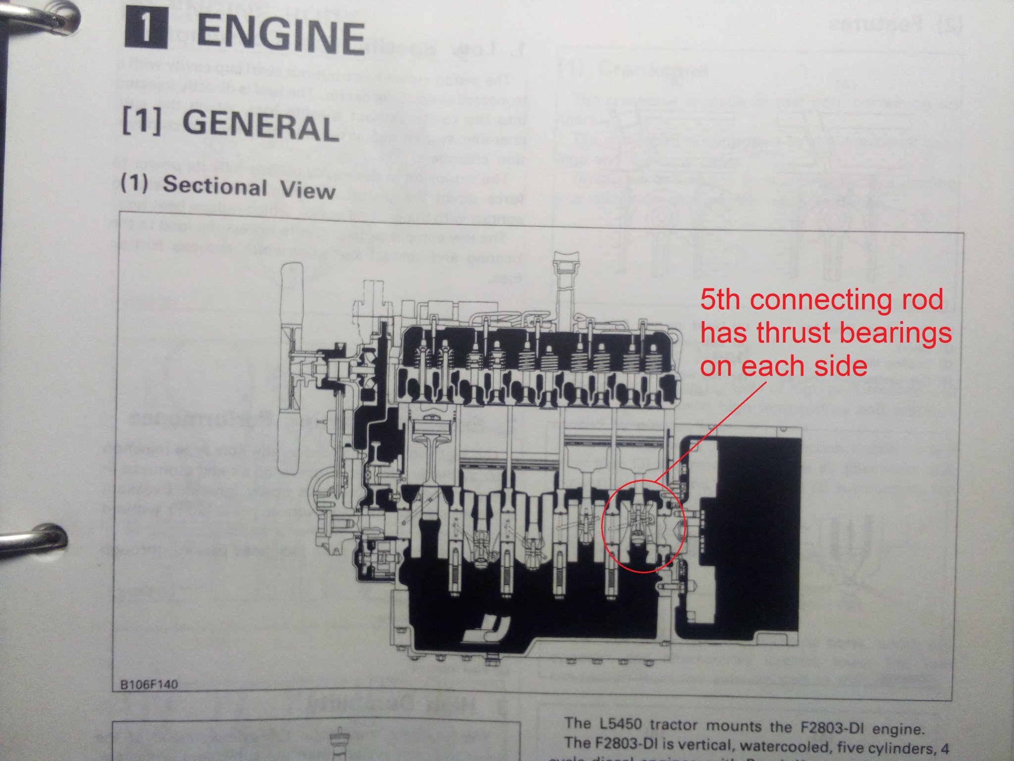

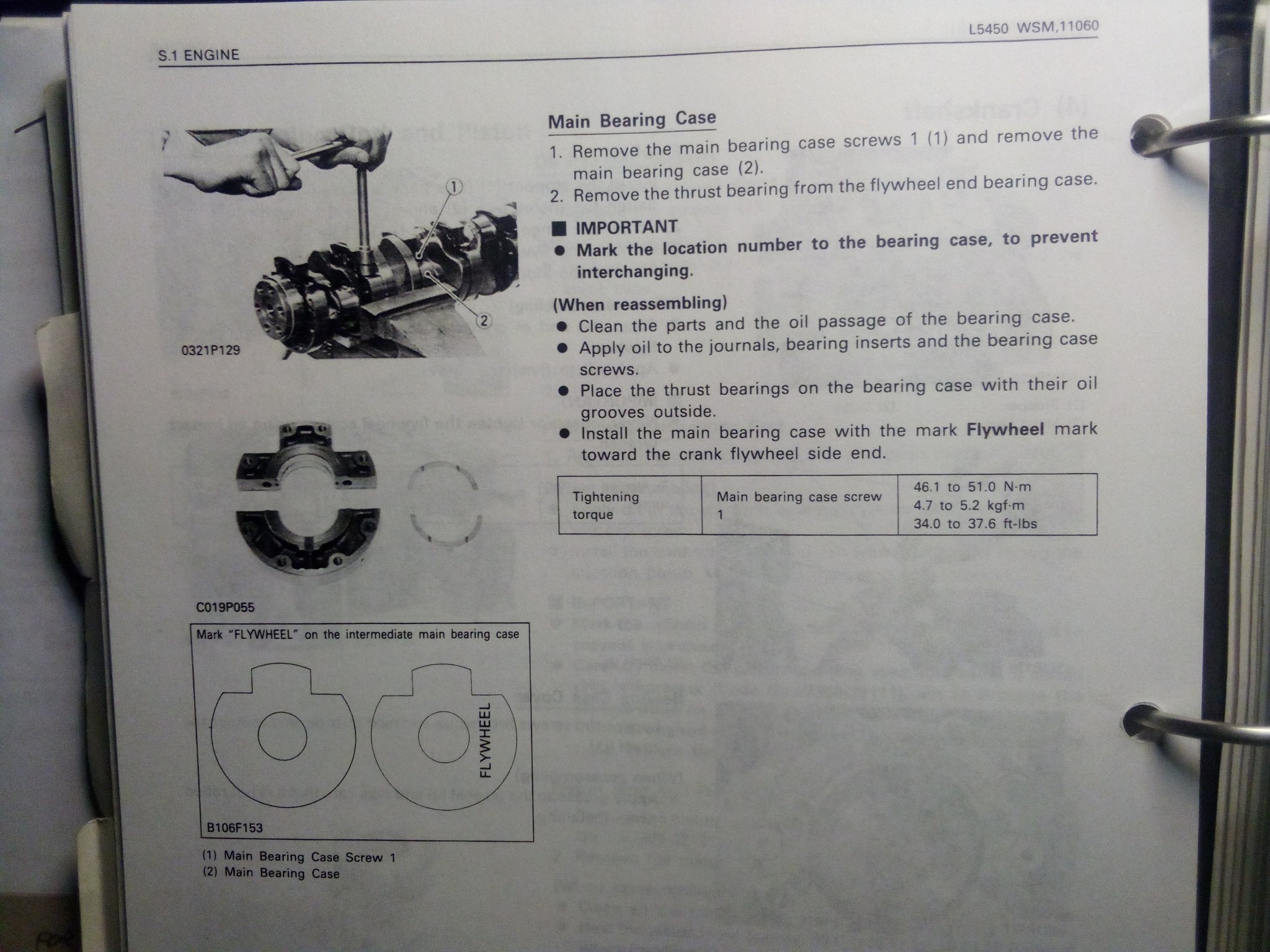

I'll add a couple points - the two diagrams above don't really show how Kubota 5-cylinder engines are built. The drawing below is from my L5450 WSM which has the F2803 version of the 5-cylinder layout.
Notice that at the back cylinder (No 5) the crank has thrust bearings on each side of the connecting rod. The purpose of thrust bearings on cranks is to counteract end thrust in applications where there's some axial force - like from a clutch release mechanism. I wonder if the marine clutch/gearbox in this case exerts some thrust on the flywheel ?
Thrust bearings on cranks are polished rings, bronze or stainless steel. They are like the journal shells, in two halves, maybe bolted together around crank. Since they are well oiled, running in an oily environment, they almost never act up. But in 6000 hours a lot can happen - like low oil, contaminants, etc. Once they start deteriorating, the journal bearings may get worn from debris in the oil. That might lead to the crank knocking at that end when the cylinder fires. Disconnecting the fuel to that cylinder might reduce crank deflection and reduce the knock.
This is rank speculation, not experience - but it is a plausible line-up with the symptoms.
Replacing crank bearings is a big job - engine taken out, disassembled, crank goes out the back end of the block. The bearings themselves are not likely to "jam" or wedge, causing the engine to stop - but anything coming apart in the bottom end is never beneficial.
Hope more grey beards chime in on this one. Best luck - Dick B.

I already changed the injector with a new OEM one and the old one looks quite OK to me (1500h since the last injector setting check).
