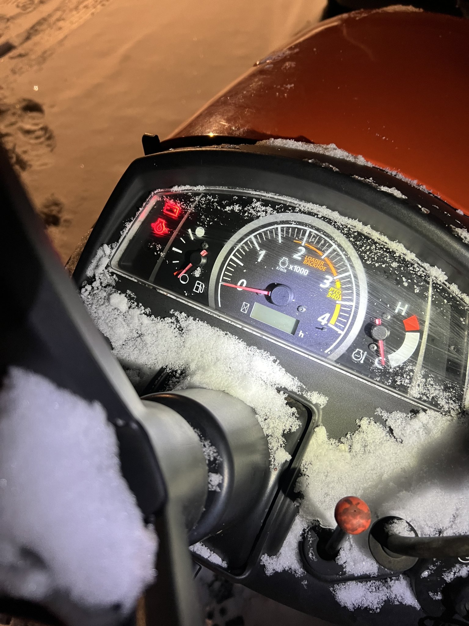

I have a Kubota BX23S that I used a couple days ago to remove snow. It was working properly with no issues. I went to try and start it today and it would not start. It doesn’t even make an attempt to turn over.
When I turned the key on the battery and Engine Oil Pressure lights turned on but the glow plug and hour meter do not. Also the headlights, turn signals and hazard lights do not work.
I double checked all the fuses multiple times with no luck. I also tested the battery and it had approximately 12.6 volts. When I do try and turn on the lights the voltage does dip a little bit.
Does anyone have any idea what it may be? I tried to check all the connectors and they all seem to be connected and snug. As I mentioned it was working fine two days ago so I can’t imagine mice or another rodent got to it.

Although I checked each fuse and they looked fine I was just going to go ahead and replace them one by one tomorrow and see if that worked.
When I turn the key the gauges do not go up and back down like they usually do. It’s funny because when I turn the key very slowly to the off position from start the glow plug light will flash on for a millisecond. No clicking or anything else when trying to turn it on.

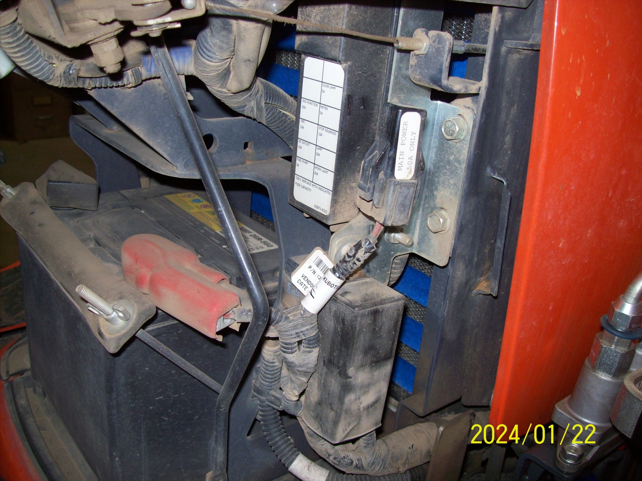

Behind the battery, you will find another fuse, and that is the one that has blown. It is a larger fuse, and I think it is a 20 or 30-amp fuse. I had the same problem and went crazy looking for it to no avail. It was the dealer service department that told me where to look and sure enough there it was. I have a cab on mine, but I don't believe that there is anything different without the cab.
12,920
5,647
Hmm.. if Dusty's referring to the main 'slow blow' fuse, it's a 50 amp. Maybe it's not in properly ? it can't be blown though as 'batt and oil' lights work. If it blows , NO power to anything..except starter mower
I can't tear my tractor apart, currently missing left rear but ASAP I'll look into it.
Still a head scratcher.

Yeah I’m going to try and pull it into the garage tomorrow somehow. Hopefully it can sit overnight and defrost. It’s been in the 20° here so maybe there’s something frozen on it is what I’m hoping.
Bought all new fuses and I’ll test them out and recharge the battery and check all the connections. I checked all the grounds and spoke with Kubota service today. They gave me a few suggestions (center the HST pedal, check ground connections on battery, etc). None worked but I’ll figure it out eventually.
It’s just much easier to do inside vs outside in freezing temps, in the dark with wind whipping in my face.

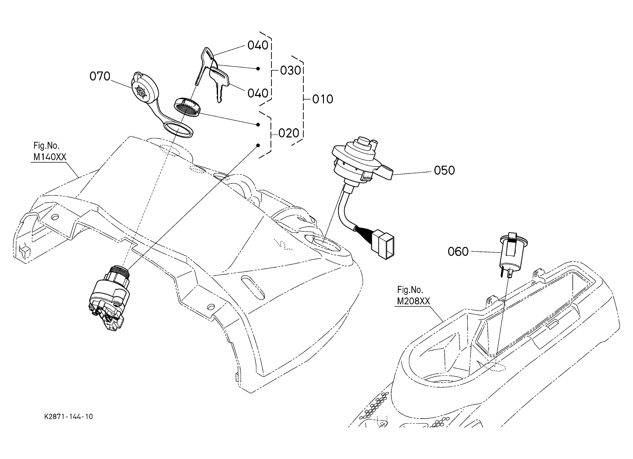

There's more wrong than just 'won't start'. The dash doesn't 'light up' as it should ! Hour meter ,dead, gauges, dead, headlight, blinkers, all dead.
There is something 'weird' going on as the fuses all seem to be good.
I suspect maybe a bad ignition switch.
IF it was 'easy' to remove,(usually unscrew trim ring on top, push switch through hole,disconnect wires ?) I suggest remove it, bring into nice warm house,use hair dryer or leave on register,spray WD40 in the key slot,cycle key a zillion times, test on bench.
BTW... The WSM does show/tell how to test it
new switch is $120 Canadian...
Hay !!! there's a cover for it #070, $11
