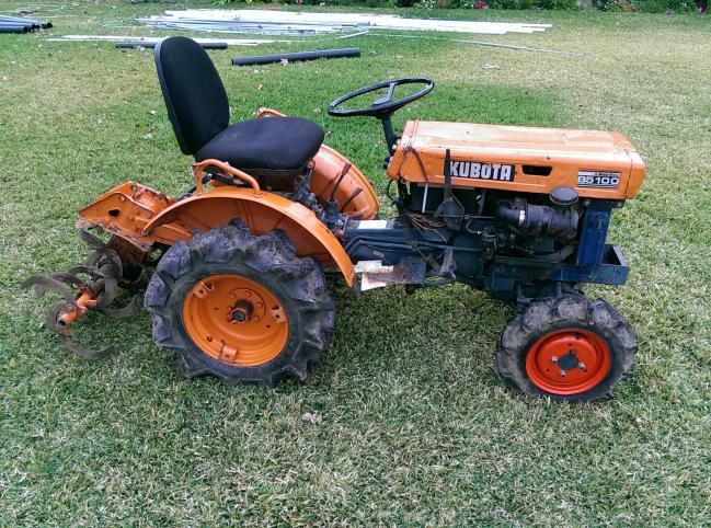

I own an older Kubota B5100 4WD tractor that I use for rototilling my garden every spring. This year I started it up as usual and raised the rear lift, drove it over to the garden area, and lowered the lift. However, after I lowered the lift it would not raise again. There is no power on the rear lift now. I can pick it up freely but nothing happens when I move the control.
My first thought was to check the UDT fluid but that is topped off already. Also, all the other functions work fine (gears, speeds, rototiller, etc) just the lift has a complete loss of power.
Any idea what could be causing this? :confused: Thank you in advance!
