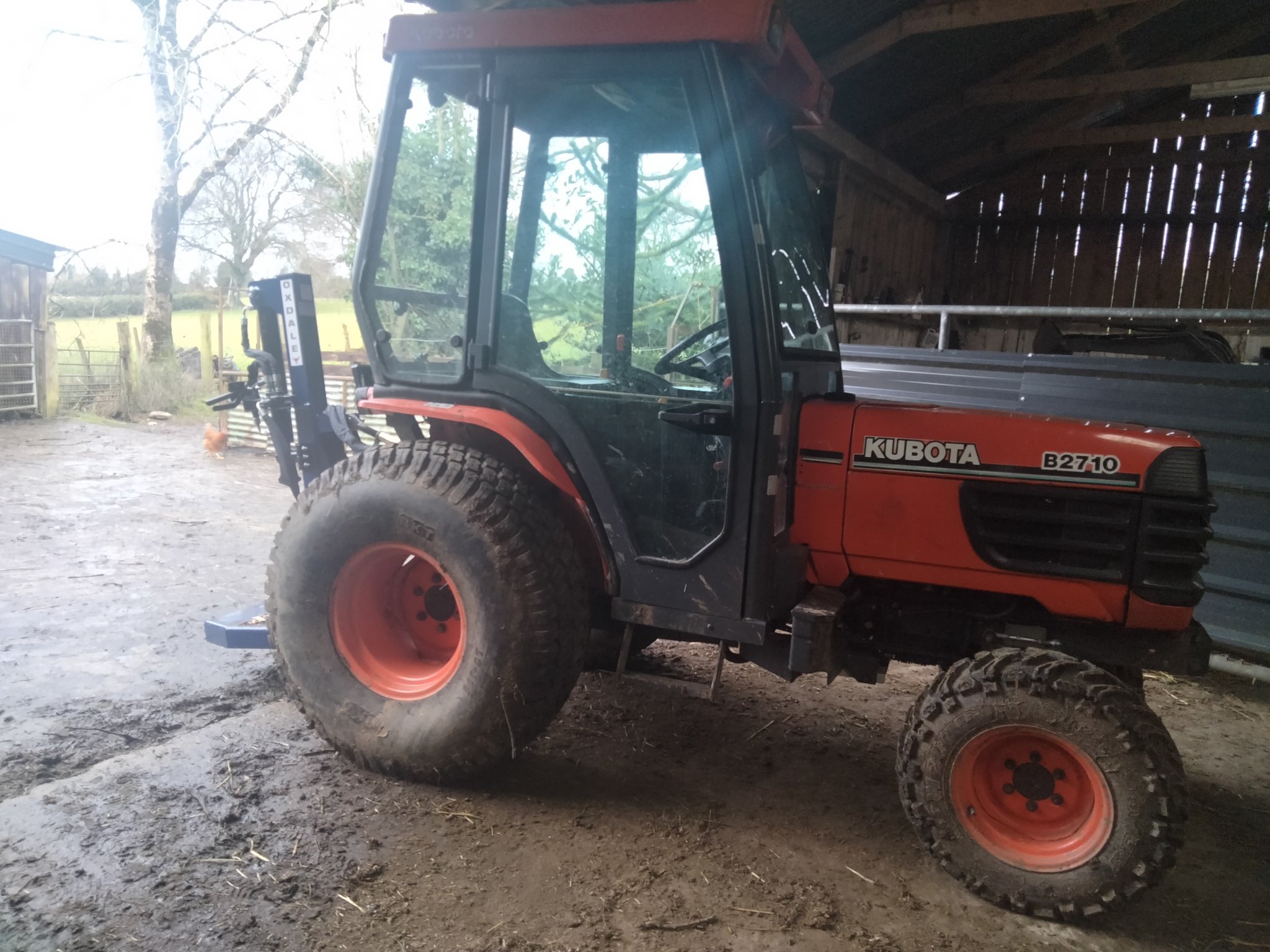

Hello folks ,
My first post here .
I've a b2710 with 2000 hours runs well . I've just acquired a little 10ton log splitter which I've simply plugged in to a 3/8" spool on the rear which is fed off a distribution block above the rear axle right side.
Working reasonable well . Have i connected to the correct port or is there a stronger port outlet . Any suggestions please .

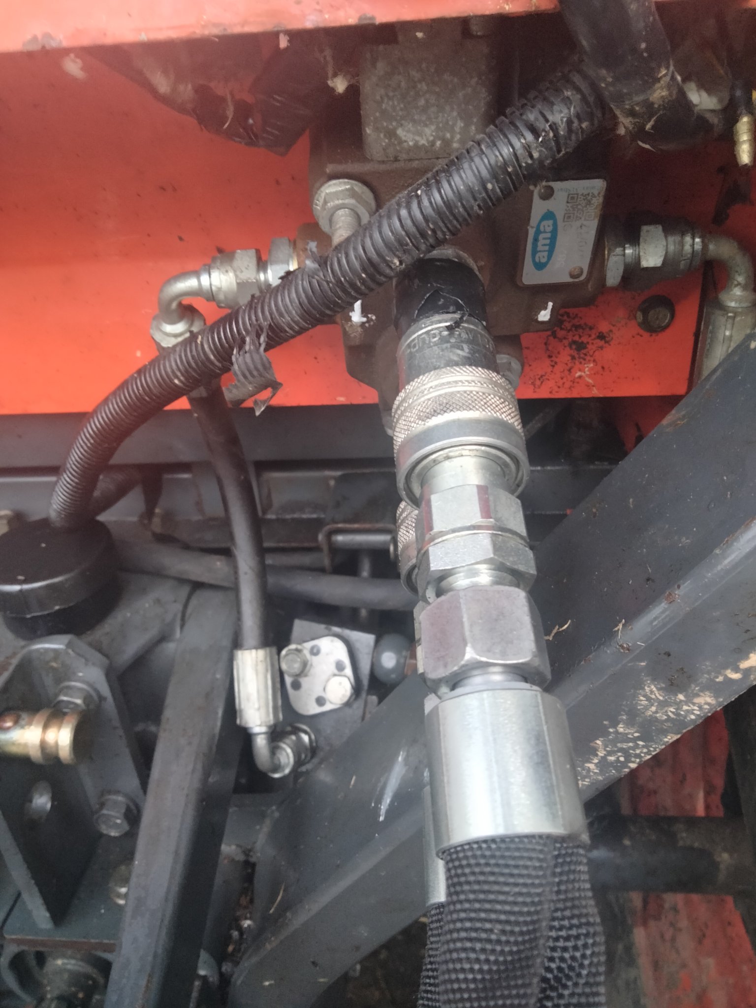

The port I'm using is shared with the mower deck line by two Bangor connectors. Looks like a factory installation, it's so neat . I have to raise the mower deck for the log splitter to operate and bungee the spool lever . I was hoping for a direct connection point.
Now we are making progress.
I am not familiar with how that mower deck is plumbed but the answer to your question is NO - that is not optimal.
From what you have said so far it seems there is another valve on the log splitter that controls the splitter - correct?

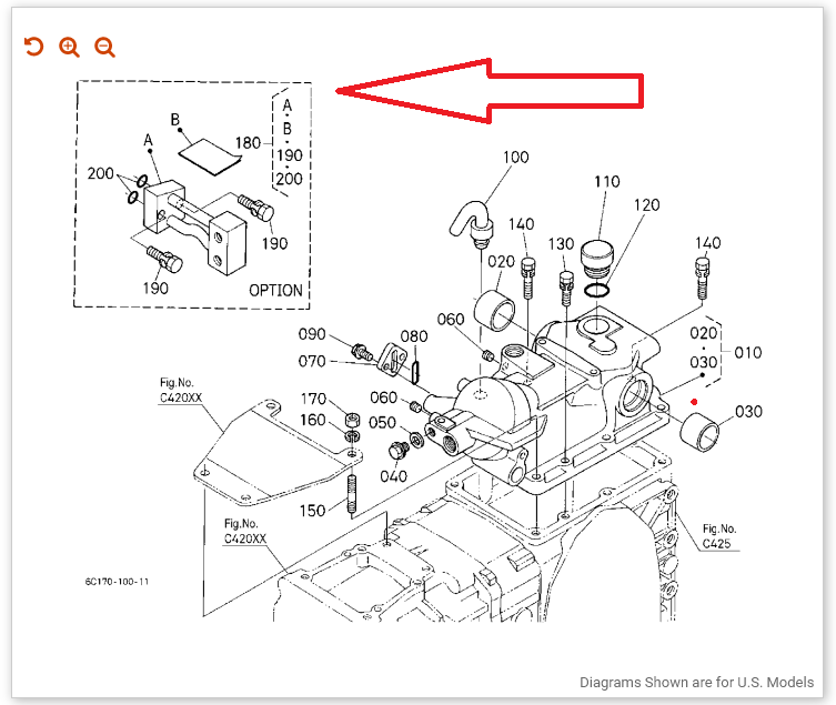

If you think I am headed to the outlet block up front you are correct. I did some more parts browsing. Does this look anything like your "block"?
That doesn't look familiar to me . It's almost midnight here with a storm blowing , I'll do my best to forward photos same time tomorrow . Appreciate your assistance.
33,390
8,703
I think the Tuskar needs to post some pics of what he's working on because EU tractors are not setup the same as US tractors.
