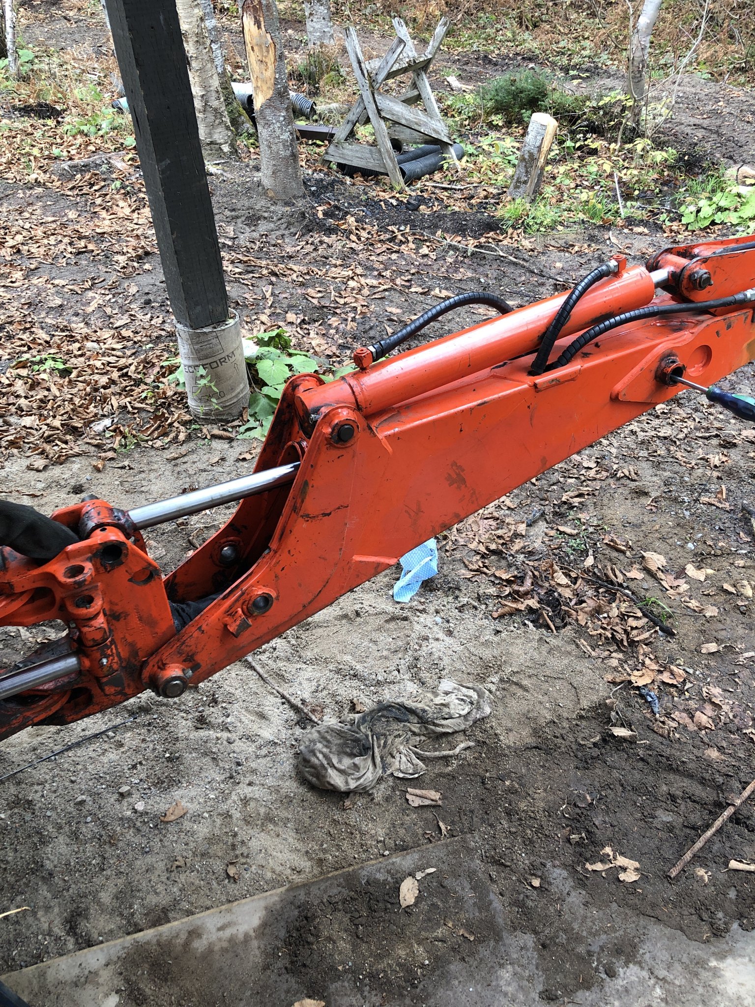

Kubota b21 and backhoe bt751 how do I remove boom cylinder if I want to replace seal kit
Serge
Kubota b21
Sep 5, 2020
35
I don’t know how to remove the boom cylinder it should have a trick Also how to disconnect the hoses
.anybody can help

raise the back wheels of the tractor up as high as you can leave front wheels on the ground
stretch the boom out as far as you can; I actually take the dipperstick off usually and let the boom fall to the ground
remove the boom pin from the main frame
use hydraulics to suck the rod in then shut the engine off, work the boom lever a few times to relieve any pressure
remove the rear boom pin and then reach in & pull the cylinder out, then disconnect hoses.
there's other ways to do it but that's the way i did em

Thank you so much that give me a general idea how to do the job

On mine I extended the boom full like lugbolt said, but found rotating the backhoe full to one side made pulling the cylinder out easy. Not sure I would have been able to pull the cylinder out if the boom was positioned directly behind the tractor...unless I dug a ditch so the boom would angle down at a greater angle. (that idea just popped into my head now...:))
Also, note the orientation of the cylinder and put it back in the same way it came out. I faintly remember that I did not do that, and had some interference preventing me from getting a pin back in at the stick end, until I pulled it back out and rotated it to the other possible orientation...
