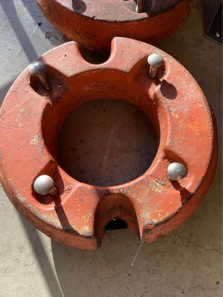

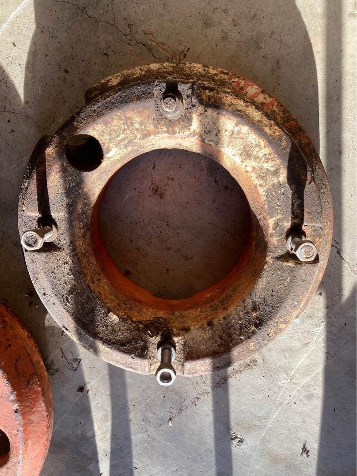

This is the description of the ones I saw for sale:
"Bolt holes are 10.5” center to center; inner hub diameter is 13”; overall outside diameter is 15.25”. ~120lbs each; 240lbs for both."
Attached are the pictures that accompanied the ad.
Apparently some Wheel Horse tractors, large frame Bolens, and I know the the MTD 990 garden tractors had 15" rear wheels so that's another avenue to look into. They do not have the large clearance hole in the center, though. Weights from a Case 444 may fit, they ran 16" wheels, but they are also solid center weights. .

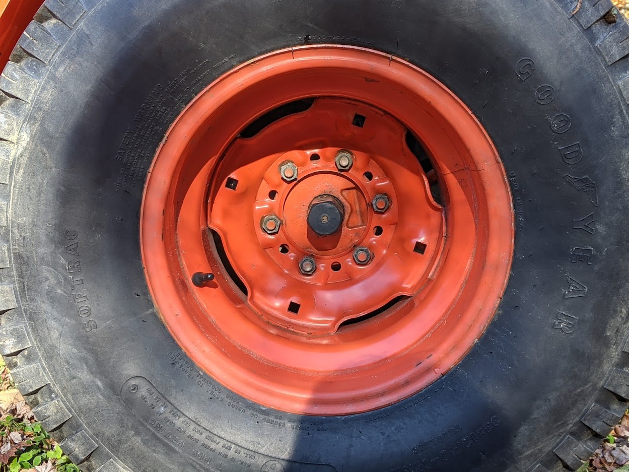

They look the same as the ones on my B7500. I would say those square holes are absolutely for wheel weights.
Not sure if there is clearance on these, but I know that a lot of the 12" garden tractor weights that have a big hole in the center of the weight are made that way so that you can remove the wheel and mount them on the inside, with the axle sticking through the hole. Then, if you want to add more you can use 2 of the holes in the wheel to mount a set on the side of the rim facing in and the other two holes to mount a set of weights on the side facing out, or use bolts long enough to sandwich the wheel between the weights.
I suppose I should have attached a shot of my wheels:
