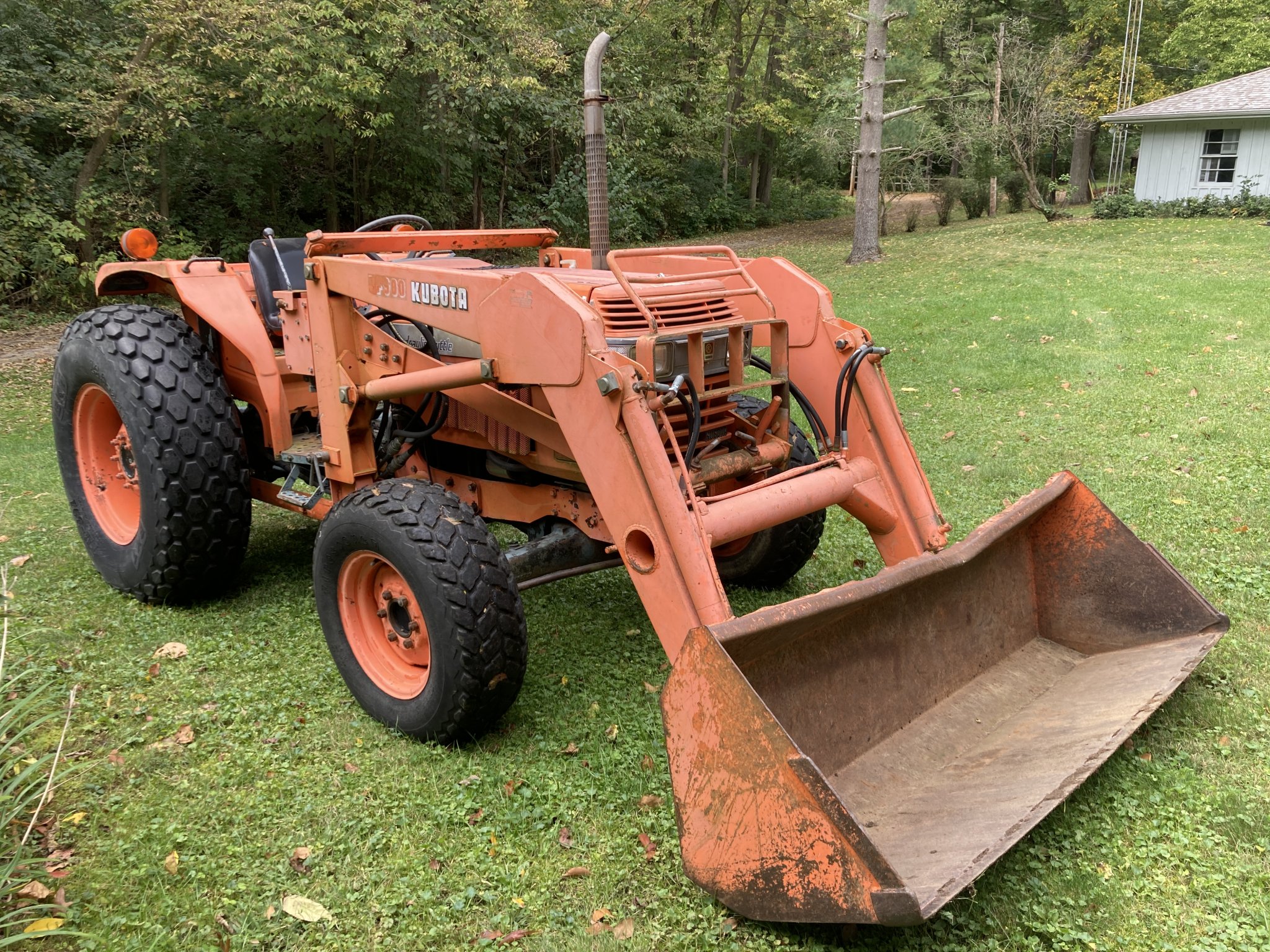

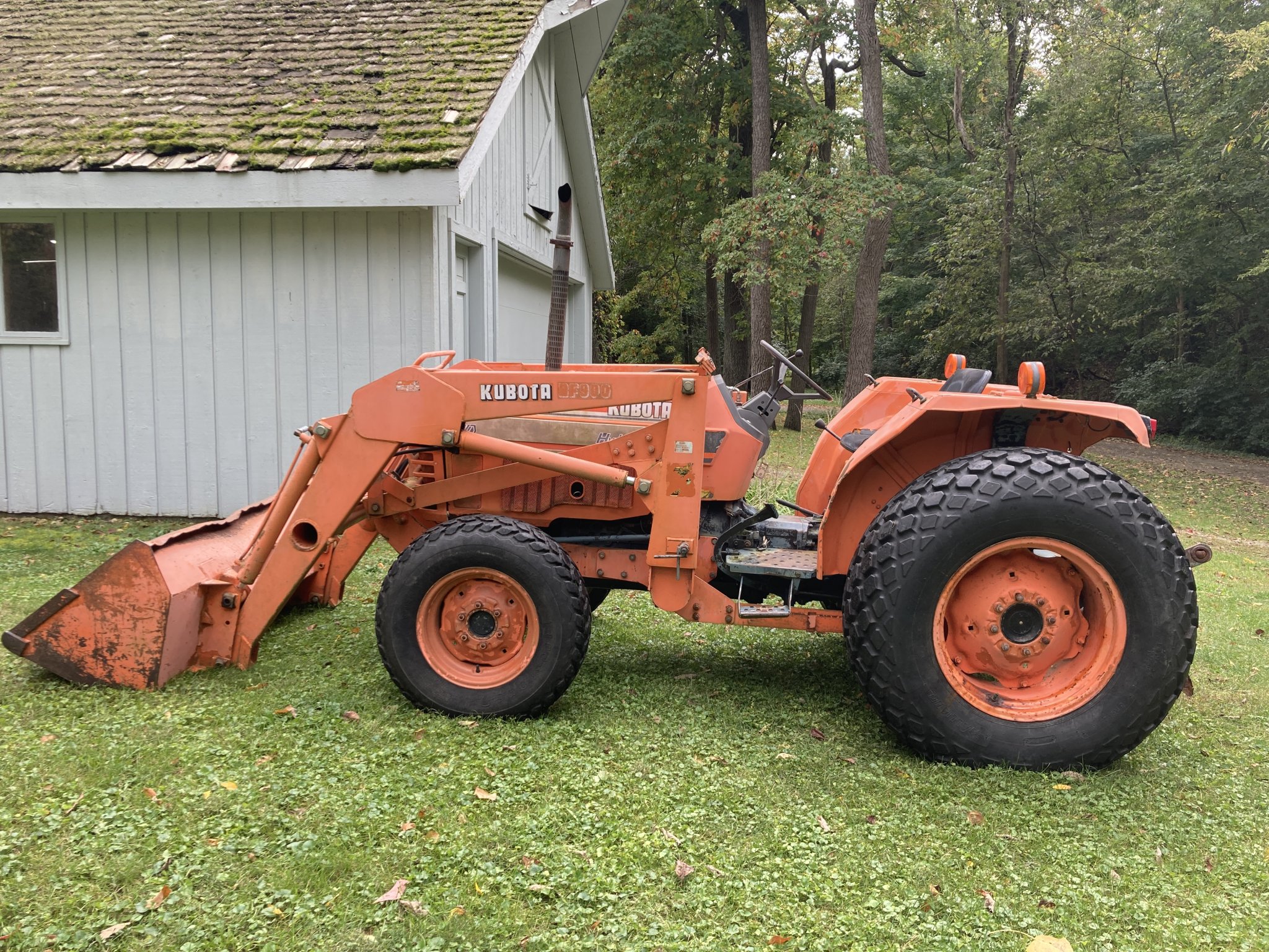

I just bought my first tractor. 3100 hours. Previous owner spent about $3,300 at a shop recently fixing various things and putting all new filters and fluids. It operates very nice. My goal is to have it to use around our 4 acre property helping out with landscaping, wife’s gardening and moving logs and lumber around a bandsaw mill. Is there anyone on here with this model of tractor who can give me advice about owning it? I have a few questions:
What attachments are able to be used with this tractor? Are they fairly universal? I am looking for a set of forks for moving logs.
Also I am in need of some replacement parts. One headlight lense is broken. Are these Kubota specific?
Seat needs replaced…can I find one to fit this tractor or do I need to go a more generic route?

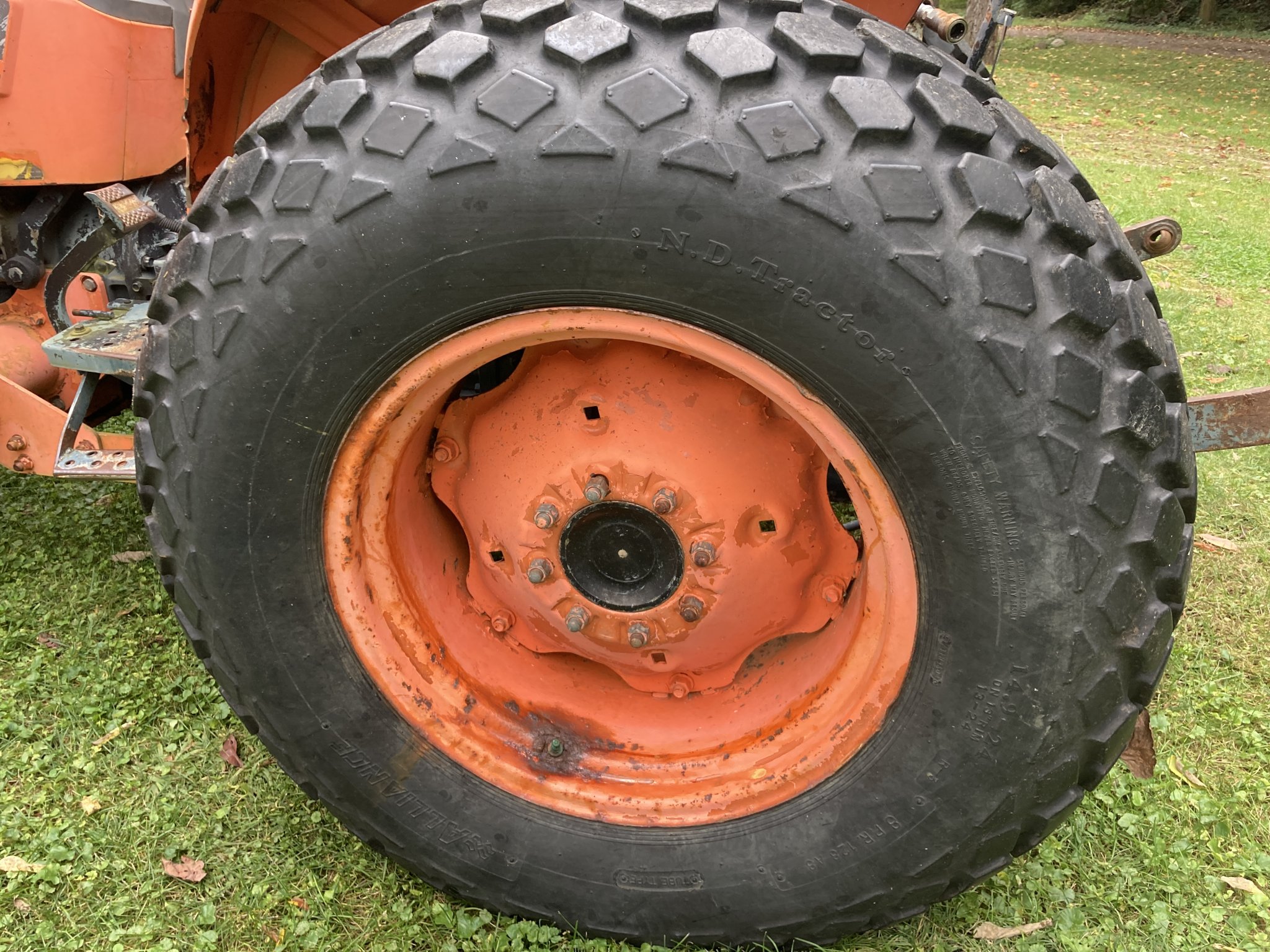

Finally, one of the rear wheels seems to have a lot of corrosion around the valve stem. I’m thinking the rim needs replaced. Where is the best place to buy one?
Thanks for any help!

The rust around valve stem may indicate filled tyres now or in the past.

It’s likely that your tires are filled with calcium carbonate mix, which is a good weight ballast, but is highly corrosive. After replacing your wheels, there are several liquids that are currently used that are non-corrosive: Rim guard, bio-ballast, window washer fluid, or antifreeze added to water. Good luck with your new project.
5,230
3,389
If the tire isn't leaking wire brush it and paint it, might last the life of your tractor.
Rather than just bandaiding it, and later getting surprised with having to hunt for a long out of stock rim, I would be proactive.
Take the wheel off.
Have a tire shop pull the tire off the rim.
Sandblast the rusted area.
Apply several coats of marine grade 2 part epoxy to the damaged area.
Prime with OSPHO, and repaint the rim.
Have tire shop remount the tire.
Live a long, and trouble free, tractor wheel life.

Leave the back tires alone, the tires will be welded to the rims.
Trying to break them down for repairs will surely destroy the tires.
You have a non standard set of tires and more than likely non standard rim sizes too.
that tractor did not normally come with pillow block tires (Old style turf tires).
If it's not leaking now, plan on buying 2 new rims and tires to replace them.
You'll need to get new rims and tires, and those tires are long obsolete so you'll have to go with a newer size and style.
