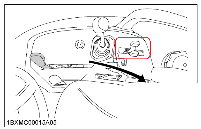

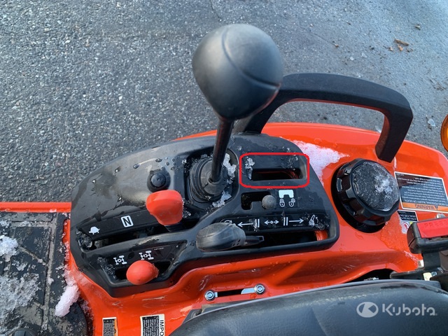

In the manual, there's a place for two additional control levers. What do those levers do? I don't have them on my tractor.

empty slot where those levers would be

Those WOULD be the 'dual rear remote' levers.....they'll control two ,double acting cylinders, 24/7
If I keep my BX23S I'll add them instead of the '3rd function' kit.
BTW, I'd sure love to know what the dealer was saying !!!
5,137
3,821
I got a copy of the installation instructions for this accessory, and to use it on the BX23S will require scrapping the hard lines that come with the kit and using rubber hoses and relocation of the remotes to the outside of the ROPS instead of the inside of the ROPS as intended by Kubota. I wonder why Kubota didn't make a separate kit to use with the BX23S? Possibly landPride will come to the rescue and design a similar kit with hard lines for the BX23S?
