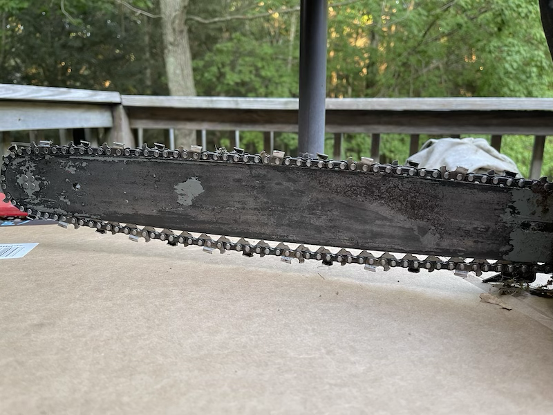

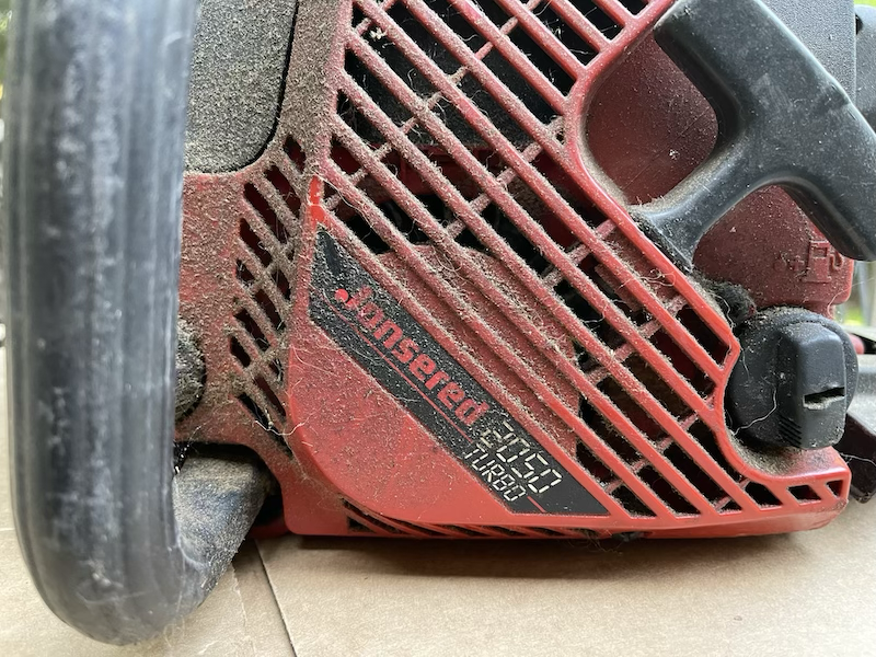

I am in the planning stage of refurbishing my Jonesered 2050 Turbo chainsaw and have posted some pics here; I'm interested in user advice or suggestions for this small project.
I've owned it for over 20 years, but haven't used in the last ten; during that time it has been stored un-fueled in my garage. Owner's manual is (for now) MIA. It's got an 18" roller-tip bar and is basically completely 'stock' other than it's 3rd chain & 1 spark plug. I haven't tried starting it but I'd bet that it probably would. I'm also interested in suggestions for related chainsaw forums to lurk for additional info.
I considered just buying a new Stihl or Husqvarna but haven't researched that yet. I'd like to install a new 16" bar with 3 new chains and am seeking advice from knowledgeable members on this plan tempImageb6vxdg.png tempImage6yHnNe.png tempImagetJrJvx.png tempImage2Xlalc.png . I'd also like to hear from members on specific procedures for disassembly/reassembly and what new parts might be advisable. I'll probably re-use the original muffler (rusty but intact), new spark plug, etc., etc. Thanks in advance for any help! (y)

Not one of Jonsered's better saws, it seems. Might not be worth putting much effort into it. But if you can get it running easily, why not?

It is difficult to get parts for a 10-year-old saw, and trying to get them for a 20-year-old saw is going to be difficult. I purchased some spare parts for my Husky while they were still available. The dealer that I bought them from has asked me if I would be interested in selling them back to him since he hasn't been able to get a lot of parts to repair the saws that come through the door. He takes the old saws in trade and sells them a new saw, and then cannibalizes the old ones for parts to fix other saws.

Wouldn’t surprise me if it ran. The one thing I would be concerned about is the diaphragm in the carburetor being dry and stiff and not pumping fuel.

This saw has less than 30 hours of use so it's a decent candidate for refurbishment. Not really looking to 'rebuild' it, just clean, inspect and get it up and running. :)

With only 30 hrs. run time....you should have excellent compression on the saw still.
Just disassemble the housing to a point that will let you reach everything that needs cleaning/inspection. Clean it up and run it.
