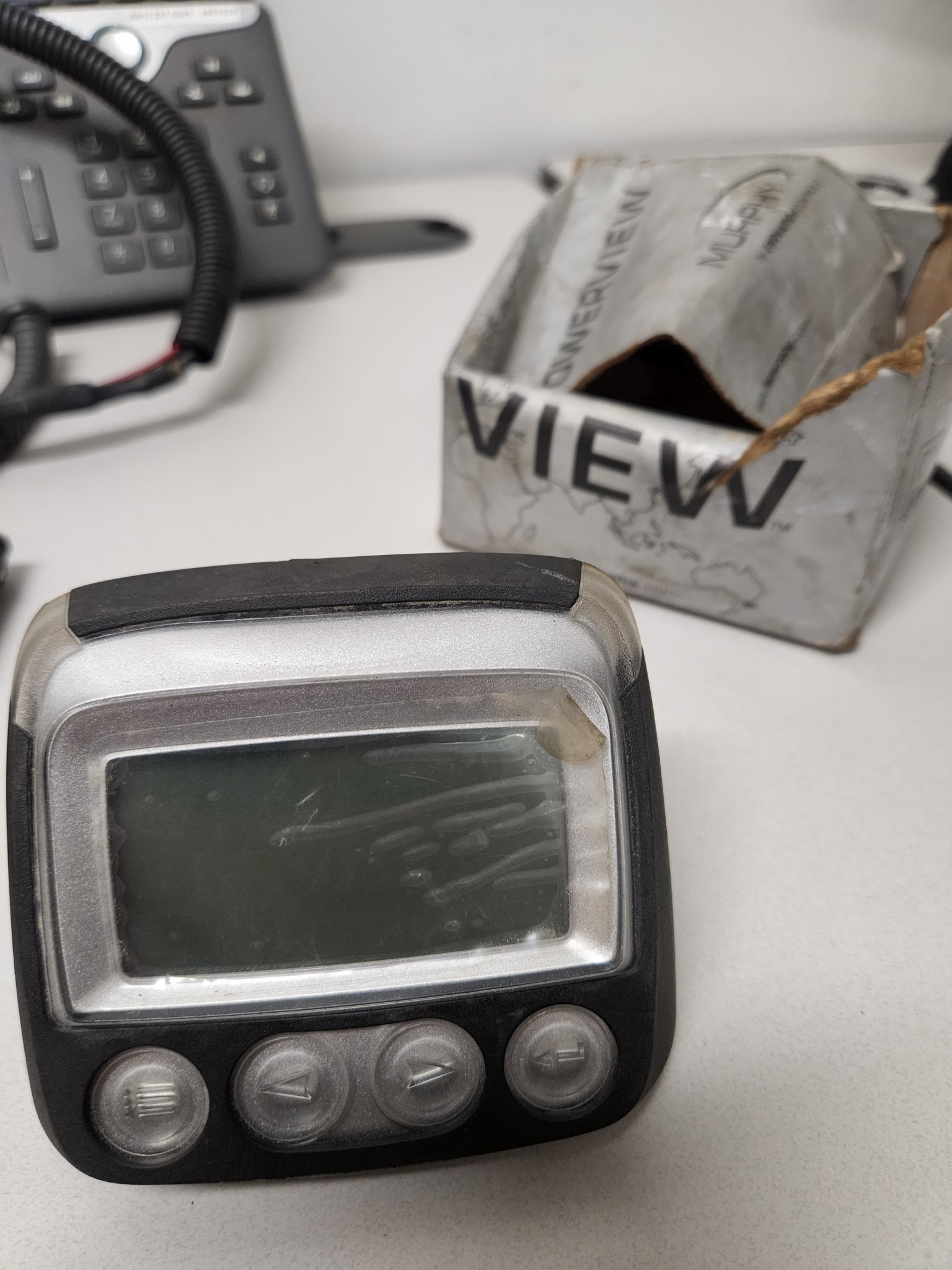

You can actually get jd's software. It's the annual $1800 licensing fee that gets you.
JD has a little diagnosing box that you can get. Plugs into the same port that the techs computer plugs into. Runs around $500.00 (10 years ago).
You can read codes, engine hours, real time oil pressure, temperature, and a few other things.
Part number is RE555553.
Not sure if the jumper harness comes with it or if you have to buy it separately. Probably separately. I checked the harness and couldn't find a part number.
I actually use that box more then the computer. If you got the code, you can Google it and get a pretty close idea where to look.
Supposedly this box will read engine codes for other makes and models if they have the same deutz connecter.
I keep meaning to meter out the plug on some of my Cummins and deutz engines to see if the connectors supply power, signal, etc to the same pins.
Boss might be a little upset if I burn up the box just hooking it to another connector 🙄🙄🙄🙄🙄
The really handy part about the computer though is the real time monitoring of the sensors. So you can do a cold read on the sensors if you have a temperature sensor that you think is wonky and compare readings across the board. If one is reading 30 degrees higher at room temperature, then you found your culprit. 20220323_105209.jpg

That's just a panel view and not a real code scanner. John deere went full on cloud based years ago. It was quite a challenge when you were in areas that didn't have internet coverage.
The programming of the ecm was also more then just the tractor serial number. The configuration files include but are limited to injector trim codes, fueling maps, power curves, emissions parameters ect. The equipment needs programming to even work.
Although I highly disagree with the practice it's been common place for some time now. They typically use epa regulations to stay out of trouble as nearly every thing is covered under tier 4 emissions, and because of that a certified technician is technically the only one that is certified to work on the system. Every time the tech logs into their computer it is recorded and deere/ epa can access these records ro see what has been done. It's mostly a liability thing.

I didn't say it was a scanner. I said you can use it to read codes. Which will get you in the ball park. Plus you can see what the engine temp, oil pressure and a few other odds and ends.
If you don't have the ability to find out what code it's throwing on a display on the unit. Then that little box is handy as the Dickens.
And 90% of the time it's just a sensor giving grief. Which the end user can fix. Since the code will self reset once the issue is fixed a sensor swap is all that's needed most of the time.
The exception is emission based where it requires a serial number, part number, ect.....
As far as deeres cloud based software. You can have access to it for a measly $1800 a year. Plus the class. 😉😉😉
Even with it being cloud based, you still need a substantial file download on the computer, and periodic updates.
There is aftermarket software out there that is available if you want to pay for it. And it's pricy $$$$. Plus a yearly licensing fee as well. I've actually had a chance to compare the aftermarket software with Deere side by side in a classroom setting.
You can use it to replace an injector. Reprogram an ecm. Reset/ replace your DEF sensors, and will handle the particulate filter swap/ after market/ or hae been cleaned options. Plus real time monitoring of sensors.
