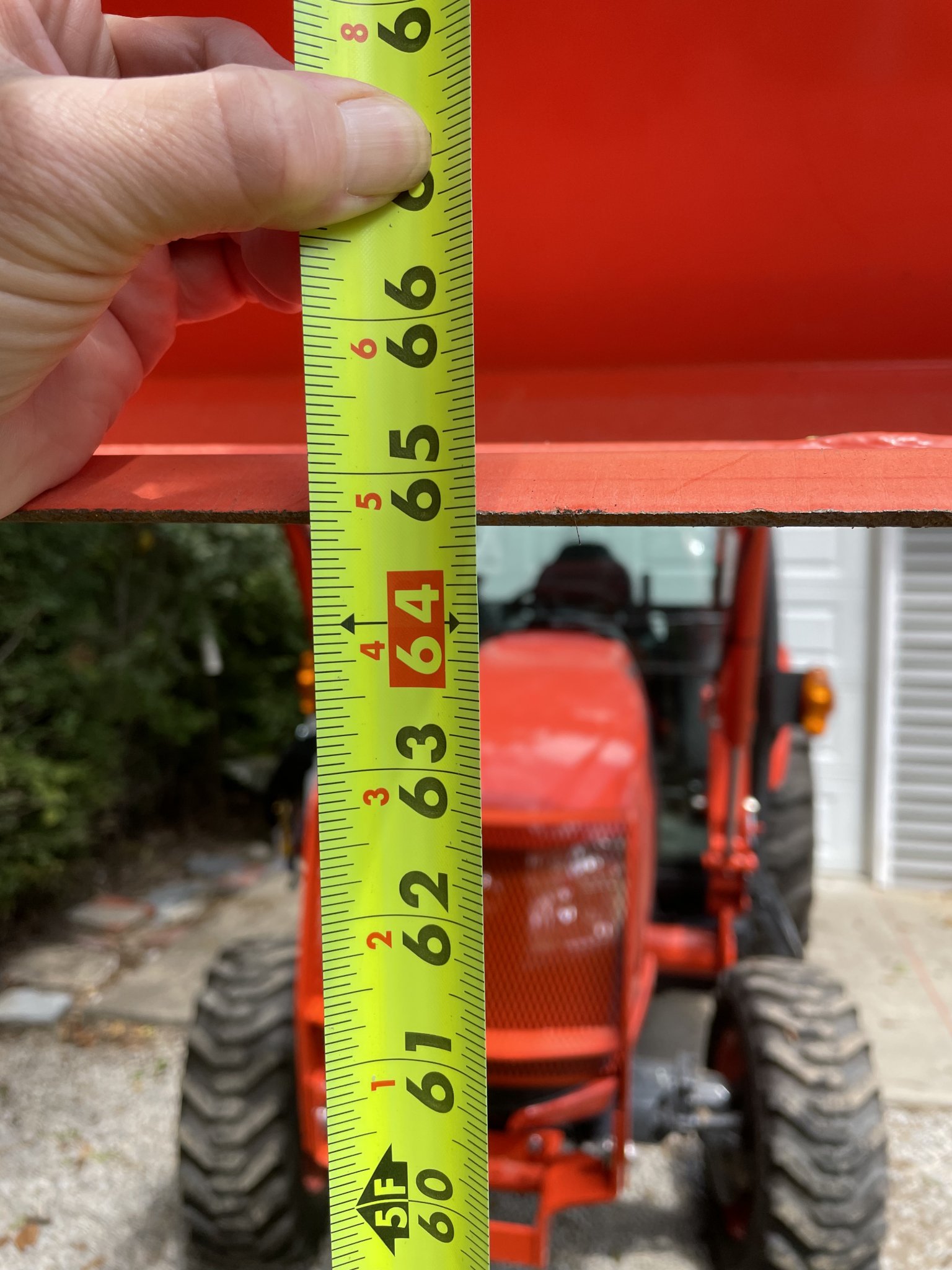

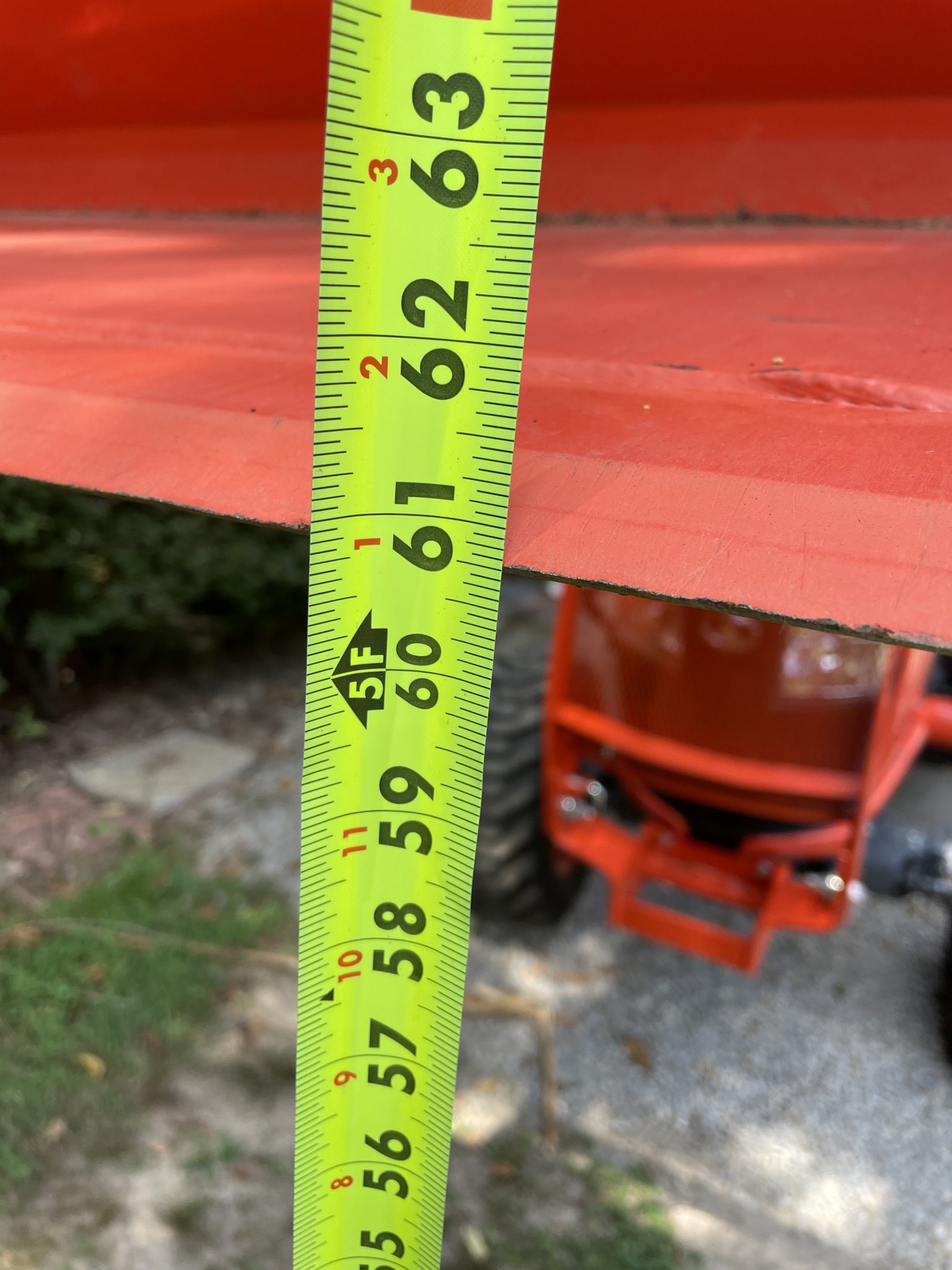

I have a kubota Grand L 4060, the hydraulic on the bucket falls 8 inch in three hours and the dealer saus that is normal ,it’s within factory specs, please help me
