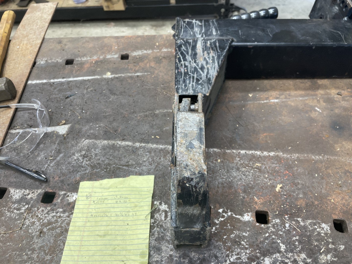

It took 10 years to bust up this Agri-Supply Quick Hitch; it took a couple hours to fix it.
Before:

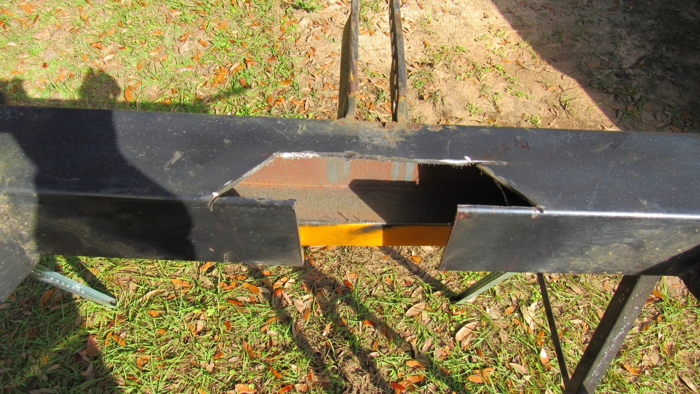

After about 5 minutes using my 22 ton Speeco/Huskee log splitter to strraighten eveything out:

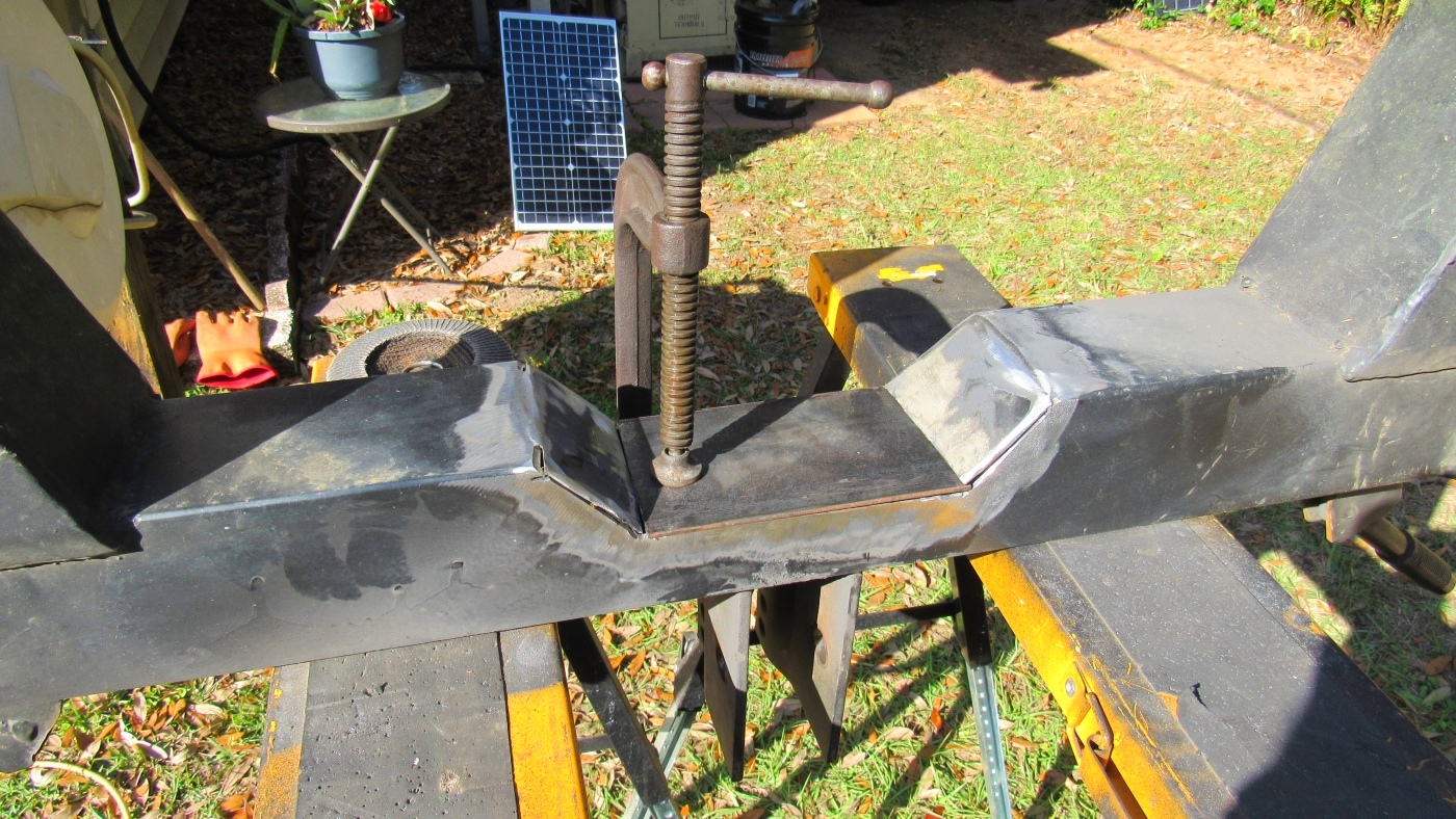

And then reinforce it using mostly bed frame angle iron and test coupon material from the James Lincoln Foundation (Lincoln Welders):

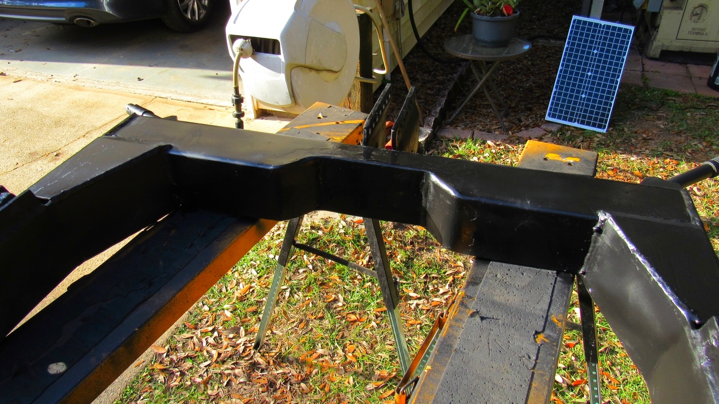

After an alcohol rub cleaning and painting:
