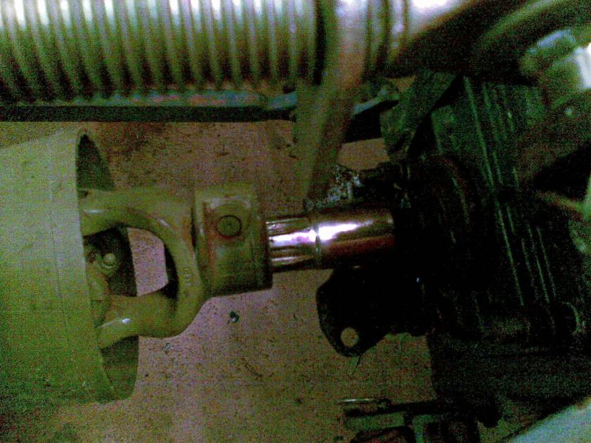

Here are some pictures of my slasher I run off the standard b6000 pto - it runs perfectly. When I brought the B6000 it was a tiny 2ft thing. Anyway I modified and re-built it to just under 4ft. The pto connections etc are all standard 1 3/8' Its just that it cuts in the opposite direction.
Anyway all of the small Australian commercial slashers will hook right up to the b6000. You just may need to flip the cutting blades. The reason I rebuilt mine was because of cost - not that I couldn't buy an off the self one.

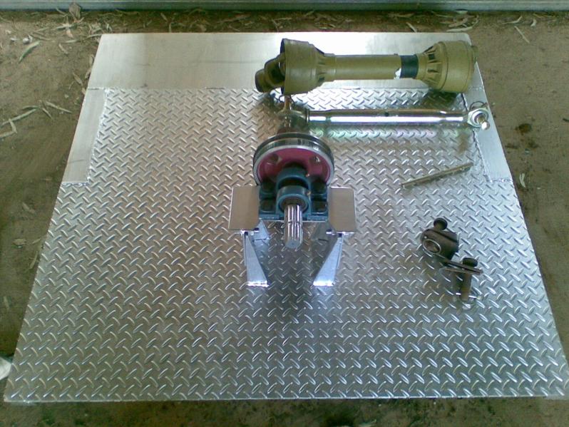

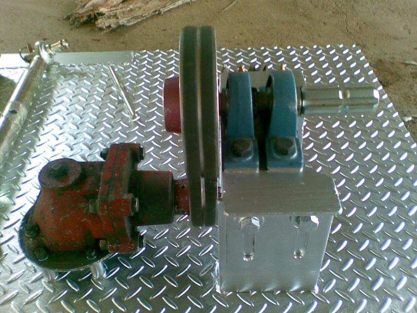

Hi Greg
I probably wouldn't bother building one but if I did I would do something like in the attached pictures - hope they come out all right. basically use a v belt, and a couple of pillow bearing mounting blocks to hold the shafts.
Cheers John

Nice drawings TopGear. I wonder if there is a simple modification in the tranny, that can be done to reverse the rotation?
