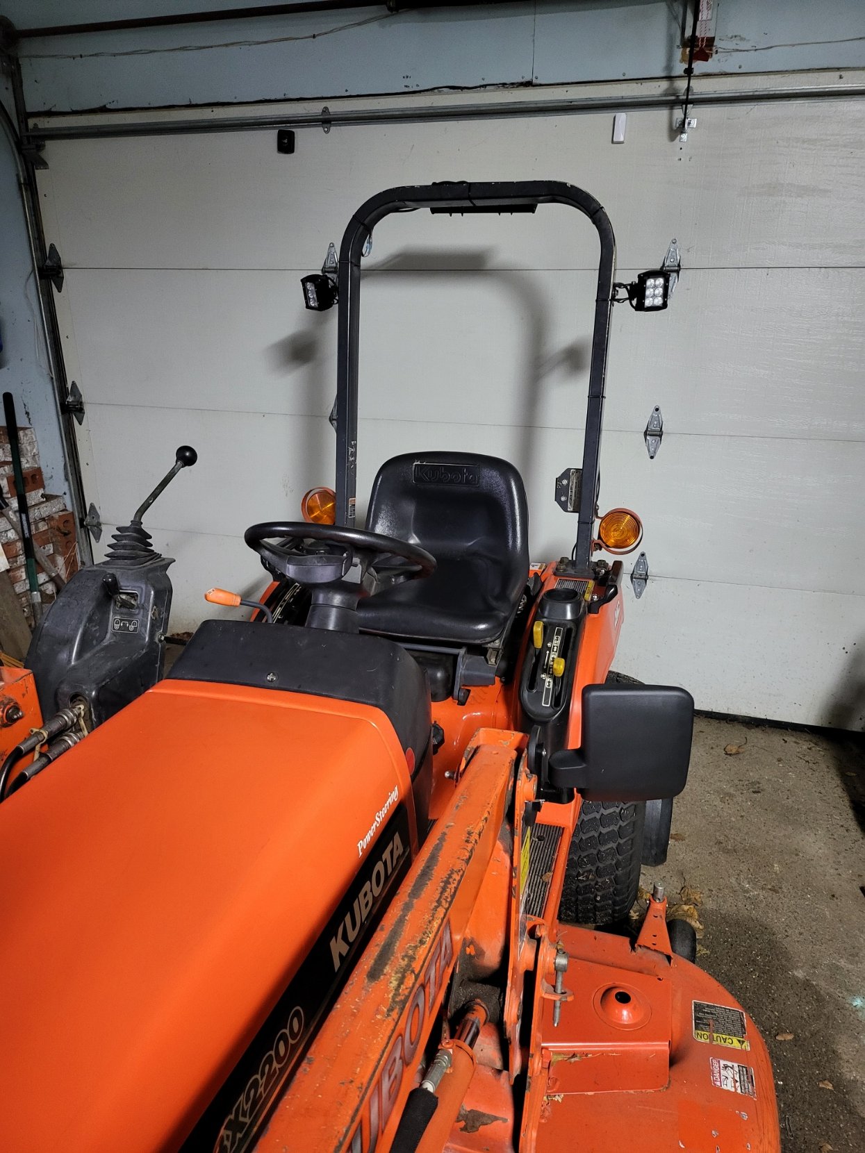

I have a 02 BX2200 with a loader and mowing deck. Mostly use it to move picnic tables around and clean out burn pits. We are planning on adding to our garden this year with a 24'x70' area, and maybe a small 1/4 acre food plot for some deer the following year. The areas are all currently mowed grass with minimal roots.
Is it worth trying to mess with a 3 point rotary tiller to add to the tractor, or should we be looking at something more like a disc. the BX2200 is on the small side of tractors so not sure if it would run or pull something wider then 4ft. Thoughts? Suggestions?
