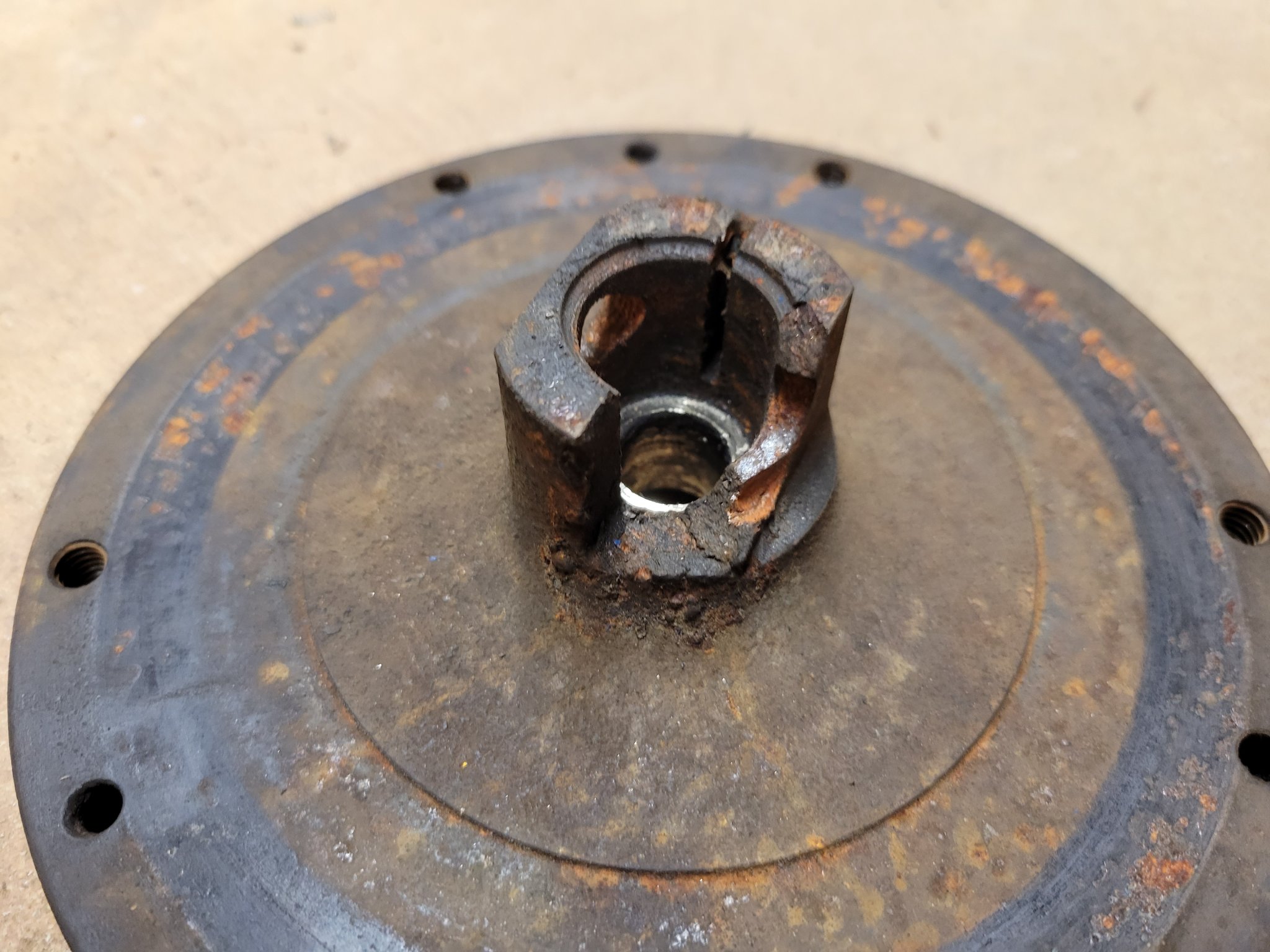

Well, took some of the tractor apart today to what was wrong with the clutch.
Found out what was wrong with the clutch. The clutch plate/flywheel was busted and the hole for the input shaft is elongated. My understanding is this is a cast part and was just another weak link of the tractor.
Someone let it wear out then they tried to weld it over the clamping portion. Not good.

Check out Hamiltonbobs.com
They carry lots of parts for the 154.
I believe this may be the piece you need.

That is the part I need. Also need a new bolt too. So far it's promising and has good compression. Can't start it till I fix the tyranny hyd return line.
