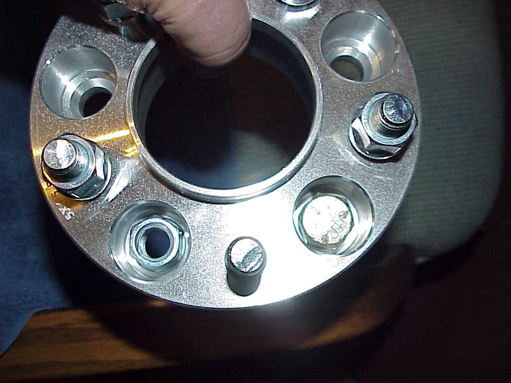

I am going to be installing 1 1/2" spacers on the rear wheels of my BX23S, and was wondering if I should purchase 3 additional studs like the 2 that Kubota installed on the rear axle, or should I use Grade 8 full threaded bolts, like I did when I put spacers on my old BX22. I was thinking that the 2 studs that are already installed might not be strong enough to hold the wheel even when there are 3 additional ones added and that the grade 8 bolts would be stronger. What are your thoughts? Cost isn't a factor, since they are about the same cost.

I am questioning the strength of the Kubota studs being used without any of the Kubota bolts. The clearance is very tight in the hole where both the nuts and the bolts go on the spacers. Possibly this picture will give you a better idea of the clearances for getting a socket onto the bolt vs. the nut.

I spoke to a friend today that is a mechanical engineer, and he said that the grade 8 bolt, threaded into the backside of the axle would be superior holding power because of the bolt head than just a stud screwed into a threaded hole. He also pointed out that if the stud breaks, then you might have a difficult time getting it out of the threaded hole, where the bolt can be unscrewed from the backside of the axle, should it break. Also, there is no way to know the tensile strength of the threaded stud that Kubota supplies, For these reasons, I am going with the fully threaded grade 8 bolts from McMaster Carr. I will install them the same way that I did on my BX22, using loctite at the head end of the threads before I tighten them into the axle.

Ok just to be sure of what you are saying.. you're going with bolts into the back of the hub instead of bolts going through the spacer into the hub?? I think that's a better fit also.. plus the spacers are beveled for tapered lugnuts. I always wondered about that bolt head grinding into that tapered area without a washer unless that's how they have it.

I am questioning the strength of the Kubota studs being used without any of the Kubota bolts. The clearance is very tight in the hole where both the nuts and the bolts go on the spacers. Possibly this picture will give you a better idea of the clearances for getting a socket onto the bolt vs. the nut. View attachment 66498
Both my son in law and I were able to install the spacers using all the Kubota original hardware that held the wheels on to begin with. His a BX23S and mine a BX2200D
Do the spacers you have require substituting in place of the originals Kubota hardware?
