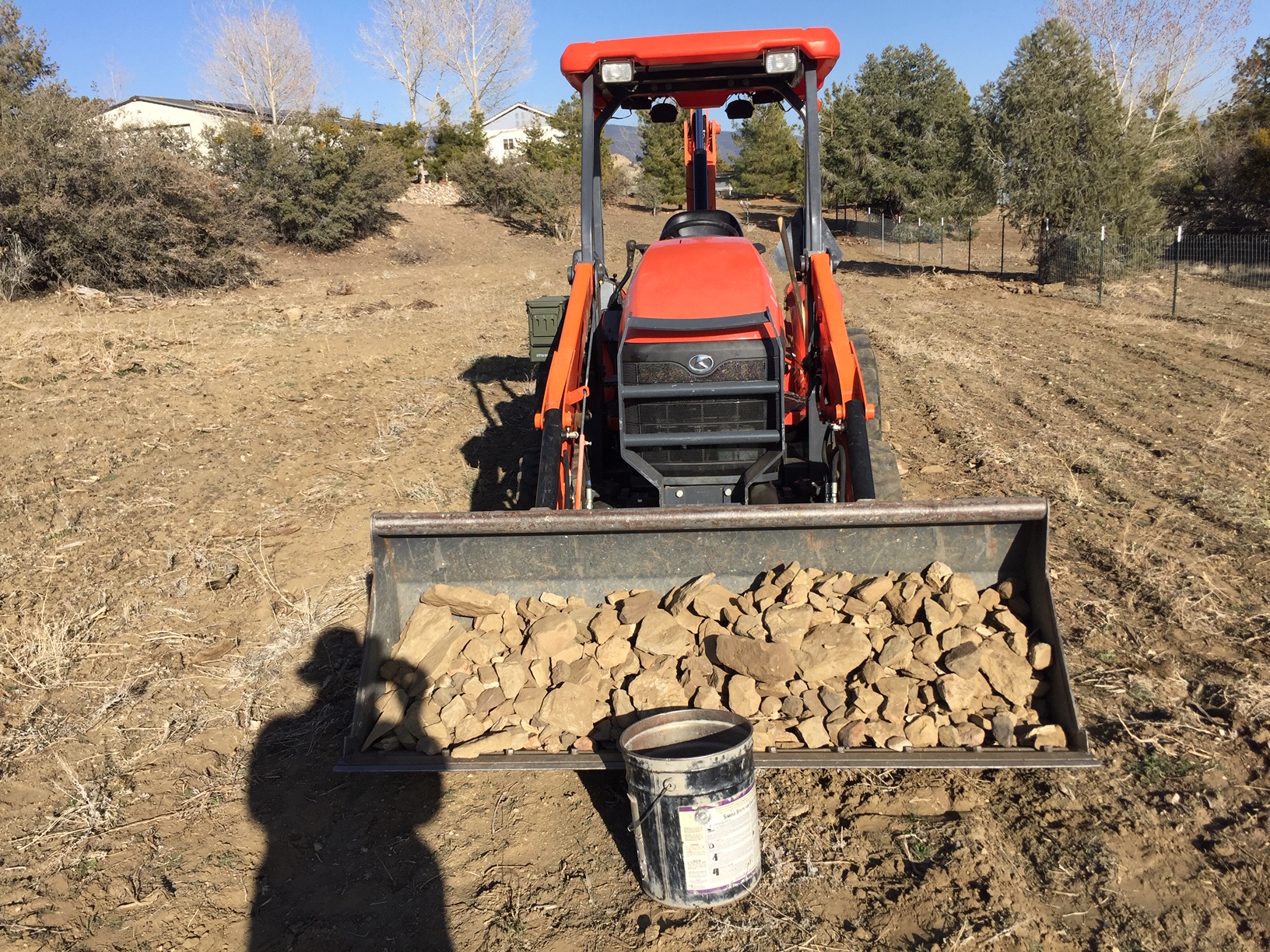

Idling, going to be picking up rocks off the property where it might sit for 5 minutes, at what point is it better for my Teir 4 tractor to just shut down and restart?

Yes, it is a regen engine, and yes, I just go and dump the rocks, I will just shut her down, it won't be long between regens if I leave her idling. Thanks guys.

Thanks all, Yes,
every time I moved took at least 20 minutes so I shut her down and yes starts very easy.
