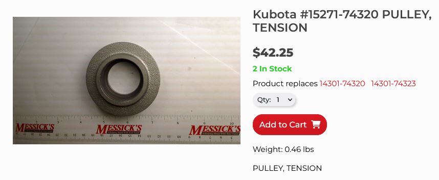

Here is the breakout of the idler pulley.....
Looks like it is sold, not as an assembly like is usually the case,
break it down and replace the bearing as stated above by
@D2Cat and @007kubotaguy.....

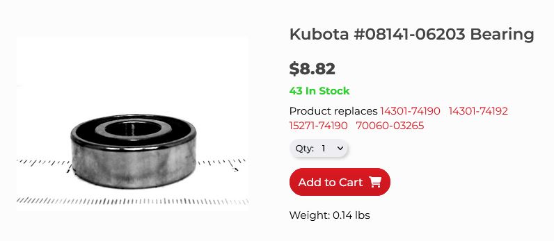

Here is the bearing part number, you should be able to cross it over at an auto parts store.....
