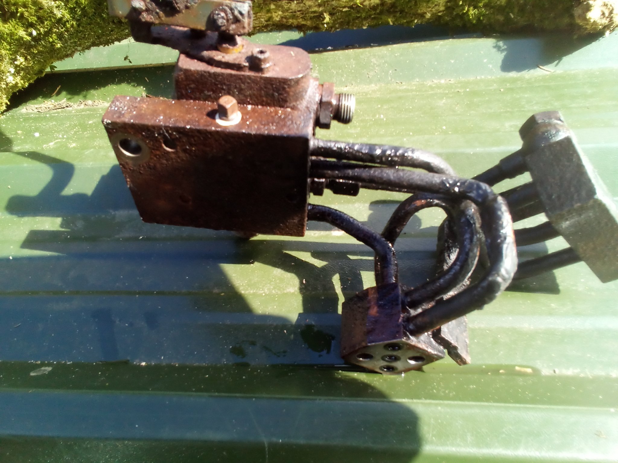

I think this is with mower deck which is no longer needed. But trying to find more info. So I can convert or replace with a different block.

That looks like a typical Kubota outlet block with auxiliary control valve. The outlet block has three o-ring ports as follows:
  1. Pump pressure out from tractor to the control valve inlet
  2. Pump pressure return from the control valve power beyond outlet (high pressure carry over in UK/Europe speak)
  3. Tank return from the control valve tank port to the sump on the tractor.
Cloning the outlet block with one that has female ports for hose connections is trivial. If you were in the US I would quote you $50 USD labor and materials.
Take the block to a local machinist and seecwhat he/she wants 🤔

Given the age of that tractor I suspect salvage is the only source for the OEM block off plate. Fabricating one should be pretty easy.
6,365
2,016
But he has to connect your #1 to your #2 with drilling in the block or an external loop of hose or tube. #3 can be blocked off. If #1 is blocked then the pump is dead headed. If #2 has no input then any downstream hydraulic system (3 point hitch) will not be operational
And your numbers are random list numbers and not any sequence number on that block.
@TheOldHokie - are these correct statements or am I not understanding your statements and number schema correctly.
I am trying to state things clearly while you sometimes assume that everyone understands the hydraulics as well as you do.
I would assume his specialist would understand that but other readers may not.
The OP wanted a hydraulic schematic for the tractor which I dont have. Instead I was telling him in simple terms what the ports on the block he is removing do - nothing else. I dont have a clue which ports are which and made no attempt to identify them. Plenty of time for more detailed discussion if/when he asks.
