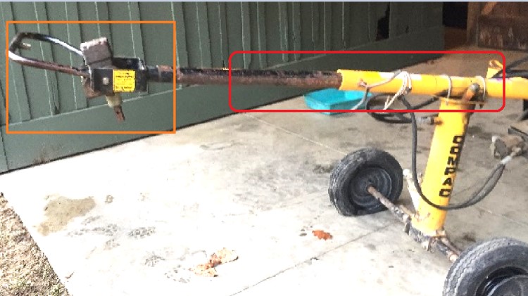

I found a towable PHD with 4 augers at an auction - Honda motor wouldn't start and bought it - the hydraulic motor operates at 6gpm, which is about what I've got on my FEL 3rd function. I'm going to cannibalize it to make a poor-person's SA-10. I'm starting out on this forum, because I'd like to get some input from PHD owners about a few things. Then I'll start a thread in the products forum as I move forward with it. Whatever's left I'll list on craigslist for the next guys project.
For owners of SA-10's, the product info says you can mount the unit on a Landpride fork frame and slide it to the left, right or center. for those of you doing that, how do you like it and how do you rate the PITA factor for removing your forks from the frame, mounting the PHD unit and then doing the reverse when you're going back to your fork configuration? Got any photos of the fork frame mounting and moving it side to side? Also, the hydraulic motor swings front to back, but there's a back-stop, so you can curl the FEL and get the auger off the ground for moving to the next hole - does that work well and does it help you line up to the drilling point?

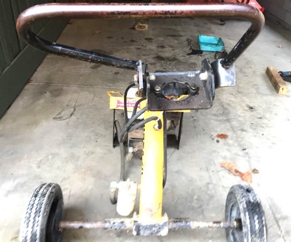

Since this is a poor-person's SA-10, I plan to re-use the existing hydraulic motor mount - just have to figure out the best way to attach it to my tractor. I've come up with 3 options: attach it to an SSQA blank plate, attach it to the fork frame or attach it to a small structure and have it slide-on to the forks. I'm leaning towards the slide-on - lower cost, I won't be setting posts in tight quarters or using an auger bigger than 12" and it would be easier for me (not getting any younger or stronger) to mount/dismount. My vision is to use 2 pieces of rectangular tubing (forks slide into these) with one or 2 pieces of the rectangular tubing (as cross pieces) and then attach the existing mounting bracket (with handle cut off) to the cross pieces. I'd chain the slide on to the fork frame and secure with a clovis hitch so it would stay snug to the frame.
Here's my questions to any PHD owner - are there situations when the tractor isn't square to the ground where it would be helpful to be able to tilt the auger to the left or right so that the hole is vertical and not angled like the tractor? The PHD I bought is on an extendable and rotatable pipe - I could either cut all of that off, or keep some (maybe a foot) to be able to do side-to-side adjustments where the tractor isn't level.
I've attached some photos - original unit, hydraulic motor after removal, mounting bracket, etc.

Definitely don't want to overthink - this will just be for fence posts on my property - 6x6 would be the biggest thing I do. With a 6gpm hydraulic motor and my B3350, if ever I was setting poles for a pole building or some serious concrete pillars, I'd rent a bobcat with auger. This project was the result of the box truck hitting the fence - I get a new toy, the truck driver gets a break from what a fence pro would charge and I'm not digging the post holes by hand.
I think I'll leave a little section of the black & yellow pipe on the bracket, so I can adjust left-right if the tractor's not square. Once built, I'll drill a hole through it and use a pin with retainer for straight vertical on level ground. If I need to adjust, I'll pull the pin, rotate as needed and us the screw handle to tighten to position.
