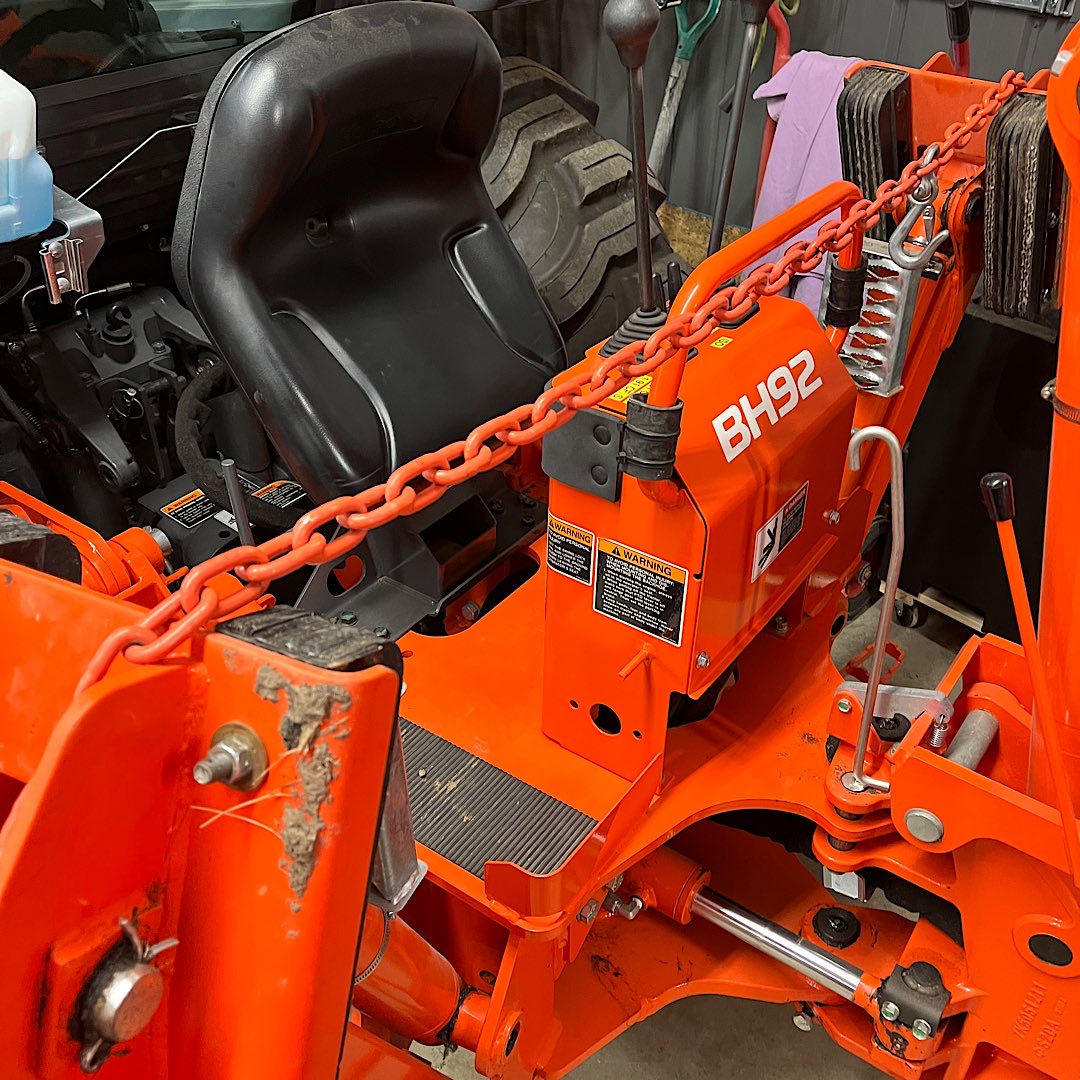

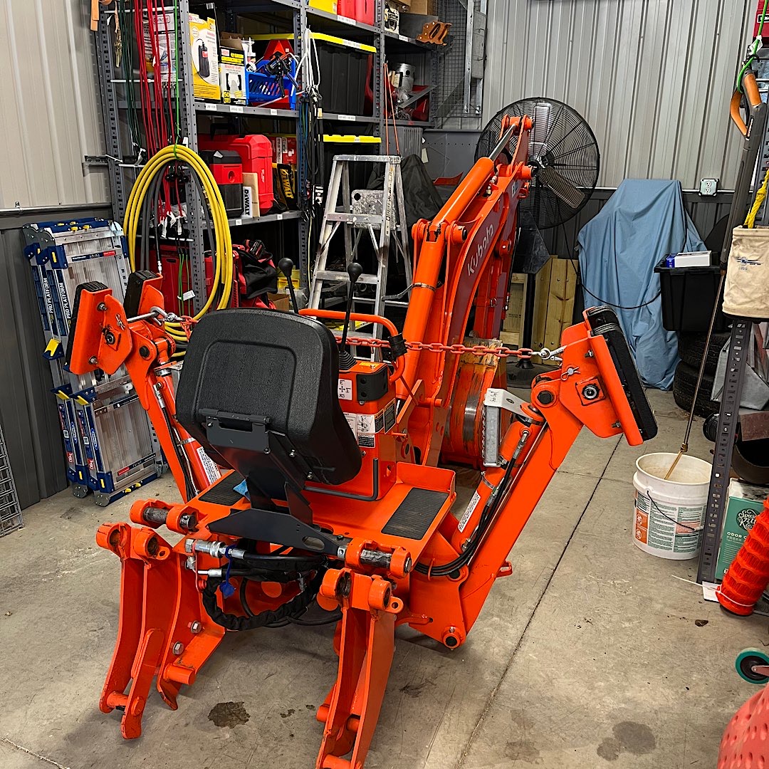

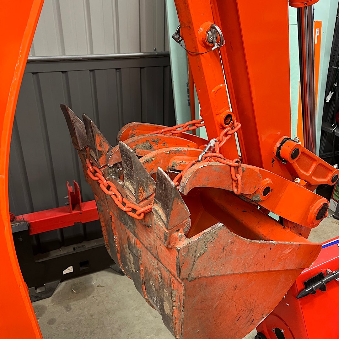

Drift drove me crazy so I chain the BH stabilizers together and the BH bucket up.
