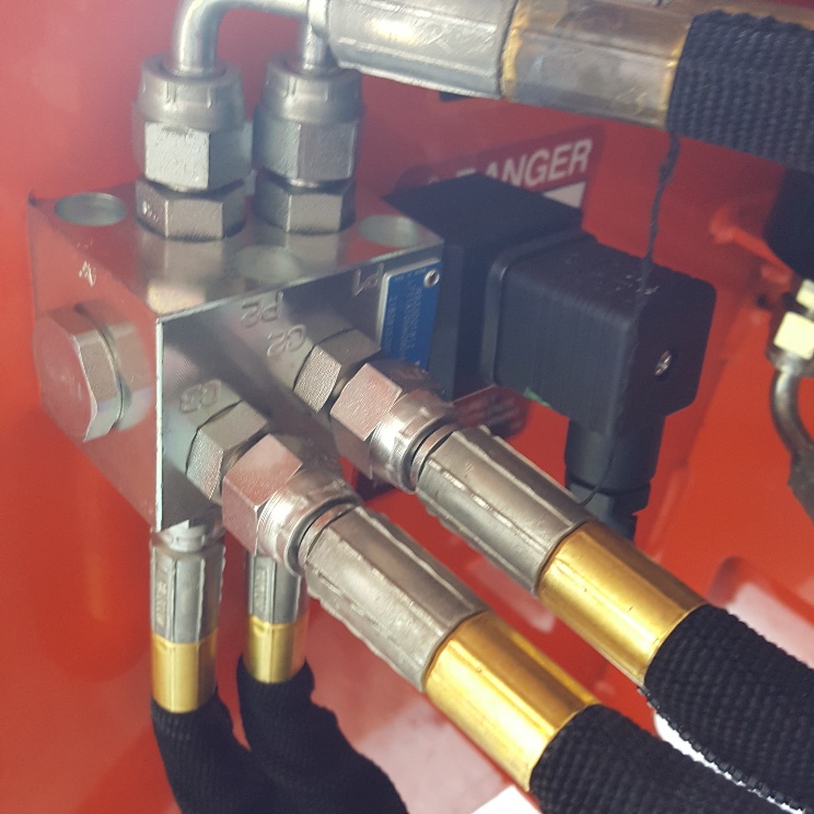

Here is the parts breakdown. The part you are describing (key number 120 - part number 70060-02677) appears to be a 3 way hydraulic diverter valve. It switches the input hydraulic control stream (2 hoses) between two double acting cylinders. This allows you to control two cylinders with one directional control valve. The toggle switch controls which cylinder is connected to the valve. Only one of the cylinders can be connected at any given time.
The parts breakdown does not include component parts for the diverter valve - I suspect it is replaced as as a unit.

it sounds like the plastic nut holds the actual solenoid 'coil' onto the 'valve assembly'. Very common designs, allows different coils(12v,24, 120v) to control the valve. The plastic nut could(should) be replaced with a metal one. A picture would help of course....probably some weird design I haven't seen. The ones I used 1,000s of, used a retaining ring or 'snap ring' or 'C-clip'. made for QUICK exchanges at 2 in the morning.

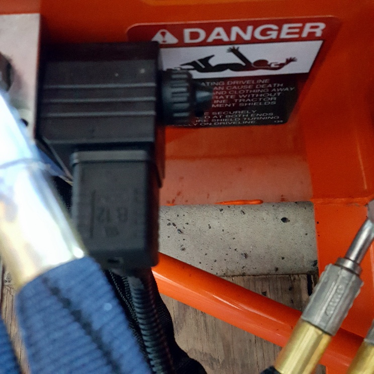

Dan, you are close, but mine is a bit different..
You can see where the tape is wrapped on the right hand side of the knurled plastic thing. I'm starting to think that whatever nut was on there must have fallen off.

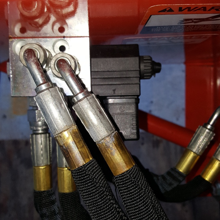

Thats one of the two solenoids. The nut/knob are what holds it to the spool inside the valve body. The knob may be a manual actuation feature. Hopefully the service guy can scrounge the parts needed to fix it. A picture of the good one on the other end would be informative.
