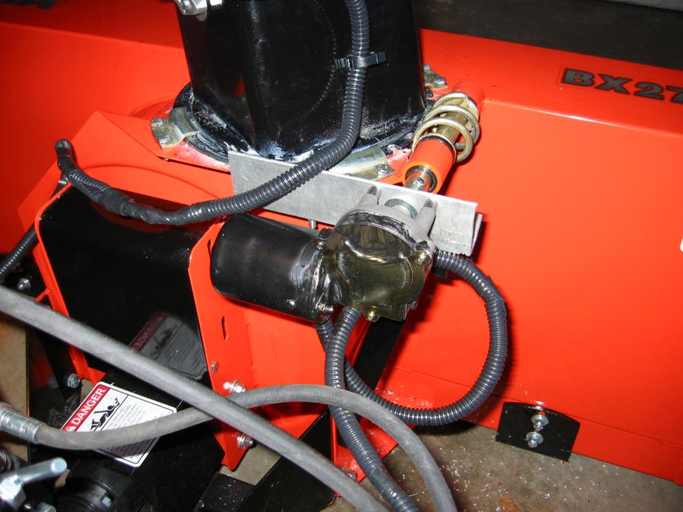

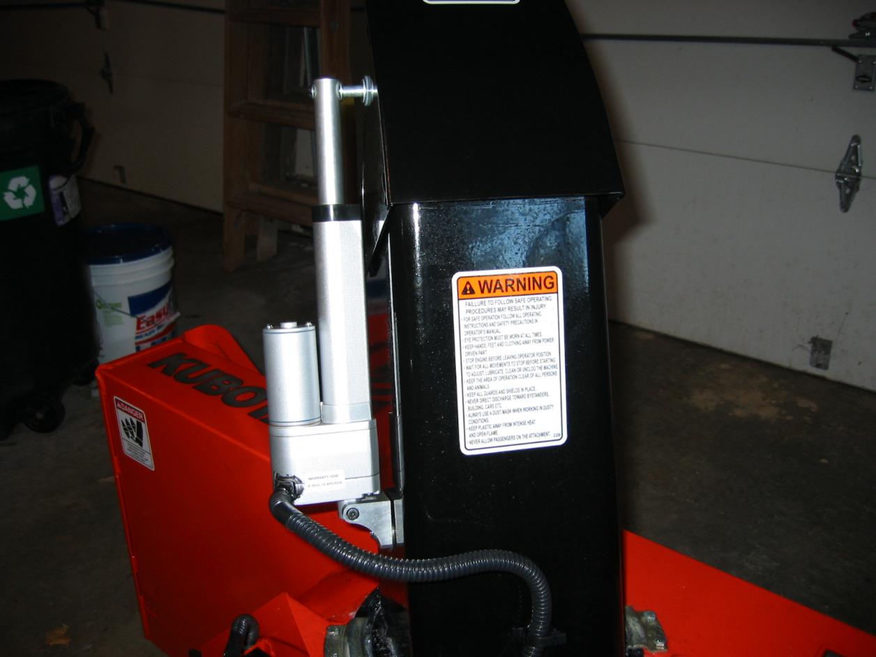

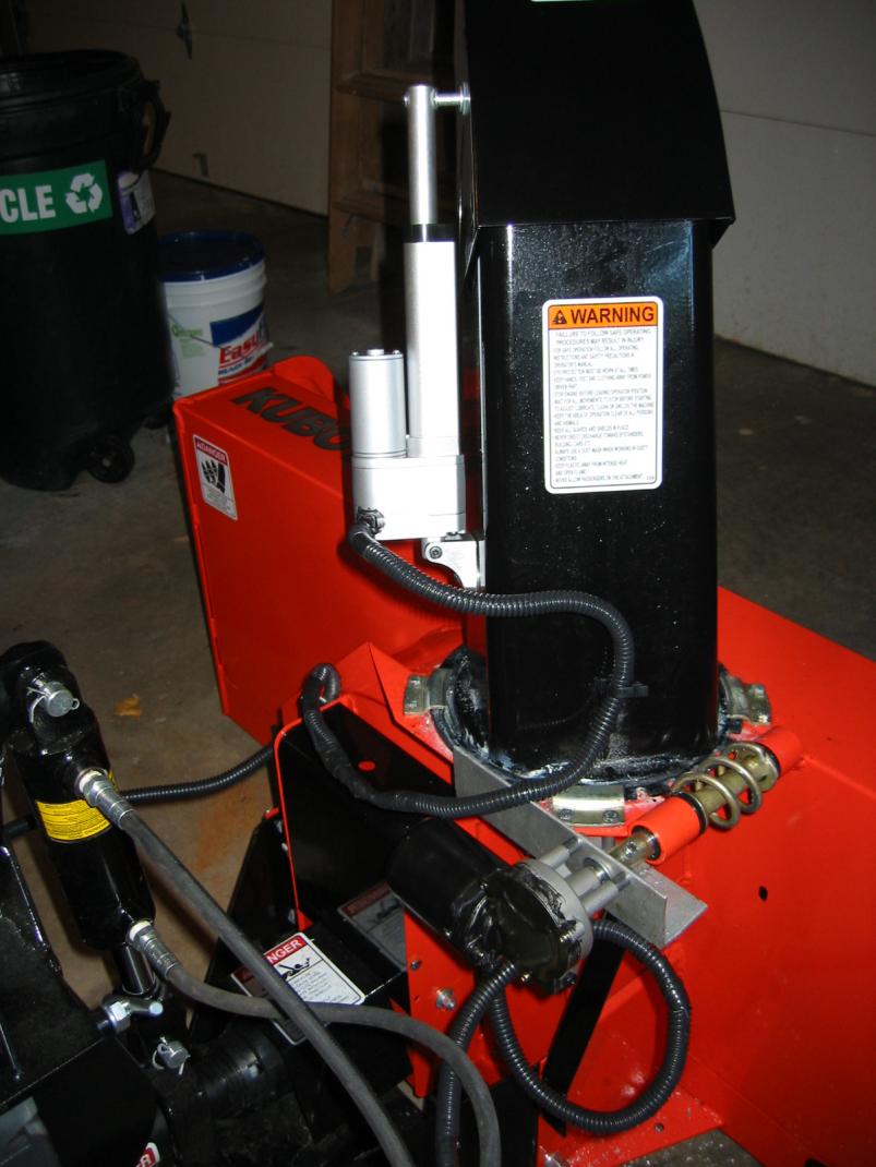

Here is how a fellow did with an actuator. Looks good, but I wonder how it will hold up in the cold, ice and moisture.
That picture is of my actuator I installed.I did get to try it out during the past storm we had here in MA. and it didn't freeze up or stop.I sprayed everything down with silicon spray before the storm,so I think that helped a lot. I also used liquid electrical tape to brush on and seal anything I thought might let water in.It turns to a rubber and helps seal things.

Nice job. I'm thinking of trying that out. Would mounting it upside down help with preventing moisture entering the actuator? Does the bracket only have one bolt in it so it pivots?

yes,I only put one nut and bolt on the bracket.I figured I'd try it out the way I have it and if for some reason water does get in,I'll try it upside down.It seemed to work good on the last storm.

I bought the actuator for the deflector from surpluscenter.com.The actuator part # is 5-1577-4. the bracket is part# 5-1577-B and I also ordered 2 DPDT open center momentary 20amp toggle switches. I found the rotator motor on Ebay, I searched 12 volt DC motors and found a 50 rpm gear motor for $59 I used some aluminum pieces I found around the garage for a mounting base.

I used an old power window motor with a DPDT switch to run it. Works wonderfully and cheap! and no extra hydraulic lines to mess with.
