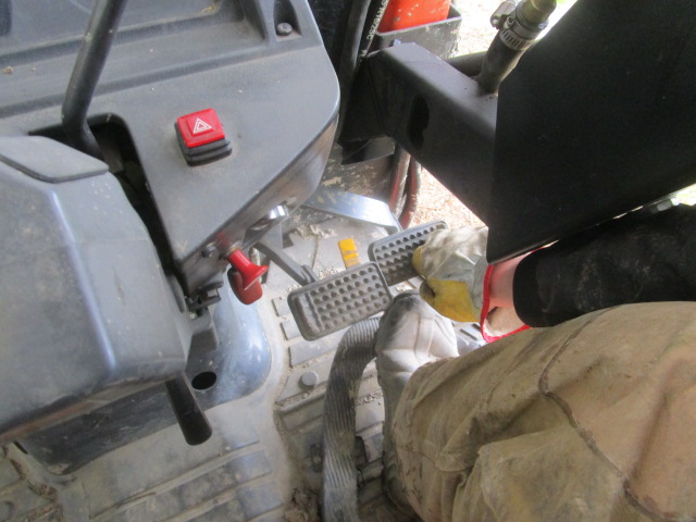

Was up at camp doing some long needed driveway ditch work.
Had the left wheels off the gravel into the swale / ditch along the driveway, bucket in float, trying to scrape the mud off the the side of the drive.
As i was going up the driveway, it was getting softer and I had to turn out of the swale / ditch onto the harder gravel,
Wheels turned to the right, to try to climb out, the L3710 kept going straight.
I had to reach down and hit the right brake pedal to help the tractor twist out of there.
Any HST guys have any tips on footwork to keep forward motion but still tap the brakes to make a tight turn..?

Do this at your own peril. A lot of the older hydrostatic drive tractors had a clutch pedal and a motion lock. I just set the lock to what ever speed and use the cut brakes how I want. If I need to stop thats what the clutch pedal is for, or in my case tap both brakes to release the hydro. Gotta remember the first hydro drives had a lever for speed control so it wasn't an issue to use the cut brakes and clutch pedal. Mostly thinking of the old international tractors. A 656 comes to mind immediately. Thinking about it we basically treated it like a gear tractor when in the field. Any way. More then one way to skin a cat.

My brakes are on the other side of my HST pedal. If I remember correctly, I believe Kubota's new models are starting to come out with this in the L series tractors as they phase out the clutch.
Trying to play Twister on the tractor doesn't look like much fun.

I just bend over and use my hand on the split brakes.

Yes I think the newer B and L models lack a clutch and the brakes are on the left side of the dash.

Yep, brakes are on the left side, and mine are linked. I've never had to brake steer so I've never removed the link, it acts like a single brake pedal as is. Pretty handy for most things, and I'm glad it has the ability to split the pedals if needed.

Recently learned how to use the split brake when back-dragging gravel on the driveway. When I was applying downward pressure with the bucket it was enough to lift my front wheels to the point where I lost steering. The rear end would inevitably start to drift downslope, away from the crown. Didn't take long before I got the hang of it, and yes the footwork it is awkward. It's a little easier if you move the seat forward, otherwise you end up in a plank-like position grabbing the steering wheel like a life preserver and hoping no one's watching.

Many years ago I worked on a farm that had recently had a serious injury due to a split brake incident. Tractor operator had his son riding on the rear fender while in high gear running down a road. He had to make a sudden stop, and when he went for the brakes he had neglected to lock them together when he came out of the field. Well, when he slammed the brakes, he only got one side and the tractor flipped. His son who had been riding on the fender lost his arm (tractor landed on it). Fortunately, he wasn't killed.
I doubt that you were going anywhere near that same speed in your situation, but jamming on one brake can still flip a tractor easily in the right scenario.

Nothing like that but it happens from time to time. Can say on at least 3 occasions I've forgotten to lock the brakes together and had to stop in a hurry fortunately nothing hurt but ny pride. Twice was in the 310sj backhoe amd the third was in a t4.75. I try to be mindful of it and remember to lock them together before I get on the road.

Slightly off-topic,but our B3030 cab has the brakes on the right and no clutch pedal.
Sure is easy on/off.
Don't really miss the turning brakes.
