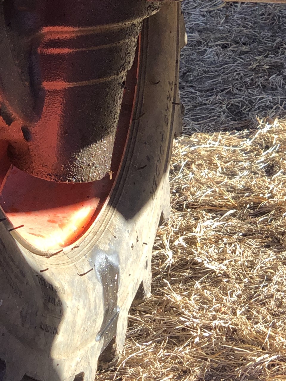

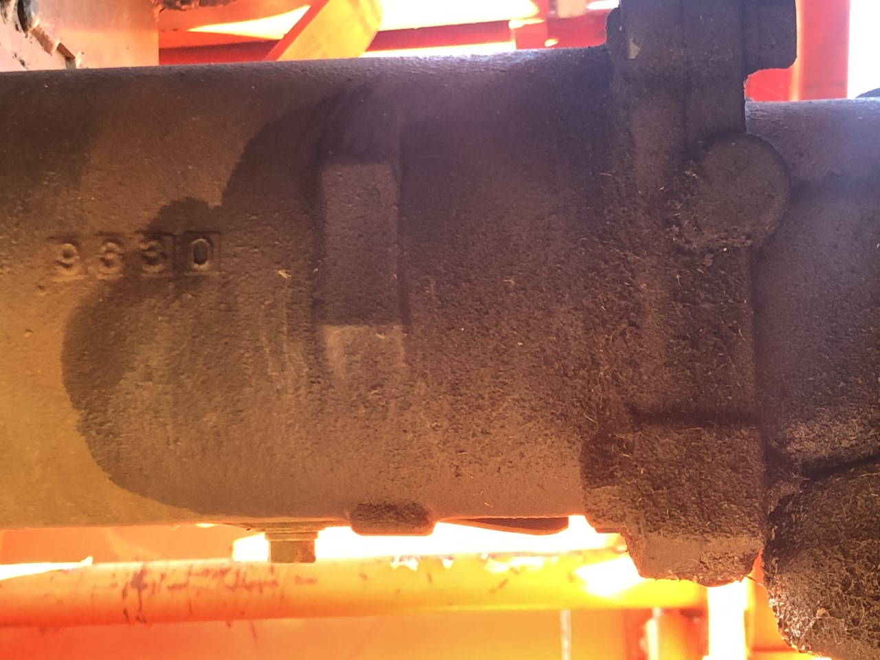

I have a problem with a leak on the front axle (4WD--photos below) that I have decided after watching a lot of YT videos I just do not feel comfortable doing by myself--as in no help lifting, holding in place while I try to seat snap rings, etc. Looks like could be a real task... Anyway dealer says it will cost me $480 for them to do it including changing the O-Ring on the axle and both seals, which seems reasonable.

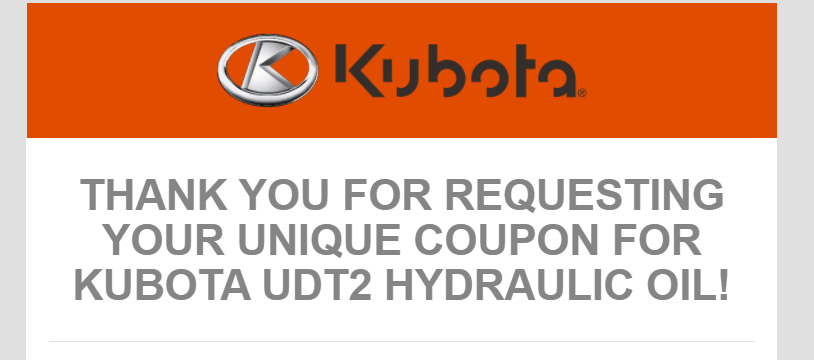

This coupon takes a few days to get via email.
5,703
3,029
I keep filling out the form.....and Kubota keeps replying ”Invalid information. Unable to match customer record.” Three times now.... I give up.

Can you get a coupon per tractor?
I need to check the fine print I submitted for each of my botas but only received confirmation for one.

i filled out my coupon . Had to google it. Coupon is for UDT,plainly stated on coupon. If I am wrong ,someone please correct me. Has anyone used the coupon yet ? Close to 400 hrs on tractor time for HST fluid change. Will use coupon for whatever oil I can get. Would prefer the SUDT2 , but will use coupon for whatever I can get. Good luck on all your projects
Shows as UDT2 on my email. Pretty sure that is Super UDT2
