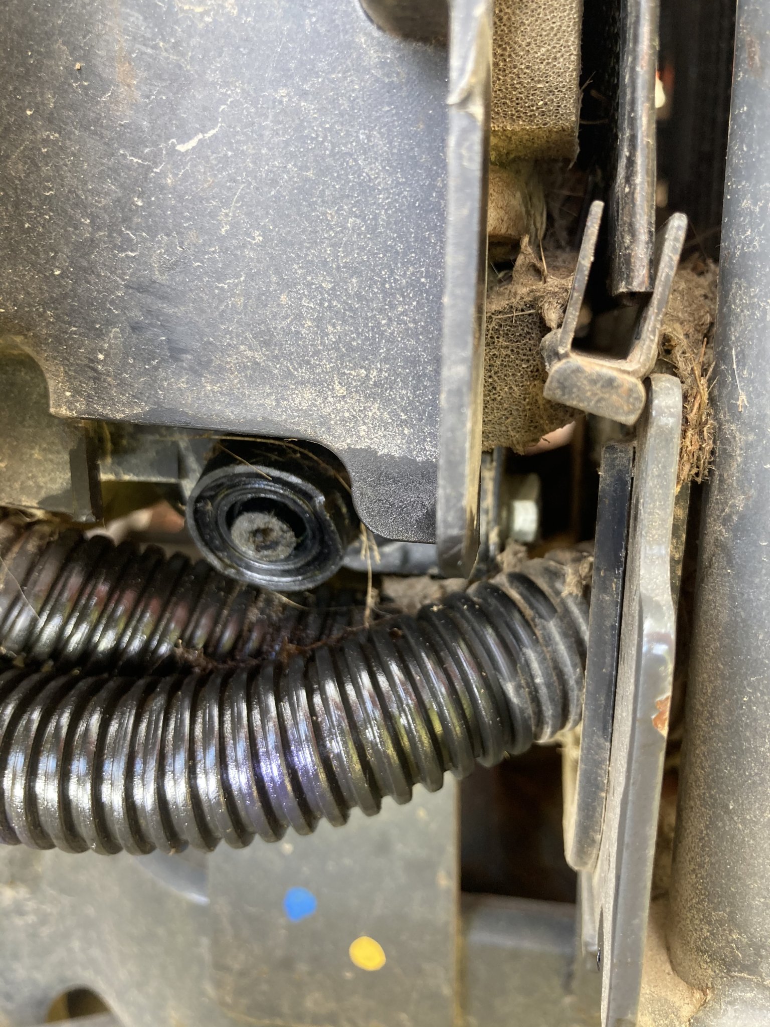

In trying to change the coolant, the plastic drain plug at the bottom of the radiator broke off almost flush. What’s the easiest way to extract the broken off threaded plastic male part without messing up the threads on the female part attached to the radiator? Thanks!

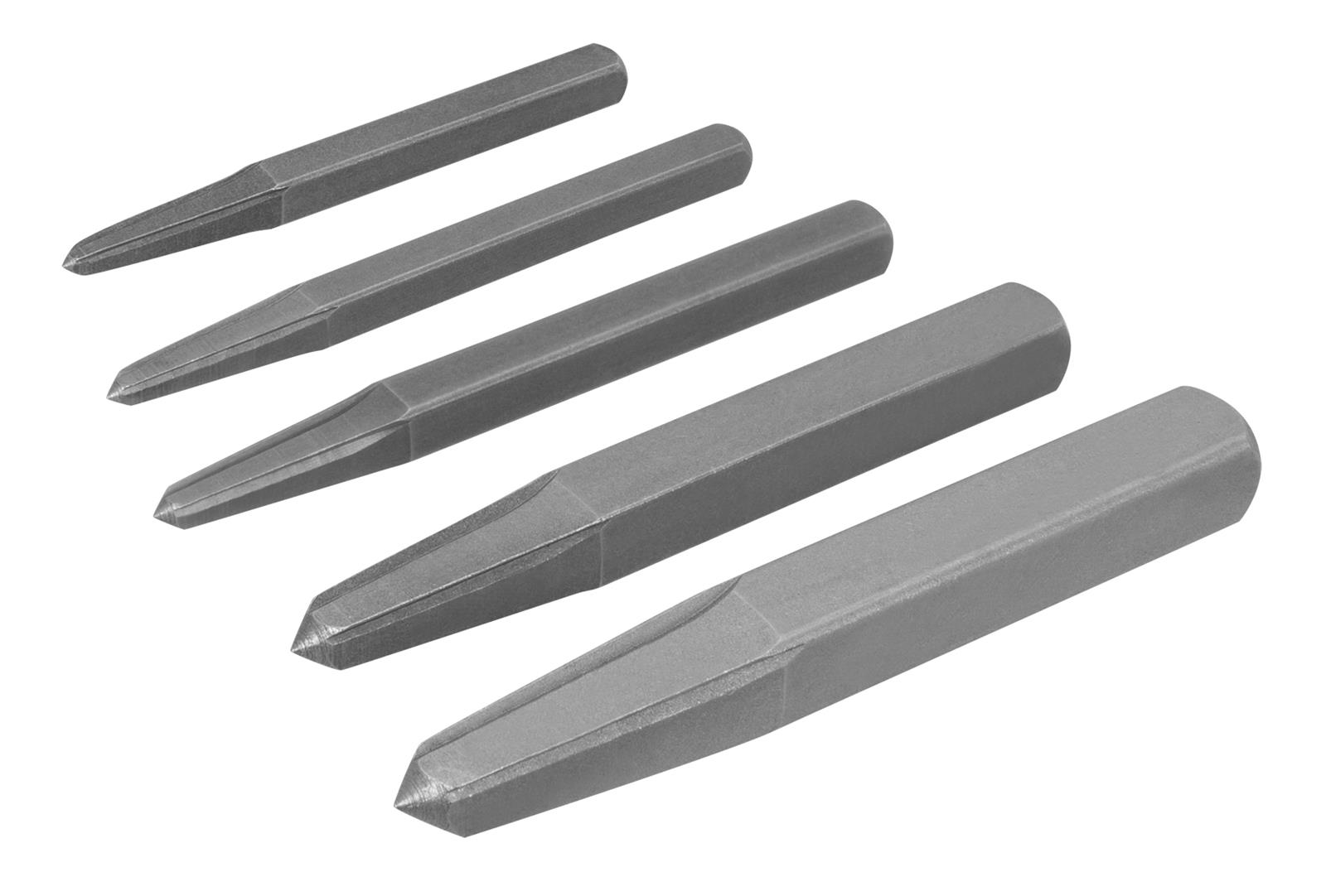

A straight fluted extractor works very well in plastic. A spiral extractor just screws in further as you turn it expanding the broken sleeve tighter.

A straight fluted extractor works very well in plastic. A spiral extractor just screws in further as you turn it expanding the broken sleeve tighter. View attachment 48315
This looks like the answer thanks!

Can anyone weigh in as to whether the threaded piece on the radiator is plastic as well? I can’t tell from the parts diagram and it looks like if I screw that up it will need a new radiator?
It is a plastic plug screwed into a plastic radiator tank. I have extracted several for customers that have broken or twisted of there plug. I always have used a tapered fluted extractor, never ran into one I could not remove.
I drill with a small bit, insert the extractor and turn using a 3/8" brake over bar and socket so I can push the extractor in with hand pressure. Use moderate steady pressure to slowly unscrew the plug. You may have to pull on the bar, hold pressure, slowly increase the pressure a couple of times but it will unscrew.
