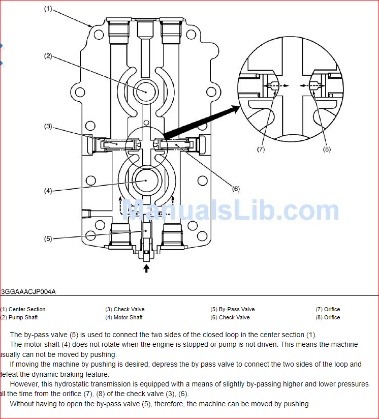

If one needed to push or pull these tractors how does one "disengage" the HST to allow this? On my other machines HST equipped there was always some type of "release" lever to allow freewheel.

this will help you with one problem

Re, the bypass valve. I did read about it but try as I might I can't find it. I'll have to look again. I am sure it's hiding in plain sight but I can't seem to locate it

G2160 is a lawn mower. They didn't see it feasible to separate the brake, or to put a diff lock on it. It's a lawn mower.
It doesn't have a manual bypass valve. Just take the brake off and move it manually, albeit slowly. The harder/faster you push, the harder it pushes against you. Try it and you'll see what I mean.

Yeah, I have been able to push it VERY slowly and VERY little. But it's quite difficult compared to how the little Honda or the Simplicity worked when disengaged. Which is what prompted the ask about a release valve on it.
