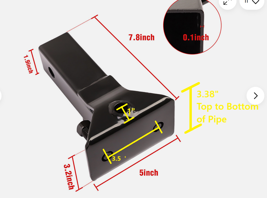

That plow was madee for a much smaller garden tractor with a sleeve hitch like the pic below.
You'll have to make your own hitch if you want to use it.

Here are some more dimensions if you want to make your own.

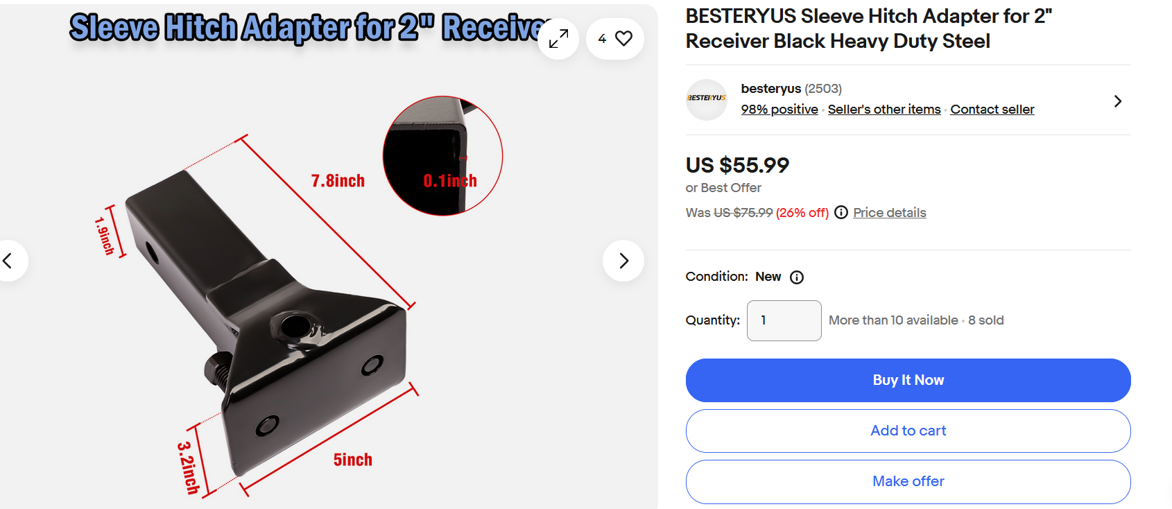

Or buy
Plus
Ebay
Thanks for posting this! I have that same plow I bought new back in the 90's. I used it recently on a garden tractor to bury a air line across the lawn for the pond aerator. Hard to get good traction with that and I was trying to think of a way to make a hitch for using it on the L2501.
I made a small 3pt counterweight with a receiver on it and this will be a good method. My T&T should give me good adjust-ability with it
Thanks again, and also to Tractor J for bringing the topic up.
