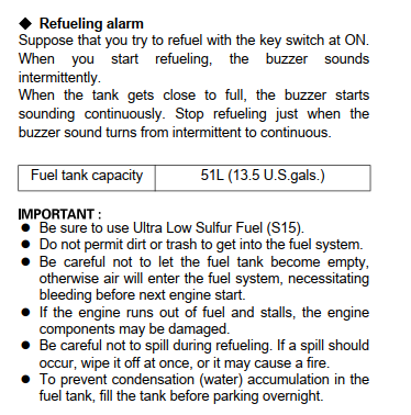

Just listen for the refueling alarm if your tractor has one.
